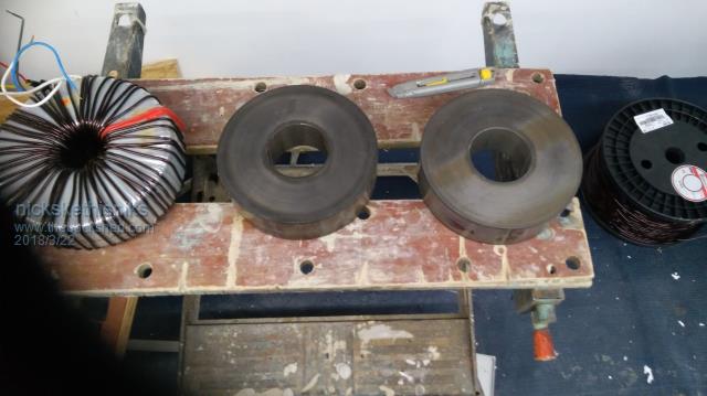

In the meantime I received the ozboards and I did solder a few components, there are some things that needs to be ordered first.
  Madness said   I would try a sample of that 3.55 wire before you commit to it, you have to do a lot of turns for the secondary and 4 times as many corners.
I did a sample and I found the 3.55 wire rather soft/bendable. On the left the transformer has now +/- 356 secondary turns, and 52 primary turns ( needs fine tuning during testing). The primary will be good for 40A. It will have low idle current, we will see how that turns out, at least I have a testing transformer. @ the right you can see the 42kg of 3,55 wire, don't ask... .
As you can see the 2 transformers are stripped, I just need to make the centerhole wider before I epoxy them together.
I need to figure out how to cut the centerhole, suggestions?

If those core are wound Silicon Steel strip all you need do is unwind enough turns to increase the hole size as required.

If you look closely in the centre you will see the end of the coil is spot welded, normally just one spot weld, I have seen 2 spot welds sometimes. Or with the Chinese cores I have seen just some strong tape.
Just use a sharp blade to prise open the first winding in the centre a bit, then use a screw driver to force the spot welding apart.
When you have the correct internal diameter for the centre hole, just make sure you have no sharp edges, and just use tape to keep the end in position.

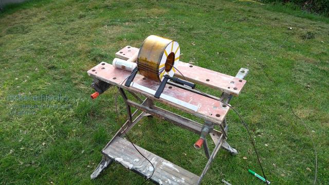

Had some time to do the epoxy thing to join the 2 cores.
What I need to do now ( says the "manual") is the wrapping with mylar, I'm not looking forward to it. So I will skip this part, what I will do next is put on an extra coating with expoxy instead. Mine Is rated to 130°C(after a few hours in the oven) so I see no problems there and it will save me some time. Next time I will post pictures.
Madness
Joined: 08/10/2011
Posts: 2498
Posted: 08:59pm 18 Apr 2018
Wrapping with Mylar is not difficult, I used an empty solder spool and wound the Mylar on it with a drill. Probably takes about 15 minutes to wind it on.

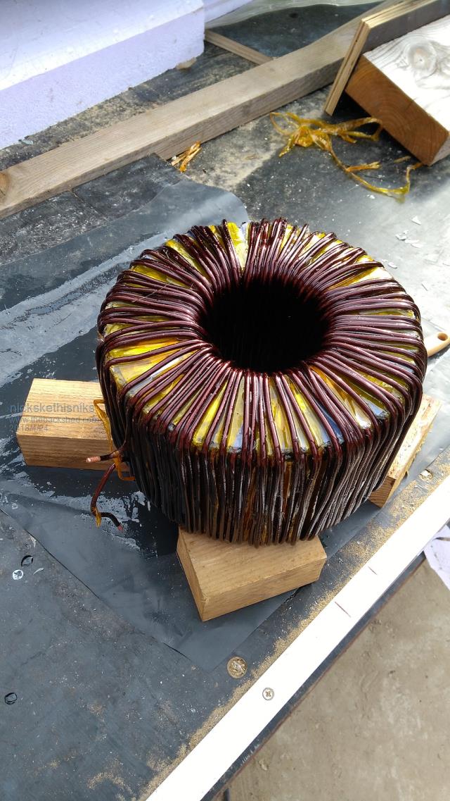

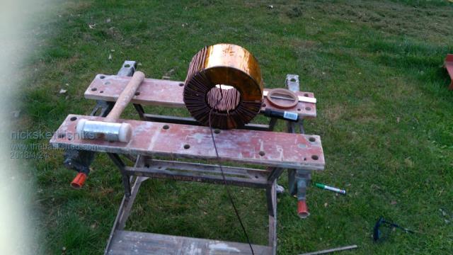

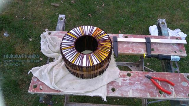

Hi there,
Getting closer to testing each week now :).
Still waiting on the adapter boards for the heart of my inverter, the chinese folks canceled my order.... So once they arrive I'm ready for testing.
So the plan was to aim for 130 secondary windings, but ended up with about 150 turns, spread in 2 layers. The second layer had more turns because my wire was to long, I just kept winding.
The first layer of turns was ok, I made neat turns, next time I will do the job better but it was fine. The second layer was more difficult because there was no plane surface anymore so the wires did not what I wanted, but I can live with the result. So far no short circuits.
The core had an epoxy layer on the outside I reinforced it with glassfibre. Then there is some electrical tape on the edges and wraped in capton tape. Next time I'll put more or thicker electrical tape on the edges. Or like sugested, using the mylar tape wich is much stronger!
Finished the first layer. It took me about 1.5-2 hours.
Finished the secondary, the second layer took me about 3hours to complete...
Last photo you can see the transformer had a thick epoxy layer, ready for the primary, maybe I add a layer of capton tape. Stil wondering wich wire to use for the primary, I still got a lot of the Original wire.

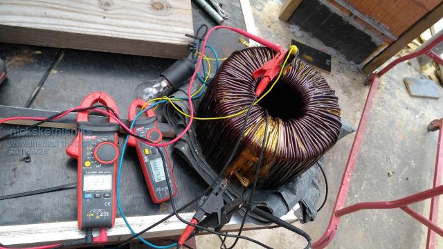

Testing results:
225V 0.046A 10W (1.484V /turn primary)
235V 0.048A 11.5W
So it was better then I hoped, after 63turns I had 0.136A @ 118.4V, so imagine that @ 230V!
Only downside is that I need more primary turns... I've got an opening of 75-80mm left for the primary so I hope this will be enough.
I hope it is ok to post the amount of photo's.Edited by nickskethisniks 2018-04-25

I am not sure if I am reading this right but if the 2 windings you have put on are both to be your secondary and connected in parallel they must be exactly the same number of turns.
Plenty of photos is good.Edited by Madness 2018-04-25

  Madness said   I am not sure if I am reading this right but if the 2 windings you have put on are both to be your secondary and connected in parallel they must be exactly the same number of turns.
I forgot to mention I use the windings in series, I use new 3.55mm (9.9mm²) wire so no need to parallel them.
