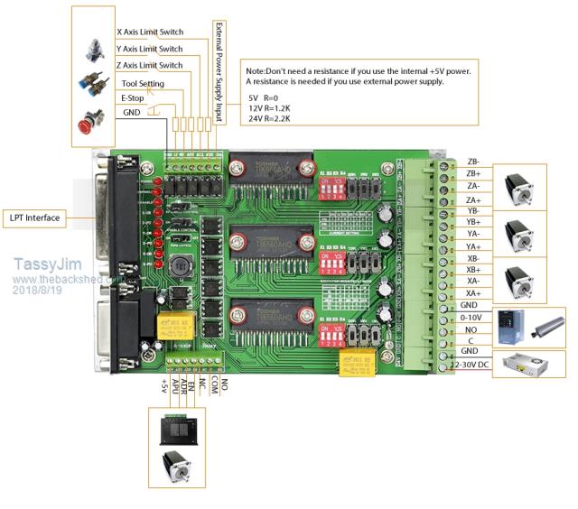

A very useful addition to the 'Mite! As tricky as Steppers can get, many basic installs & educational projects would benefit from this addition. And something can be up & running fairly simply. Somehow include a warning that it won't necessarily work, due to the physics of the resulting rig - - - a disclaimer clause is recommended :)
Would suggest basing the concept on the Toshiba based Stepper "Driver Amps", all available on eBay from numerous suppliers. Their interface is opto-based (viz. EMC & isolation) and seems very standard. Search on eBay with keyword "TB6600". The 4 Amp ones are about $10 & the 5 Amp one (better) is about $16 (typical part # = HY-DIV268N-5A).
The reason I mention them is that these Toshiba-based Amps are switched in a particular way which dictates how to arrange for the 'Mite to drive them, from firmware. These are PWM based, however, they take an approx., fixed 50 uSec pulse combined with a certain time interval - doesn't matter exactly when so this can make the firmware easier to setup. The closer these fixed pulses are together the faster the motor goes = simple.

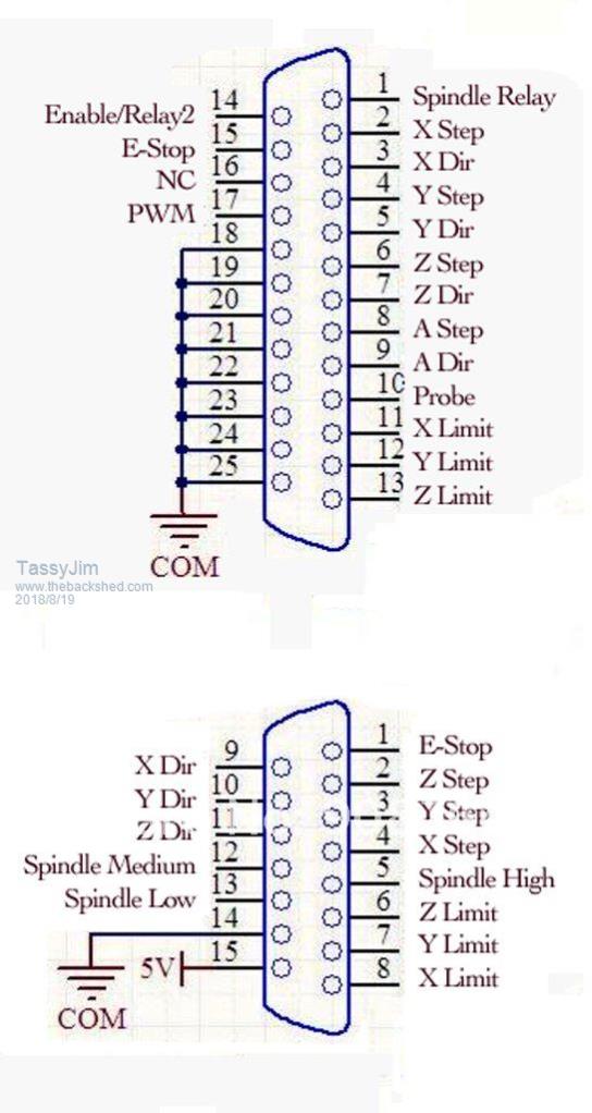

These boards are cheap and readily available. They use the TB6560 chip.
Driving one with the micromite would make a great base for robotics experiments.

Jim :
The boards that you show use the chipset thats in the Toshiba family I mentioned in my earlier post - I like the board u posted because it has 3 circuits - useful !
(X, Y & Z axes).
