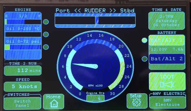

I have a need for a large display so after some research, I purchased a 9" TFT LCD panel from BuyDisplay.com. It is based on an SSD1963 controller and has an XPT2046 touch controller.
Using OPTION LCDPANEL_7A, it all works after working out the wiring differences on the plug between a real 7" and the 9". Display is clear, no tearing and is centred and touch works fine.
The only problem is the colours - green comes out as blue, red comes out as a greenish yellow, grey comes out almost white, white comes out as pale cyan and so on.
The display is completely stable and looks great except for the colours.
I tried LCDPANEL_7 and again, while the display was fully stable, the colours were off but in a different way.
Any suggestions greatly appreciated.
panky.

Yes, I do understand the current limit of 8", however checking the specs of the 7", 8" and 9" panels, they all are 800 x 480, all use the SSD1963 and XPT2046.
Looking at the example code for use with Arduino, they all appear to have very similar setups with some minor variations on timing which I assume is just related to physical size. The only major difference is the pinout but I have that worked out and flying leads across to an Explore 100.
So I took the chance to have a play around and try to get it to work
The fact that the display is completely stable with complex text and GUI elements displayed would indicate that in genereral, it is 99% compatible - the only issue is colour and in fact it is red that is missing although I do get some white (ish) elements displayed. I have tried varying combos of colour using the CLS command but most turn out to blue through green. Could be timing related to passing colour info?
Screenshot is as shown below
Ignore the striations - they are an artifact introduced by the camera. All colours, while wrong in colour are solid blocks and bright and clear. The needle in the circular gauge should be gray but comes up as off white with a blue tinge. The blue in the centre of the gauge should be darkish gray as should the background on the engine frame and so on and so forth.
panky.

Looks to me like red is not displaying at all.
Faulty panel?

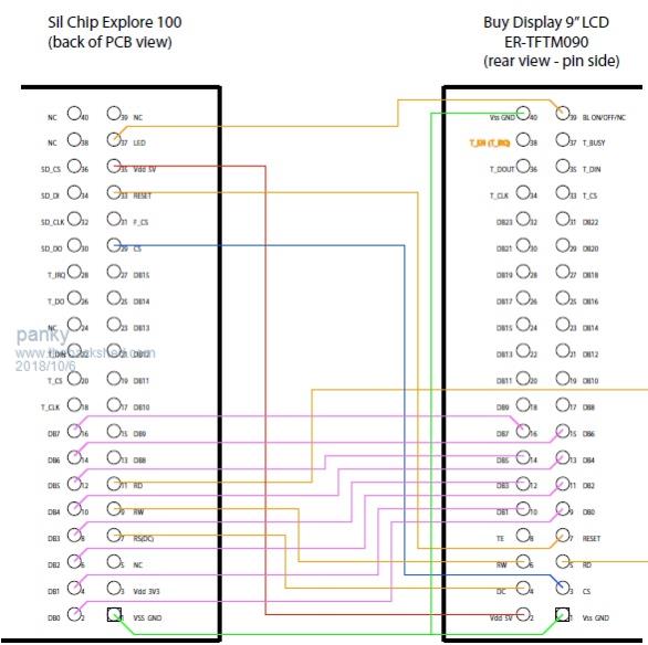

panky
Joined: 02/10/2012
Posts: 1134
Posted: 05:16am 06 Oct 2018
Bingo Jim you're a wizard!
I thought I had tried that earlier but obviously not.
I can report that the 9" TFT LCD from BuyDisplay.com part number
ER-TFTM090 v10
9"-800xRGBx480 Dots TFT LCD Module with SSD1963 and Touch Controller XPT2046
works straight out of the box using
OPTION LCDPANEL SSD1963_8,l,48,6
(the last two numbers are for my Explore 100 that I am driving it with).
Diagram of the pinout as below

panky
Joined: 02/10/2012
Posts: 1134
Posted: 06:09am 06 Oct 2018
8080 and 5V. Am running the whole thing off 5V that is feeding the Explore 100. Full brightness on the LCD plus the Explore 100 pulls 580mA.
The unit can operate as 8080 or 6800 and 5V or 3V3 with both cases settable by jumpers. Default shipping is 8080 and 5V.
The unit I ordered initially was the 10" but the controller was different so I emailed BuyDisplay.com and said what I needed was a 9" with SSD1963 and XPT2046 resistive - I didn't ask for the pin header or any font chips but as I had over ordered (and paid for the 10") they threw in the pin header and the touch chip.
The BuyDisplay.com folks were extremely helpful and responsive and although it cost extra, they shipped Fedex and it took just 10 days from start to finnish.
Good experience all around. I am now working on an adaptor board that will connect to the 7" header and re-map to a header for the 9". Have not had a chance to test on MMX or ARMMite platforms yet but hope to get to that over the next few weeks.

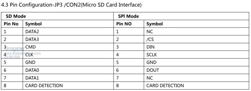

Forgot to add, SD card on the LCD is a 4 bit paralled and I understand this is not supported so if you need an SD card and want to use this unit, you will need one on the main PCB like Grogsters 1D Explore 100 board.
panky.
Posts: 11881
Posted: 07:26am 06 Oct 2018
  Quote  SD card on the LCD is a 4 bit paralled and I understand this is not supported
You should still be able to use it in SPI mode
D0 = MISO
CMD = MOSI
CLK = CLK
D3 = CS
D2 = N/C
D1 = N/C
CD = CD if wired

EDIT:
@ panky: From 9" PDF manual for this display, page 10, section 4.3:
