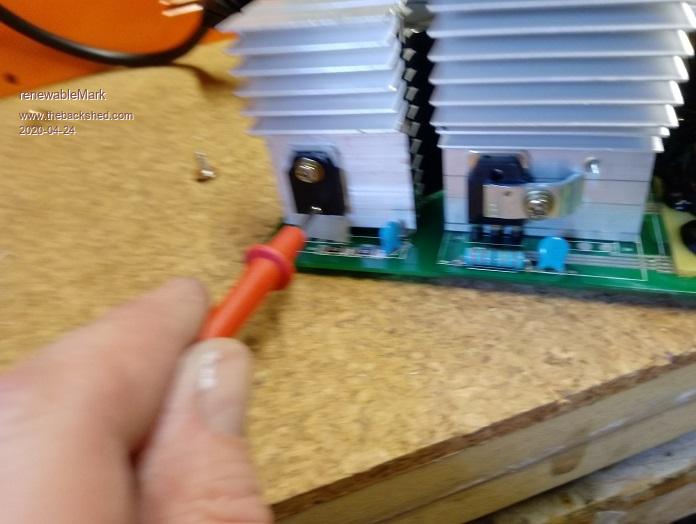

This is the one
The specs say 72v open circuit, but it's actually 62v.
Anyway I hooked it up as is to the battery and it feeds in 1.9 Amps.
So more turns are required.

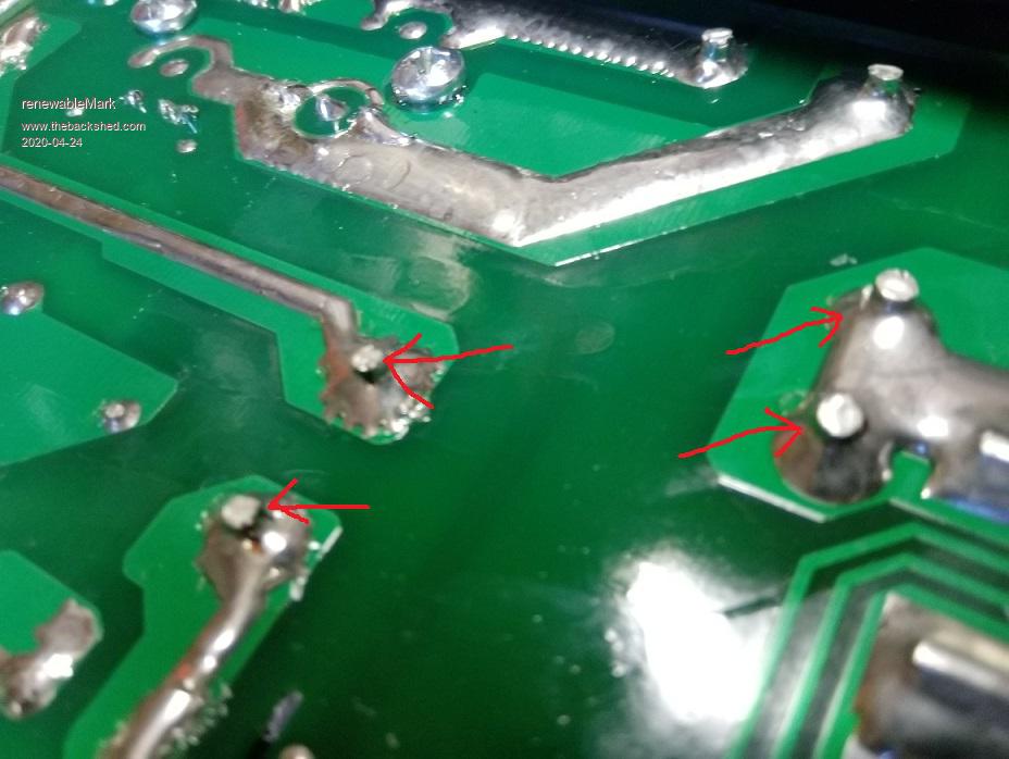

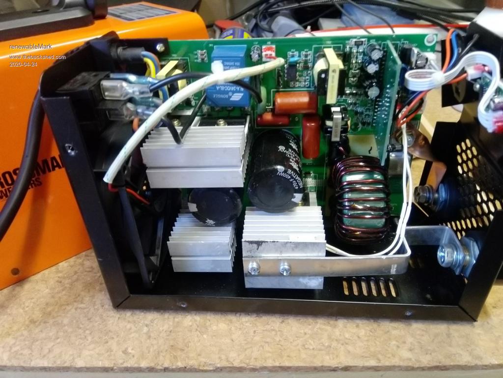

Opened it up and it looks like this.
The coil looks to have two windings on it, one common that goes to the negative lead on the output.
The other ends go to a small transformer about the size of a dice, and the other end goes to the drain of one of the IGBT's
So is the idea to add windings on both?

Hi Mark. First time I've ever seen inside something like that, the "coil" I think is actually a transformer. It looks like it could have 3 windings.
I think you should employ Poida or Warps skills to modify the first unit unless Noneya has that exact unit and can assist you.  If it has 3 windings at least one will probably be the HV power drive (~ 350VDC), the other 2 could be a full wave rectifier for the output.
You are probably correct to add 2 turns to 2 windings, but the winding going to the IGBT drain/collector may not be the right one to touch. Tread warily & good luck!
If there are 2 tracks from windings going to devices on the larger heatsink with the strap on the topside going to the other output terminal they would probably be the windings to add turns to - I cant tell from the pictures.

Posted: 10:00am 24 Apr 2020
I really cannot help here, as I no nothing about these types of welder. I would need to actually have one in front of me so I could try to figure out what it all does, and then try a few things.
It may not need to have any of the main windings physically changed, perhaps just the feedback or the system that controls the output voltage. It depends how far short the voltage is.
Definitely has possibilities though, but it might also be fairly easy to kill it if you did the wrong thing.

Oh come on Tony wheres your sense of adveture lol.  I looked again at the PCB pictures its just an overgrown PC Power supply with a half bridge drive ?  The two red arrows pointing to the left are actually the drive winding I reckon, the two thick wires you can just see at the top side of the same picture I reckon are the other ends of the common (high current output) winding. I believe there is no voltage feedback only current feedback from the shunt so you need to add sufficient turns until the current limit is working and that it pushes reasonable current as the Batt voltage climb to full.
A mans gotta know his limitations .........
Edited 2020-04-24 20:12 by wiseguy
Cheers Mike
Posted: 10:17am 24 Apr 2020
You could be right Mike, as there is only a single knob that controls current.
There may be more to this though.
That winding on the toroid does not look like capable of 200 amps to me.
