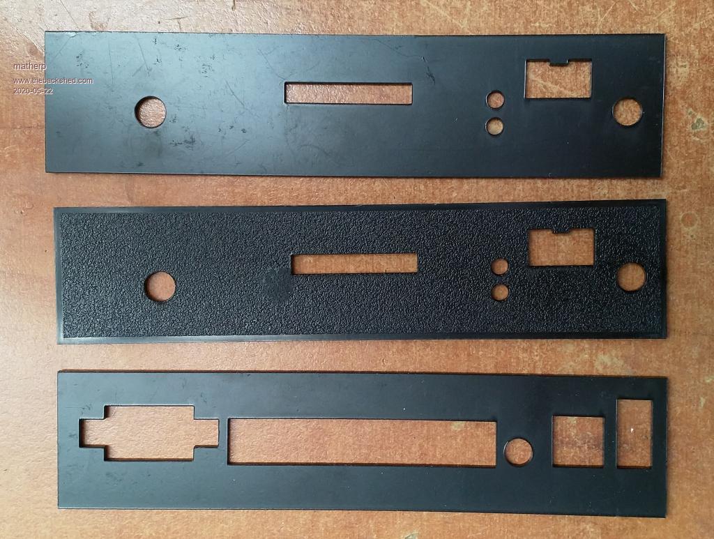

how do you drill and cut out all openings on front and back, what tools do you exactly use?
Any special hints?
Some of you seem to get it very tidily done.
Andre ... such a GURU?
Posts: 11879
Posted: 06:58am 22 May 2020

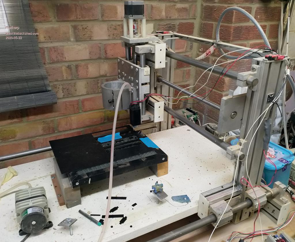

I use either a CNC router with a 1.5mm endmill or I cut them with a laser diode I have fitted to the router. I could scale this up and make them available to WW to sell but volumes would be fairly low.
I can cut the supplied end plates or cut from scratch using 2mm plastiboard
The ones pictured are laser cut

  matherp said  I use either a CNC router with a 1.5mm endmill or I cut them with a laser diode I have fitted to the router. I could scale this up and make them available to WW to sell but volumes would be fairly low.
Tell us more about thje laser head you have fitted to your cnc router, Peter. How powerful a laser is required to make these cuts in the plastic material that thick?

very clean results. Questions:
Blue laser?
Watt(LOL) power rating?

The laser head uses a NDB7A75 diode that I'm running at 2.8A which gives me about 4W of actual laser power. Note the air assist pump in the picture. This is critical to remove fumes and burned material from the cutting site. Getting this all set up and working took many hours including designing and building the constant current source for the laser and integrating control of it into the CAM software.
You can buy complete units  but need to understand the power ratings. By "commercial" standards my laser is roughly 2.6A * forward voltage c5.5V = 15W but the burning power is only 4W. To cut this plastic I use 3 passes at 200mm/min. Fume extraction is essential as some plastics give off HCN when vaporized in this way - BAD

I have been thinking about using my laser to cut stuff but the wavelength makes it very fussy on what it will touch. Clear acrylic just passes it straight through and it etches the board beneath. From my research, I see that a CO2 laser is required for clear acrylic I haven't tried on opaque (none to hand) but I had kind of thought it would be similar. I do have a need coming up to etch a circular smoked screen with another circle cut out of it. I have someone who can do it for me but if I had the ability it would lend itself to other tasks too.
I was thinking about a K40 but they are fairly big units.
Your setup definitely looks to be producing excellent results.

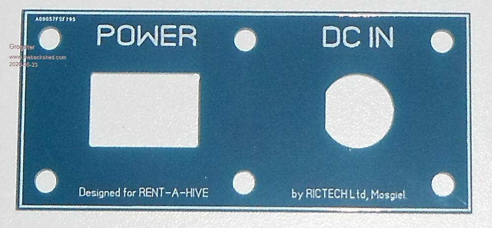

I do like the idea of having them made as PCB's, and having the factory route all the slots and holes for me, which makes it nice and neat.  Basically, you select black for your soldermask, and have the normal white silkscreen, and just have holes and no copper at all.  But they do come out looking lovely, I have to agree with Geoff there!
(yes, I have done this kind of thing before)
So, I am toying with the idea of rustling up front and back 'PCB panels', but I have not actually done anything yet.
EDIT: Here is one I did for a project....
