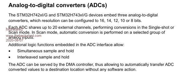

From chip description  :

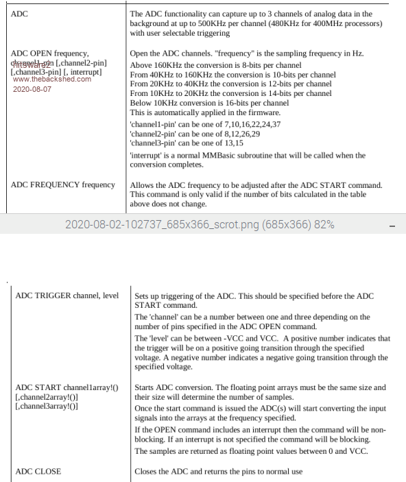

From programming manual :

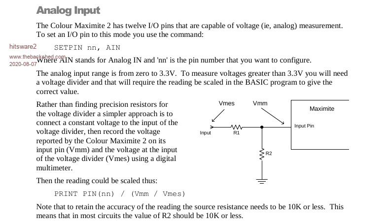

From user manual :

That is what the ADC command is perfect for.
It reads the pin in the background and fills an array for you. All in the background and bloody fast if that's what you need.
The bits/resolution depends on the sampling speed you choose.
You can then concentrate on doing the any maths and displaying that's required.

Decided to quickly see how long it does take for 255 readings.
Using ADC 12.9us
Using x=PIN(7) 372us
Edit, that including drawing the basic waveform.
Edited 2020-08-07 14:15 by KeepIS

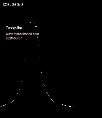

AS a simple demo, I have an analogue joystick connected to pin 7.
The program:
SETPIN 7, AIN
DO
CLS
TIMER = 0
FOR x = 1 TO 256
y = PIN(7)
PIXEL x,400-y*100, RGB(255,255,255)
NEXT x
TEXT 10,10,STR$(TIMER)+"mS"
PAUSE 500
LOOP UNTIL INKEY$<>""
SAVE IMAGE "cheapcro.bmp"
The result:
Running it without any variable input will still give you an idea if the scan rate.
The 500 mS pause is there so you have time to read the output.

The ' user ' manual doesn't even mention
' AIN ' .... Unless I ' m missing it someways ....
Should be not far after ' ADC ' ?
