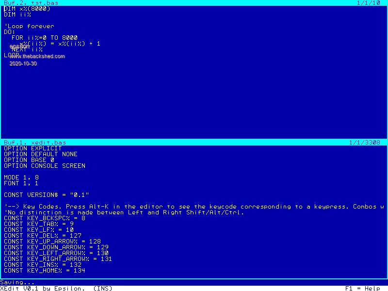

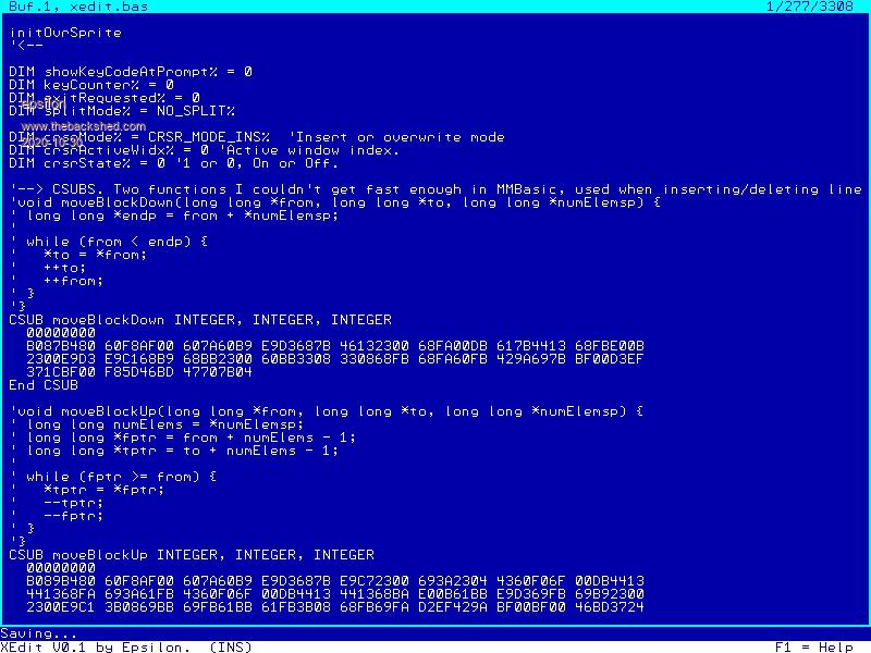

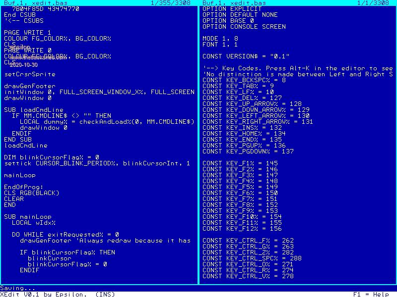

Hi all,
We all know and love the built-in editor, but it's good to have options.
XEdit is a text editor for CMM2. The editor is written in MMBasic so is by construction open source and extensible.
XEdit supports up to two windows, two buffers (files), undo and the usual complement of editor operations.
Many features are still in the pipeline. See the README below for details.
When taking XEdit for a spin please keep in mind that this is an early alpha release. There will be bugs.
Please let me know what you think, report bugs and feel free to request features.
Cheers,
Ruben/Epsilon.
GitHub:
https://github.com/epsilon537/xedit_cmm2
xedit.zip
XEdit Text Editor for Color Maximite 2 by Epsilon
Current Version: 0.1
ChangeLog
0.1:
- Initial version.
Description
XEdit is a text editor written in MMBasic. The editor supports up to two windows (Hsplit/Vsplit
or no split) and up to two buffers (files). The two buffers can be freely assigned to
windows and two windows can present separate views into a single buffer.
XEdit supports undo as well as the usual complement of operations: cut/copy/paste, find/replace,
indent/unident selections, insert/overwrite mode, goto line.
To Do's
- Add support for vegipete's FileDialog
- Add option to display row numbers next to the rows
- Add Select-All key binding
- Add Macro recording and playback
- Maintain backup files when saving
- Syntax Highlighting
- Add scroll current line to center/top/end key bindings
- Restore previous context when starting editor
- Add Find Next keybinding
- Add resource utilization pop-up
- Add optional config file with user configurable keybindings and other options
Limitations
- Max. 14000 lines across all buffers (including clipboard and undo buffer).
- Max. 2 windows
- Max. 2 buffers
KeyBindings
F1 = Help
F2/F9 = Save File/Save File as
F3 = Load File
F4 = Toggle Buffer
F5 = Toggle Window split
F10 = Quit
Ctrl-O = Toggle Active Window
Ctrl-F = Find Prompt/Selection
Ctrl-R = Replace Prompt/Selection
Ctrl-X/Ctrl-Y/Ctrl-P = Cut/Copy/Paste
Ctrl-G = Goto Line
INS = Toggle Insert/Overwrite mode
Home 1x/2x/3x = Go To Start of Line/Page/Buffer
End 1x/2x/3x = Go To End of Line/Page/Buffer
Tab/Shift-Tab = Indent/Unindent Line/Selection
Shift-Navigation Key = Start/Extend Selection
Ctrl-Z = Undo
Alt-K = Show Key Code at prompt
Alt-S = Screenshot

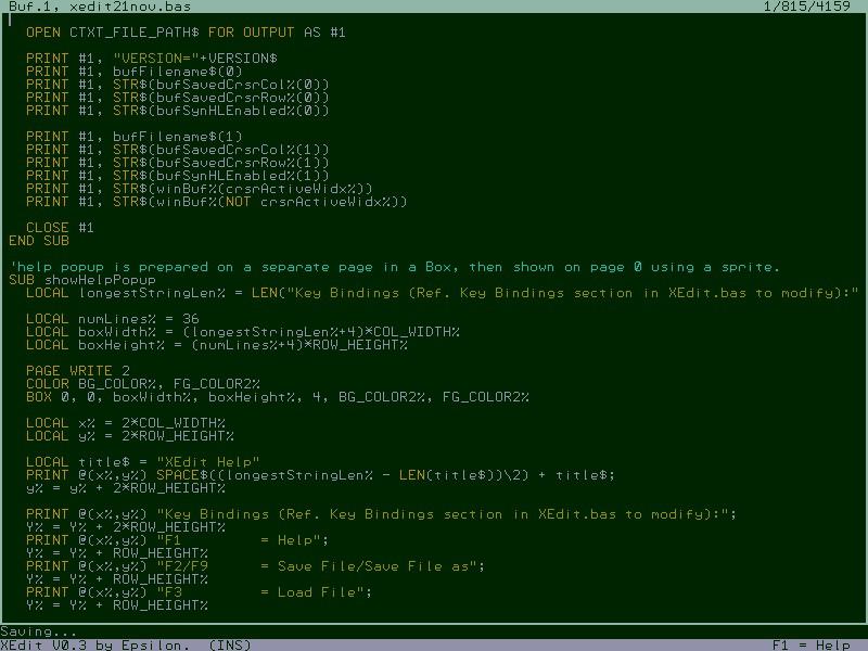

Hi all,
It was a struggle but I finally uploaded a new version of XEdit with limited syntax highlighting support.
This version also includes some optimizations which should make the editor overall feel more responsive.
There are some critical bug fixes as well. If you already happen to be using XEdit, you really should update.
Version 0.2 contained quite a few regressions, actually making it worse than 0.1. My apologies for that. I hope 0.3 will do better. I certainly gave it a lot more run-time.
For further info, see Changelog below.
Cheers,
Ruben/Epsilon.
xedit.zip
Current Version: 0.3
ChangeLog
0.3:
- Limited MMBasic Syntax Highlighting support.
- Improved vertical scrolling, line insertion and line deletion speed.
- Switched to a dark solarized color scheme. If you prefer the higher contrast blue&white theme,
 you can still select that in the user config variables section. Or you can just roll your own
 of course.
- Critical bug fix: potential program abort triggered by toggling window split. This bug was
 introduced in 0.2.
- Critical bug fix: wrap-around search without hit can leave editor in inconsistent state,
 resulting in unpredictable behavior.
- Fixed bug in replace function turning parts of replaced lines into upper case. This bug was
 introduced in 0.2.
- Macro recording fix: new macro should overwrite existing macro, not append to it. This bug was
 introduced in 0.2.
- Added DISABLE_CONFIRMATION prompt option. Default: 0.
- Fixed a bug where last lines of a buffer would show up duplicate after deleting a selection.
- Made sure that search matches are always shown fully on screen.
- Increased undo depth from 16 to 32 entries.
- Split view into a single buffer will now as much as possible maintain view in one window
 (instead of scrolling) when lines are added or removed in other window.
- Now allowing replace-with-nothing.
Description
XEdit supports undo, macro recording, MMBasic syntax highlighting as well as the usual
complement of editor operations: cut/copy/paste, find/replace, indent/unident selections,
To Do's
- Add support for vegipete's FileDialog.
- Add option to display row numbers next to the rows.
- Add visual indicators of position within buffer.
- Add Select-All key binding.
- Maintain backup files when saving.
- Add scroll current line to center/top/end key bindings.
- Add resource utilization pop-up.
- Add kill-to-end-of-line (Ctrl-K) keybinding.
- Add case senstive search/replace keybindings.
- Improve horizontal scrolling speed.
- Improve search speed.
Key Bindings
F1         = Help
F3         = Load File
F4         = Toggle Buffer
F10        = Quit
Alt-F      = Find Next
Ctrl-X/Y/P = Cut/Copy/Paste
Ctrl-G     = Goto Line
Ctrl-Z     = Undo
F7         = Start Macro Recording
F8         = Stop Macro Recording / Playback recorded macro
Alt-C      = Toggle Syntax Highlighting On/Off
Alt-S      = Screenshot
Limitations
- Max. 2 windows
- Max. 2 buffers
- Console Only
- Text entered on find prompt can't include double quotes or commas. Find selection can
includes double quotes and commas however.
- Tested on FW version 5.0505 only.
