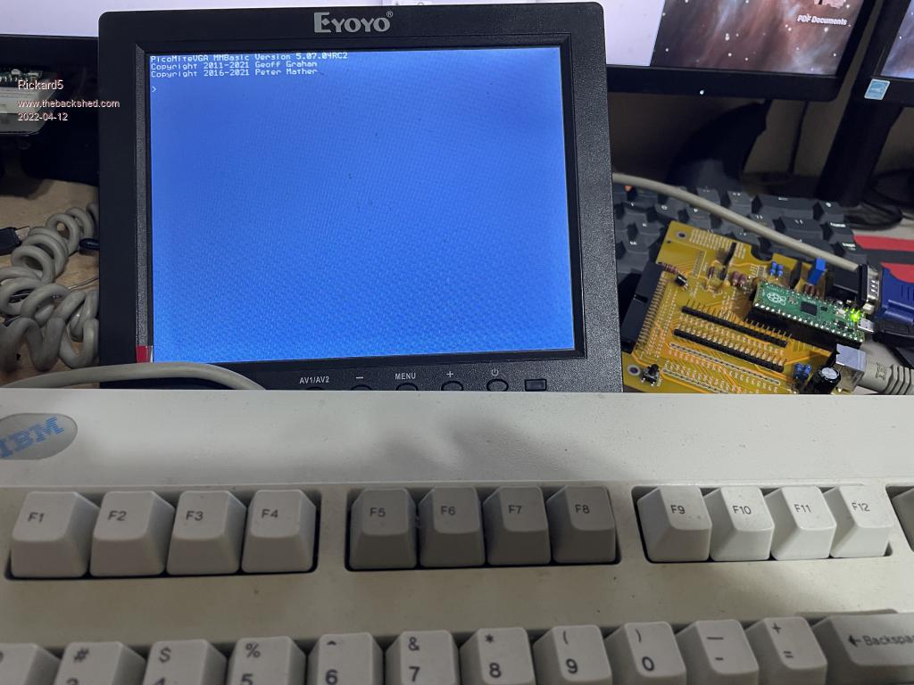

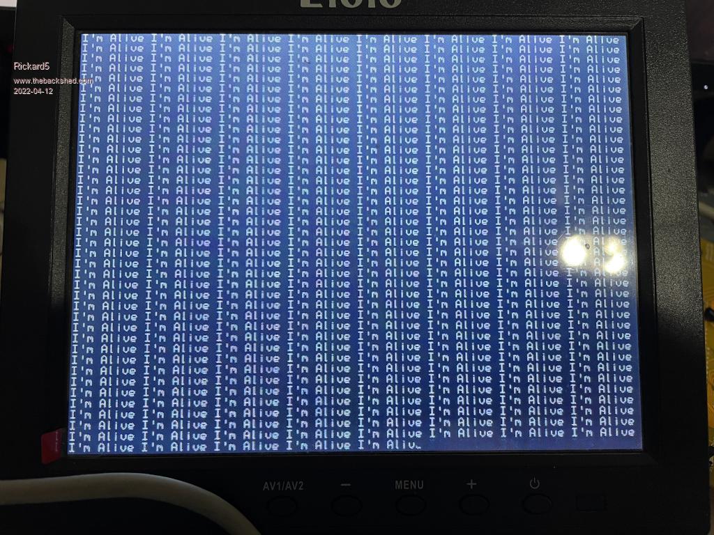

Well my Picomite 1.3 Lives and Breaths, but there is still a run to be made to mouser :( still need that $1.33 power transistor and SD Card socket. and I Desperately want a case from Hammond in England, but when she who must be OBAYED say the price and the $150 shipping, I was instructed I Hated that case and wouldn't have one I desperately would love to have a case I can pull one of my Model M Keyboards out of the plastic case and mod it in to a case with the Picomate and some Breadboard area
I Really want to thank Everybody for being so great and supportive, and I especially want to Thank Lizby for getting me a board to build
AGAIN THANKL YOU ALL FOR HELPING ME REACH A MILESTONE

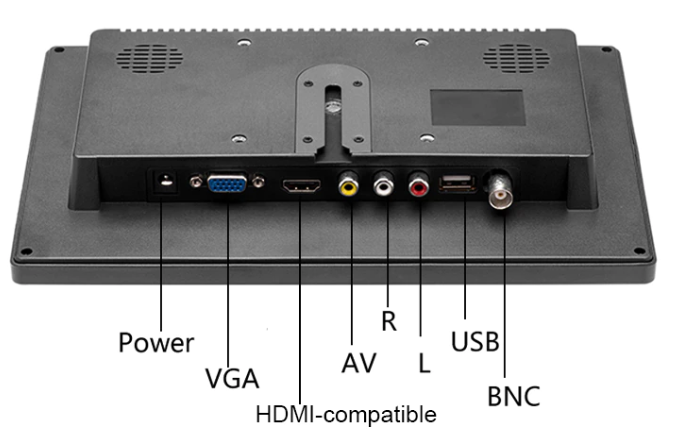

p.s. that little eyoyo monitor - is it any good?

  fred777 said  p.s. that little eyoyo monitor - is it any good?
I got it yesterday too (Podofo branded) and the picture is pretty decent. And input selection is very good also:
For 70€ shipping to Czech Republic included nice deal...

Posted: 03:27pm 12 Apr 2022
It really has a lot of inputs! And a BNC socket - wow that you don't see often any more :-)

  fred777 said  Ooooh... nice clicky IBM Keyboard :-)
I got lucky about a Year ago and ran in to a cache of IBM Model M Key Boards in a Vintage Warehouse cleanup I had 17 of them and I'm down to my last 4 I'm keeping them!
The EYOYO monitors are AWESOME, I love therm for projects their CHEAP LIKE BORSCHT!!!! but they have an OK screen I use them alot with Raspberry Pi projects like I Borrowed that one from my Pi3B+ Logic Analyzer/Oscope

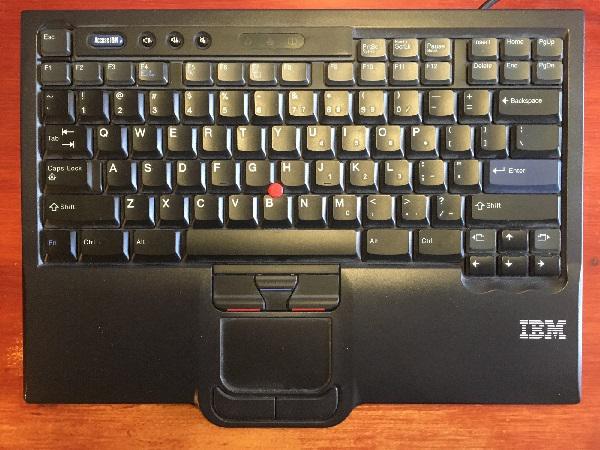

While on the subject of IBM Keyboards... (Sorry but keyboards are a hobby of mine)
this little beauty has a nice cable compartement on the back that will take a small (pico) pbc with some fumbling :-) They still come up regularly on ebay

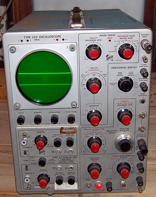

Decades ago while working for PanAm I got to tour one of Tektronix' repair shops. This was when the Tek 545a was a state of the art 33 MHz dual beam dual triggerable time base scope.
To my great surprise I found that Tektroix would automatically toss incoming scopes into a bathtub full of soapy water for a day, then rinse them with a garden hose, then stick them in an oven at 120°F for a day or two. Then they plugged them in, and tested them. They found that nearly 50% of the problems were solved by the spa treatment! They would carefully re-lube all of the switches and pots, using a needle dispenser, with Blue Cramolin and ship it back to the customer.
At PanAm we had a chemical test lab reverse engineer Cramolin Red and Cramolin Blue. The red contained an acidic oxidation reducer plus a low viscosity mineral oil, the blue was just a mineral oil. We later found that gelled dilute phosporic acid (naval jelly) did about as good as the red cramolin at removing oxides and we followed that with an application of dilute baking soda and then mineral oil. That became our standard contact cleanup method for heavy relays like the three phase 40 KVA generator relays behind the engineers panel on the 707.
I still like that old TEK 545! The knobs are big enough for my fat fingers to grab, I can read the panel legends around the knobs, and the knobs are far enough apart so that my fat fingers and knuckles don't get jammed between them.
