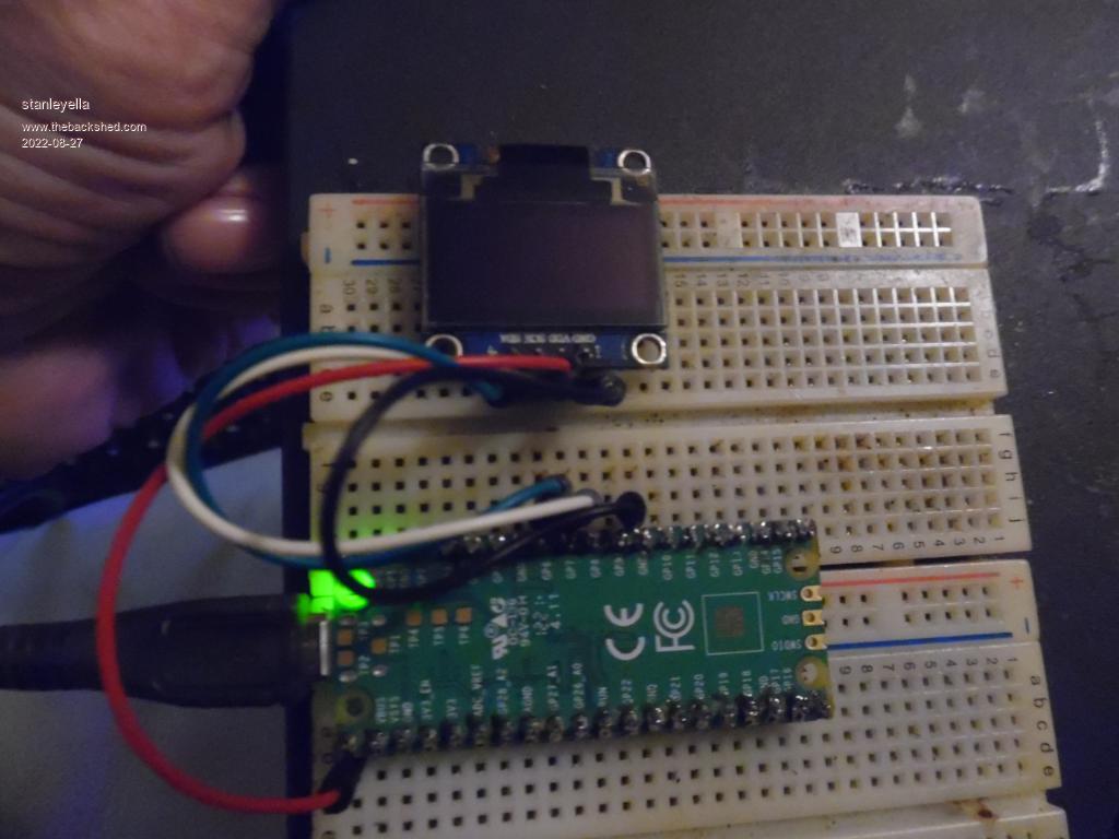

what value pullup resistors please?
using vbus ie 5V from usb to ssd1306 and ground. will sda and sck work from 3.3v logic?

Start with OPTION RESET to clear anything there before. Then use the commands exactly as per my picture. You are using the PicoMite and not PicoMiteVGA firmware? 10K pullups will be fine but are probably already on the SSD1306 PCB

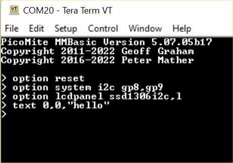

Thanks @matherp. using picomite non vga. I used ssd1306 on 8bit and 4k7 pullups.
option reset win disconnect reconnect sound.
> option reset
> option system i2c gp8,gp9
Error : Pin 11 is in use
rewired to gp6,gp7
> option reset
> option system i2c gp6, gp7 'gets this far ok

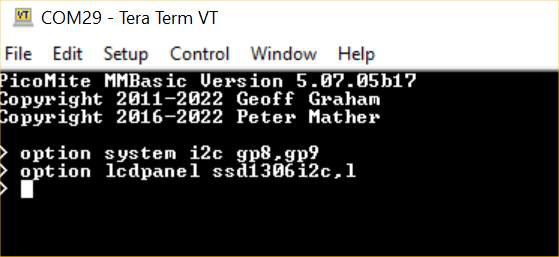

> option lcdpanel ssd1306i2c,l 'error
Error : Invalid Option

It has to be exactly as Peter showed.
You have this:
It should be this:
> option lcdpanel ssd1306i2c,1
l and 1 (L and One) look almost the same but MMBasic isn't interested in in looks!

OPTION LCDPANEL SSD1306I2C, OR [,offset]
try this (with the spaces, just in case they matter)
OPTION LCDPANEL SSD1306I2C, L ,1

What does ?mm.device$, mm.ver report?
What does OPTION LIST show?

This is a 5V device but
@lizby said "For 3V3 devices, 10K pullup resistors will usually be appropriate. 4K7 for 5V devices."
10K pullups to 5V or 3.3V?  'are they needed for a bread board project ie short wires?
Running ssd1306 from vbus 5V... I have tried running it from 3.3V.  hence pullup question.
I think it is not as simple as spi for display.
Sure the sda,scl lines are 3.3V logic?

Never connect anything over 3.6V to any RP2040 pin
Posts: 11672
Posted: 05:42pm 27 Aug 2022
Not sure how to make this any easier
Connections:
SSD1306 VCC to PicoMite 3.3V
SSD1306 GND to PicoMite GND
SSD1306 SDA to PicoMite GP8
SSD1306 SCL to PicoMite GP9
No resistors needed just 4 link wires

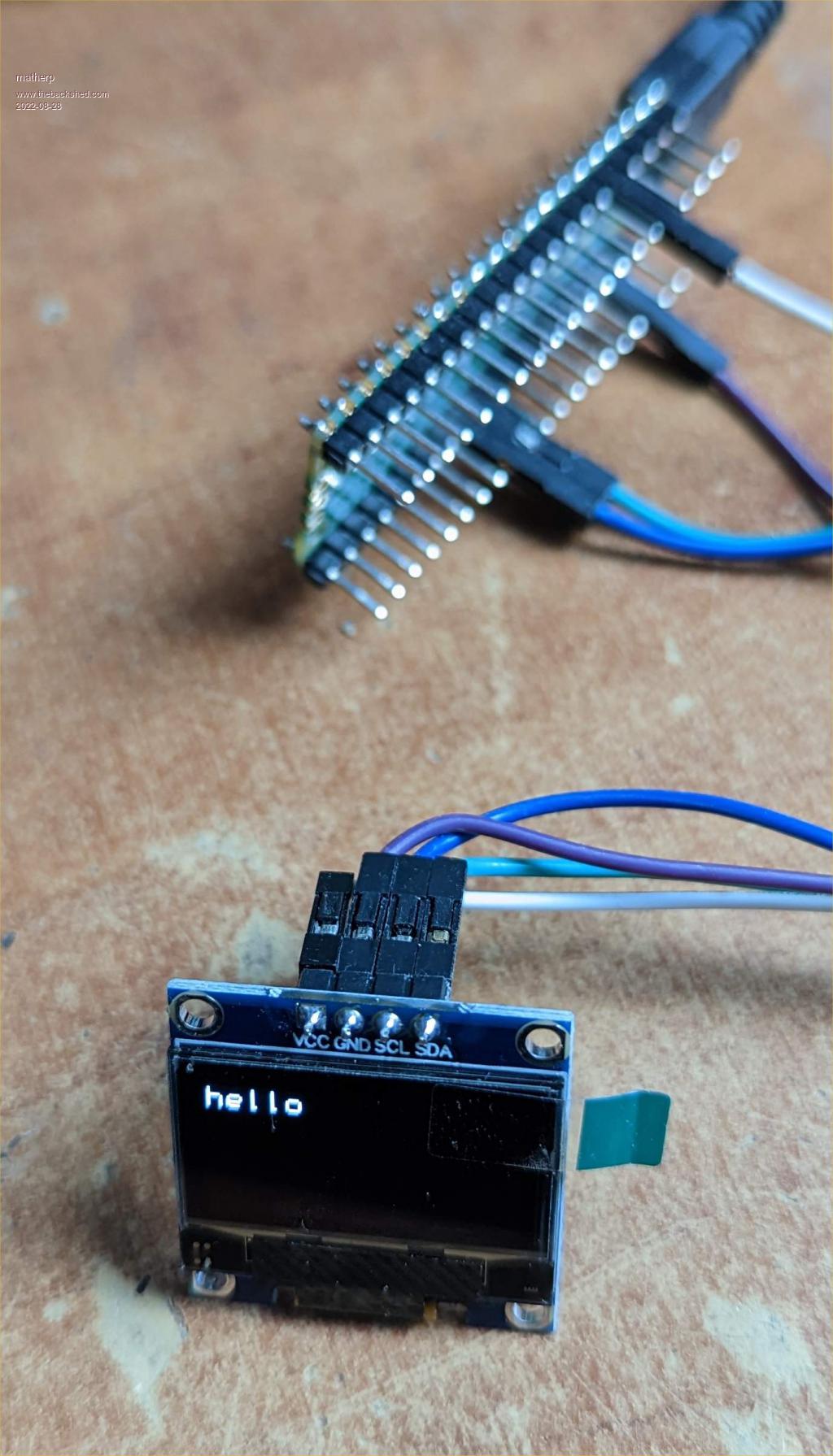

Posts: 2807
Posted: 07:34pm 27 Aug 2022
Mik
testing nothing works with 2 ili9341 that do work
teraterm
> option reset
yawn. forget i2c expanders
