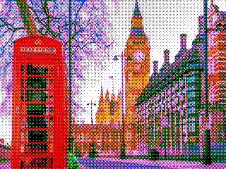

I am writing a little Routine to convert Pictures from png sources to PicoMite compatible BMP
Therefore I try to "ditter" Colors, wich do not fit, to values that can be used on Picomite. I started in MM Basic for Windows as it is able to read full Color PNG  write BMP
Here is my first try in MMB4W
load png "london.png"
for y%=0 to 239
for x%=0 to 319
 cl%=pixel(x%,y%)
 oc%=0
   if (cl% and &HFF0000)>&H7f0000 then
      inc oc%,&HFF0000
   endif
   if (cl% and &HFF0000)<&H7f0000 and (cl% and &HFF0000)>&H400000 then
      inc oc%,&HFF0000*not (x% mod 2)*(y% mod 2)
    endif
   if (cl% and &HFF)>&H60 then
      inc oc%,&HFF
   endif
   if (cl% and &HFF)<&H61 and (cl% and &HFF)>&H40 then
      inc oc%,&HFF*(x% mod 2)*not (y% mod 2)
   endif
  select case (cl% and &H00ff00)
   case &H002000 to &H005f00
      inc oc%,&H004000
   case &H006000 to &H00AF00
      inc oc%,&H008000
   case &H00B000 to &H00FF00
      inc oc%,&H00FF00
   end select
   Pixel x%,y%,oc%
 endif
next x%
next y%
save Image "London.bmp",0,0,320,240

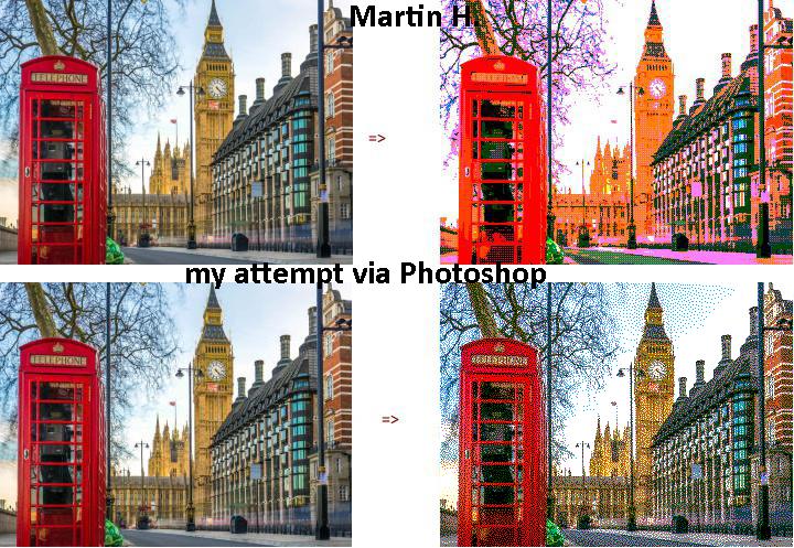

the Results look like this:
The result is promising but can certainly be improved
Does anyone know of a smarter routine for down converting colors?

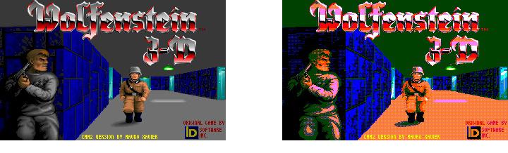

btw: this is how/why it started:
Edited 2022-12-21 23:54 by Martin H.

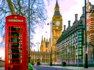

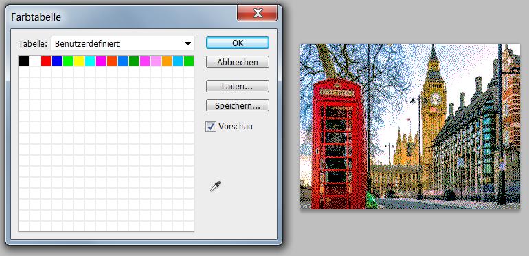

I've done something similar in the past but only with Photoshop CS5 and came up with this (by using your original picture):
It seems there will be always some compromise between the more real effect in my attempt and your version with more color-filled area (which is easier to watch from near on a big monitor). In my attempt it looks great from far, but not so good from near.
It is really cool to see that you managed to convert this via MMBASIC and not using some kind of "third party" sofware like me.

Hi Daniel,
very nice, the (random) dithring from Photoshop is better for Photos than my little try in MM Basic.
but the The target system is the PicoMite VGA and only the Colors it can display.
When I enlarge your picture I see different red tones and sometimes gray pixels.
All colors, that the Pico cannot geneate. So I don't think the picture on the Pico is presented correctly.
  Martin

Posted: 09:53pm 22 Dec 2022
Using IrfanView's default options for "Decrease Colour Depth" > "16 Colours" the result is similar to your program, but the file size is 38.4kB instead of 230kB.
It seems that when PhotoShop or MMBasic save a 16 colour BMP they still use 24 bit format. "Decrease Colour Depth" changes it to genuine 4 bits / pixel. If you use the new Drive "A:" that is useful.

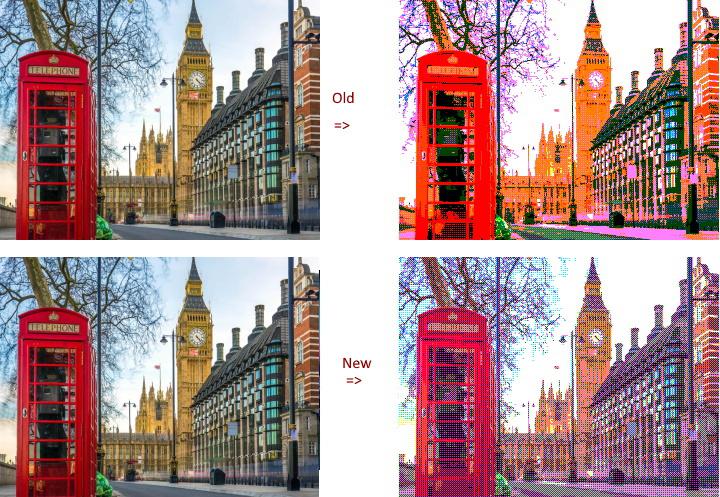

I changed the to process a ordered Dithering for Red and Blue..
(I left Green, as it has already 3 possible Values)
depending on the brightness of the Color and the Pixel Position it will get a
result, depending on this pattern.
00 01 01 01 or 11
00 00 10 11    11
dim shd%(2,2)
shd%(0,0)=64:shd%(1,0)=128
shd%(0,1)=192:shd%(1,1)=0
for y%=0 to 389
for x%=0 to 319
 cl%=pixel(x%,y%)
 oc%=0
'red
   RC%=(cl% and &HFF0000)>>16
   OC%=OC%+(shade (RC%))<<16
'blue
   RC%=(cl% and &HFF)
'green
      inc oc%,&H004000
      inc oc%,&H008000
      inc oc%,&H00FF00
   end select
   Pixel x%,y%,oc%
 endif
next x%
next y%
save Image "London2.bmp",0,0,320,240
Function shade (Cl%)
shade=255*(cl%>shd%(x% mod 2,y% mod 2))
end Function

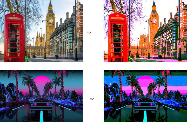

here is the result in comparison with the old version
the result depends very much on the source.
Maybee it would be better to convert the Floyd-Steinberg algorithm to MM Basic.

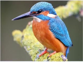

I've tried both with photoshop, first do more areas with solid color and than do the (automatic) Photoshop filtering with my 16 color palette and surprisingly came to worse results due to the color palette. Maybe it is just me but I think the color palette for the C64 is better for what we want.
But here is another Photoshop result I tried:
(Photoshop generated 16 Color palette for picoMite VGA)
(Original)
And the photoshop processed image as an BMP file:
bird_normal.zip
Hmm.. I really don't know how to make it look better on bigger screens...

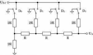

On RGB (VGA) roughly speaking, you only have to connect the 4 output signals from the Pico to one and then give that to all 3 inputs of the VGA monitor.
Better use the 4 Bit with a simple R2R Resistor Network as D/A Converter.

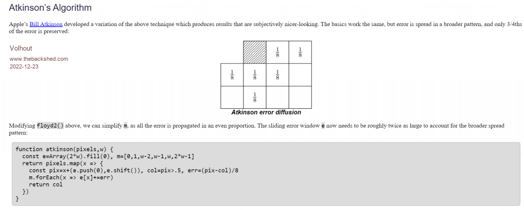

Maybe the math is simpler using Atkinsons dithering (Apple uses it).
You might want to dither to mode 1 (monochrome), I did for SSTV, but not Atkinson. Just hard coded: 10 level per pixel -> 3x3 monochrome pixels
But I think there is alread some dithering algorithm in picomite. When you load JPG there must be some form of dithering or is it only scaling...

1.) Ordered dither
djpeg london.jpg | ppmdither -red=2 -green=4 -blue=2 | ppmtobmp > london_ordered.bmp
Result:
ppmdither has an additional option to change the size of the dithering matrix. While it does make a difference to the output, I didn't find I could see any difference changing it from the default 4×4 pixels.
2.) Floyd-Steinberg dither
This command line appears a little longer, as we have to specify the whole RGB121 palette as a parameter. I could've used a file, but this way keeps everything tidy:
djpeg london.jpg | pnmremap -floyd -mapfile=<(echo P3 16 1 3 0 0 0 0 2 0 0 2 3 3 3 3 0 3 3 3 0 3 3 0 0 3 1 0 3 2 3 3 2 0 3 1 3 0 3 0 3 3 0 0 1 3 0 0 3 0 1 0) | ppmtobmp > london_floyd.bmp
Result:
Perhaps slightly lumpy in the sky. pnmremap assumes you want it to choose the best palette, otherwise you have to tell it the colours you want.
This, as far as I can see, is the RGB121 palette. I made it by feeding the output of ppmcie into ppmdither.
Here are the BMPs generated from the above two commands:
