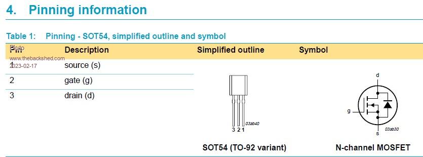

The MOSFETs for the keyboard (Design #2) was to have used BST72A (two).
Various others seem OK, but are the source, gate, drain sometimes in the reverse order?
E.g. 2N7000, TN0702N3-G, VN0808L-G, VN10KN3-G all seem the same but opposite of BST72A.
(I've not found a convincing pinout for the BST72A, though.)

I found the BST72A datasheet unclear & its pics unhelpful/unclear (e.g. no indication of the viewpoint). All the others were clear, with clear pics. Sadly that didn't help me compare because of the BST72A's pics etc.
It did seem likely the pin order is reversed, but that in itself felt mad!! I mean, WTF!

There has been inconsistency between pinouts of plastic encapsulated transistors and FET's forever. The plastic (motorola) 2N2222 is reverse packaged compared to it's european (philips) counterparts as BC337/BC547. And this may also count for the FET's like BST72A and 2N7000.
In modern packages this is more harmonized. The SOT23 package variants of these parts have the same pinout. It is just the TO92 parts that have this problem.

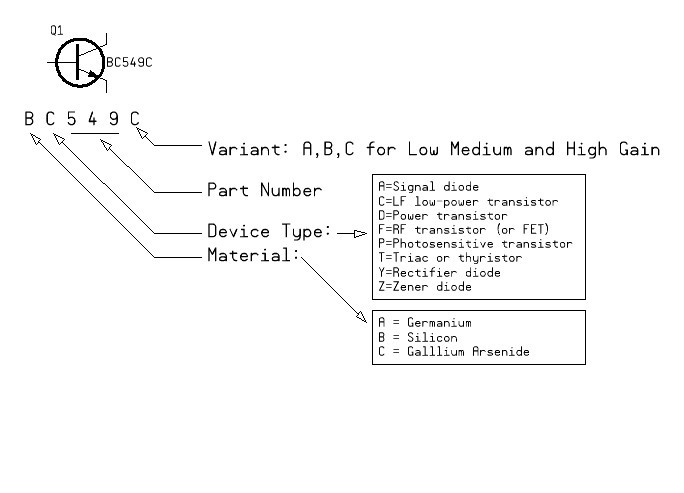

Europe adopted a standard for semiconductor parts naming that was based on a pre-existing Philips standard used for vacuum tubes. These parts became known as the Pro Electron/EECAdesignation which was created in the mid 1960s. It used a much more informative prefix and suffix than the JEDEC standard used (JEDEC is where 1N for diodes and 2N for BJTs came from). Here is an example:
Interestingly, pretty much every 'BC' part has a flipped layout from JEDEC pinouts, and Japanese parts also tend to have a different layout than JEDEC parts.  It's almost as if they are forcing you to *use their replacement parts* if your PCB was designed for them in the first place.
