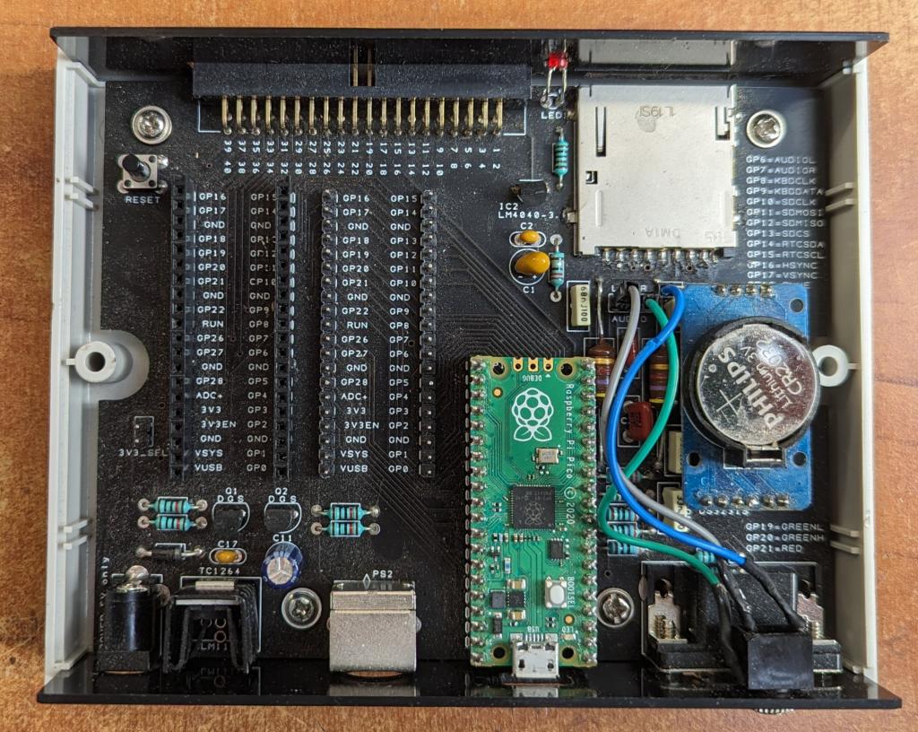

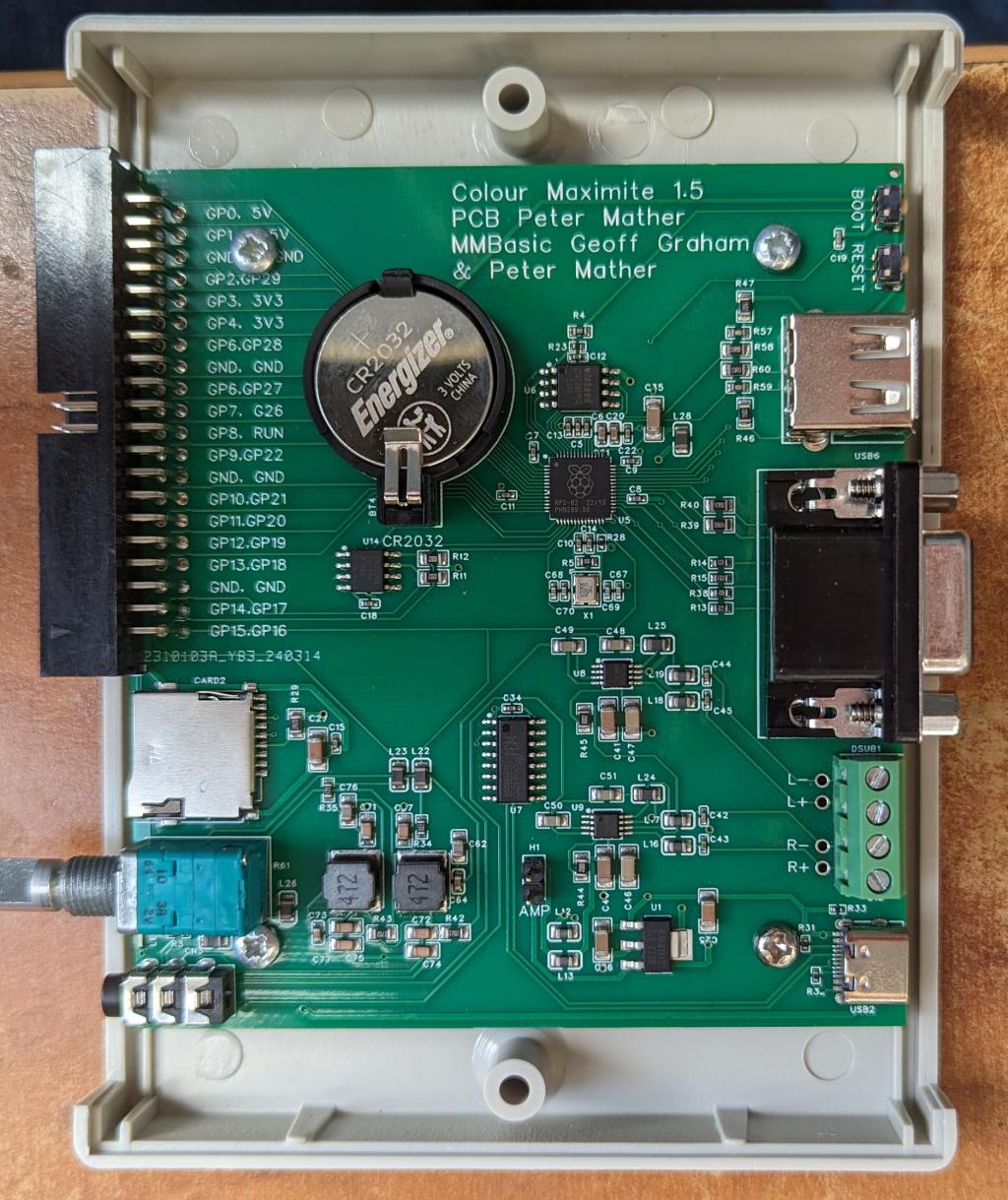

OPTION RESET CMM1.5

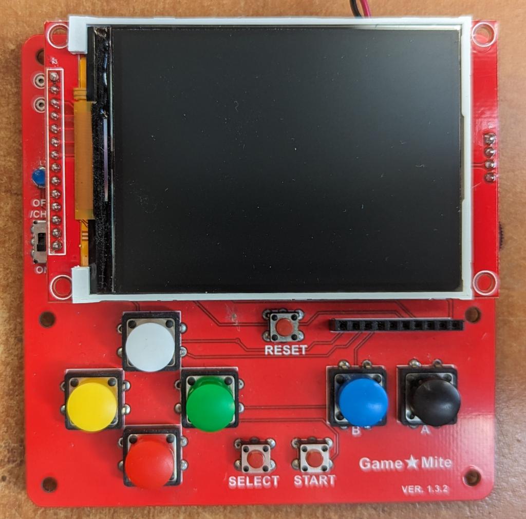

OPTION RESET Game*Mite

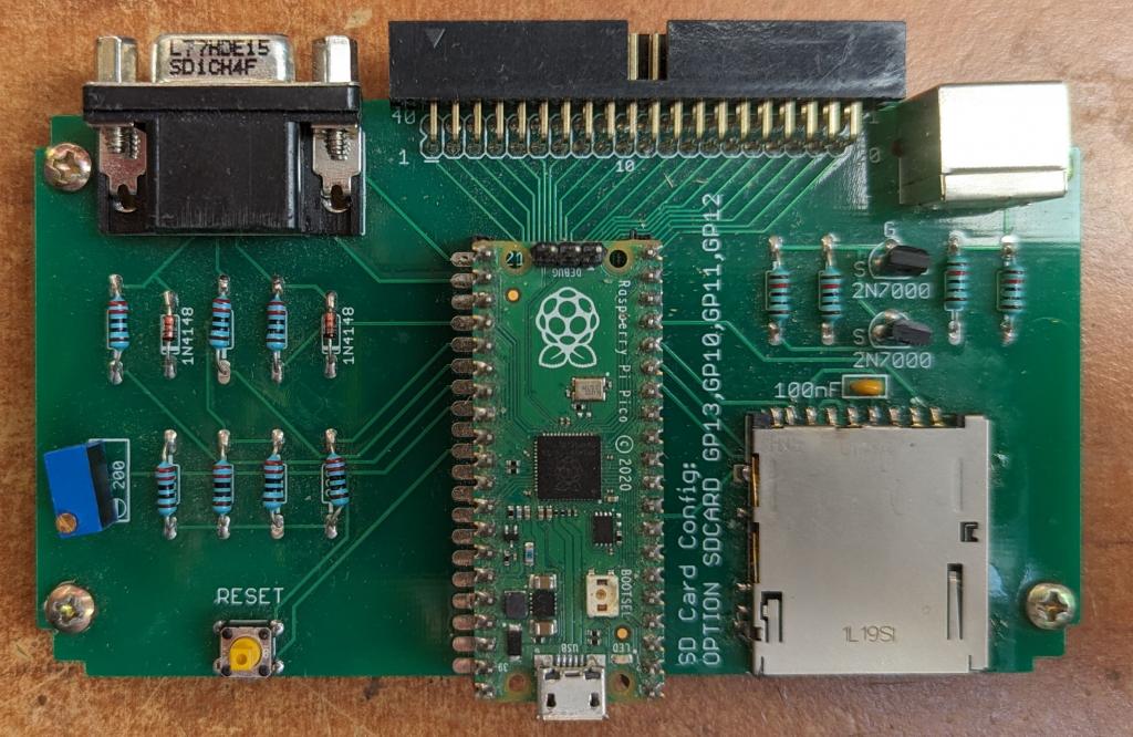

OPTION RESET PicoMiteVGA V1.0
OPTION RESET PicoMiteVGA V1.1
OPTION RESET VGA Design 1
OPTION RESET VGA Design 2

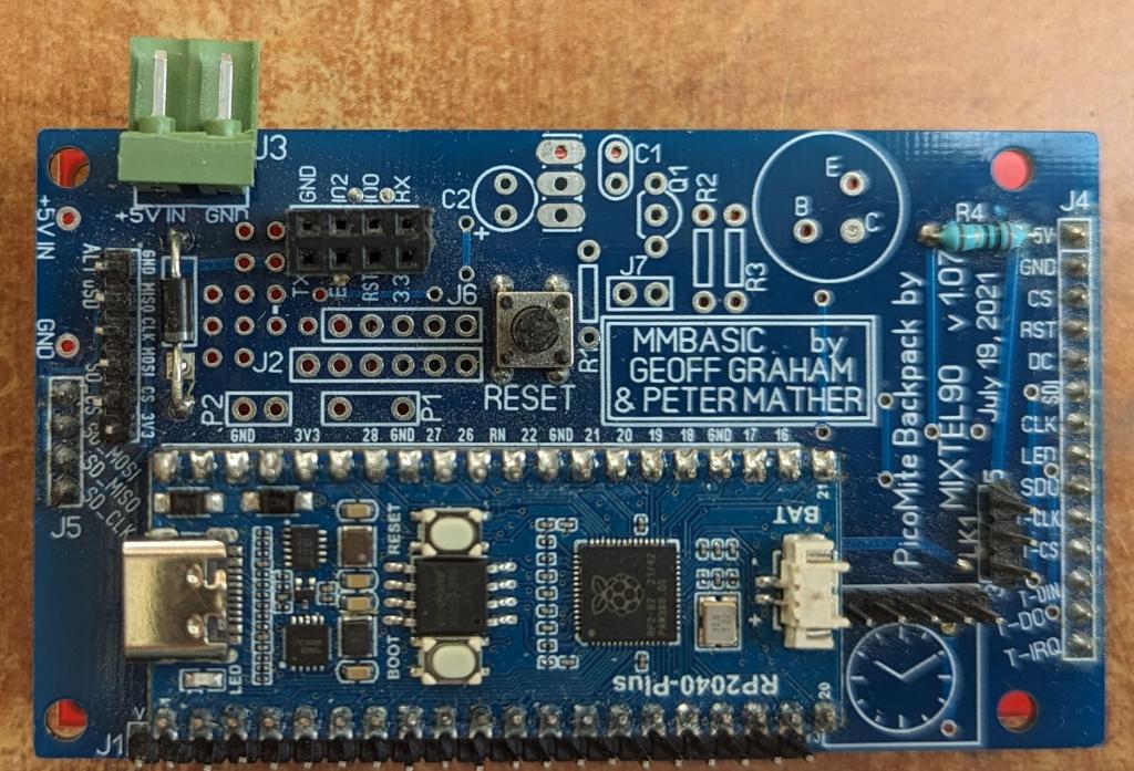

OPTION RESET PICO BACKPACK

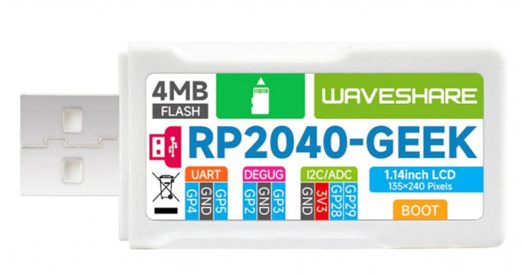

OPTION RESET RP2040-GEEK

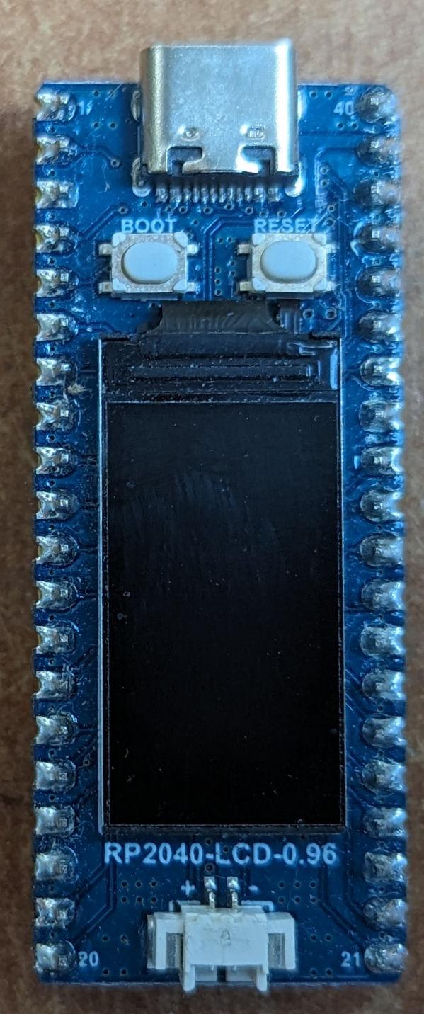

OPTION RESET RP2040-LCD-0.96

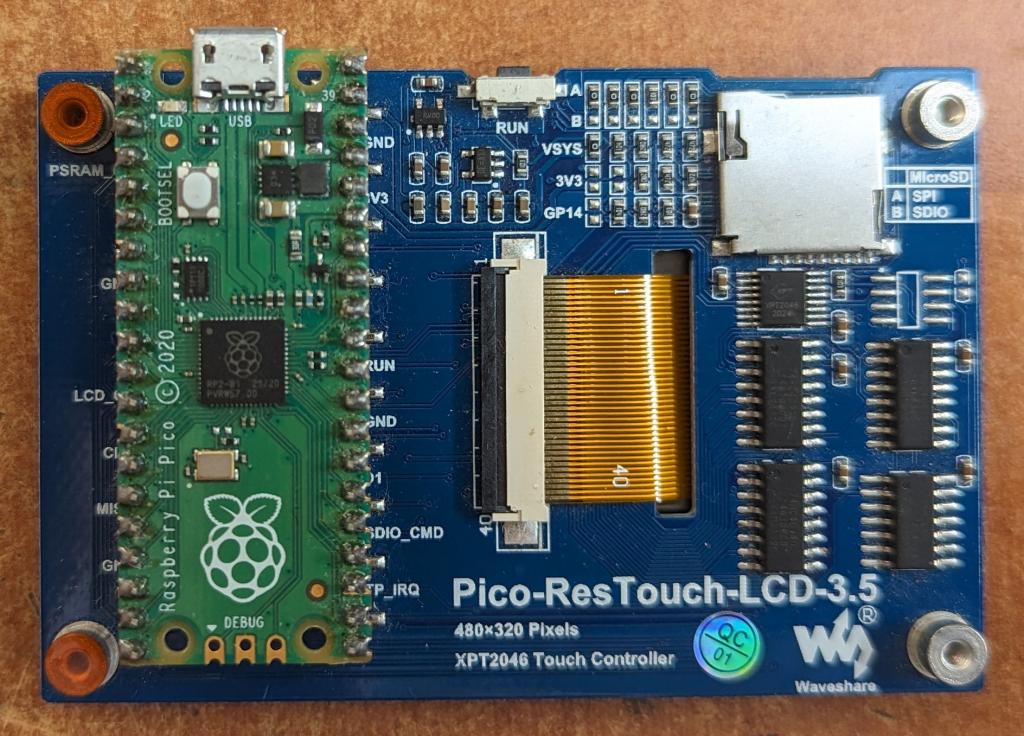

OPTION RESET Pico-ResTouch-LCD-3.5

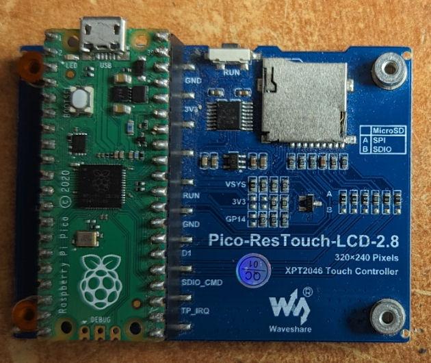

OPTION RESET Pico-ResTouch-LCD-2.8

Nice red Game*Mite, yours?

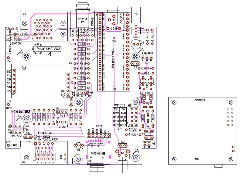

OPTION RESET PICOGAME 4

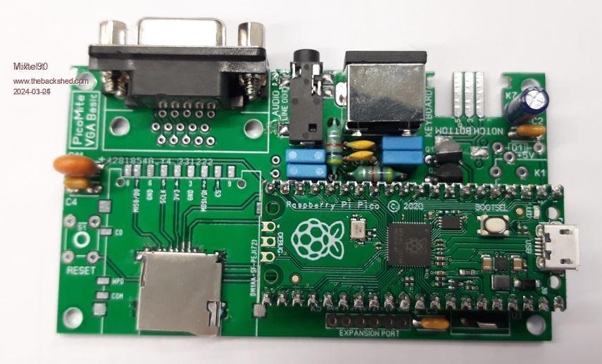

OPTION RESET VGA BASIC

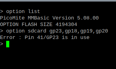

Hi All;
I have a waveshare-geek and loaded 5.9 RC1 to try the OPTION RESET RP2040-GEEK command.
The 1st thing was the lack of OPTION SDCARD and a difference in the display GPIOs causing the display to flash on and off. The GUI TEST LCDPANEL did not show anything and gave no errors.
Then comes the weird part after I did an OPTION RESET and tried to configure the SDCARD, so I could do a OPTION DISK LOAD, after hitting enter it gave me a message that pin 41/23 was all ready in use. Of course it did that was used up in the display configuration of OPTION RESET RP2040-GEEK, but why was it still there? (Sorry forgot the screen shot).
I had this thing working completely under 5.8 ;
My thinking was to go back to 5.8 and thats when I had a real problem!
I first used Clear_flash.uf2 then loaded 5.8.00. I went to configure the sdcard and up came the same message as in 5.9;
I hope this does not mean my Geek is now pooched.
If you need more information please ask.
Hans ...
