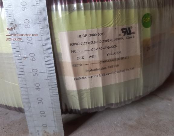

Option 1. 3kva aerosharp 230v / 250v.
Of course the 250v winding is on the outside    - i could add a few turns to the 230v winding and run them parallel, but that leaves little room for the primary.

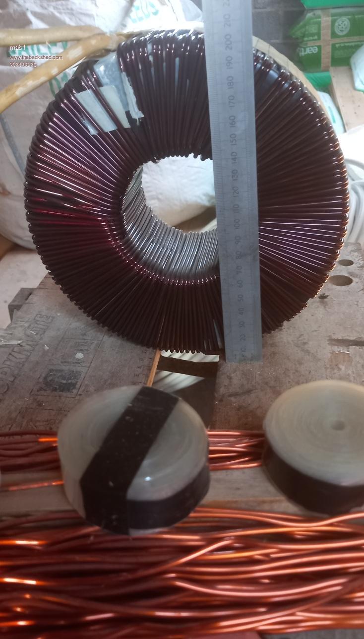

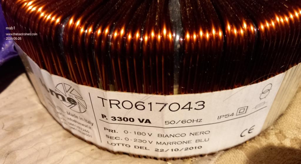

Option 3. (2 off) 3.3kva santerno inverter transformers 180v / 230v
I've already removed the 230v winding from one:
The original plan was to unwind,  put the cores together and make a massuve 6kva unit like clockmanfr - but that's a LOT of unwinding/winding!
Keepis gave me the idea of keeping the inner windings and stacking, but 2x180v seems a little ott to me - although i could unwind part of each i suppose?

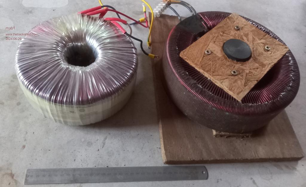

Just a size comarison: variac and 3kva aerosharp

I have also been thinking about the 3kW Aerosharp, it appears to be a similar production to two that I have, that is 195T for 230V and 212T for 250V. If you expose the outer winding and count back 9 turns from the 250V winding you are left with 203turns.  If you unwind one turn from the remaining 9T winding you have 8T which when added to the 195 gives you another 203T winding. Apply some thinking before deciding where to place the initial cut as when done well it will give reasonable length stubs for the 2 ends that need to be brought out. The 1T extra you unwound gives some isolation on that same layer as the windings may have nearly full mains between them depending on how you phase them but it gives an ultra low impedance mains output and bit lower Flux for a 230 - 235V output.  This is all theory and supposition as I have not unwound one to check yet.
Edit: I dug out the 3kW Aerosharp toroid and had a closer look - it is a "scatter wound" affair, whilst it sounded simple counting back 9 turns, it looks a bit of a problem in the flesh. undoing 9 turns should be relatively simple, winding back on 8 turns but using a mylar separator (20mm wide?) might work ok. Just adding 17T in a similar fashion as an overwind is starting to look  more attractive...

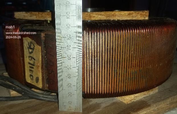

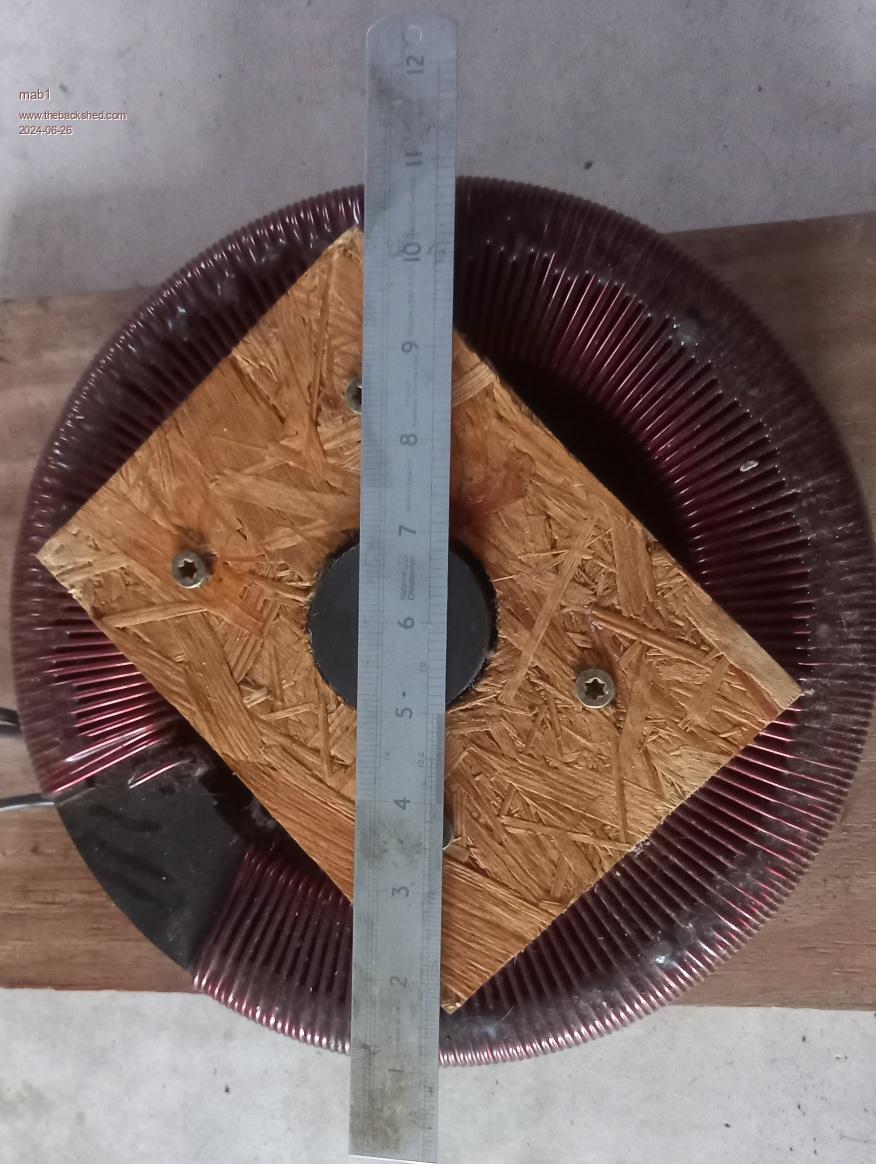

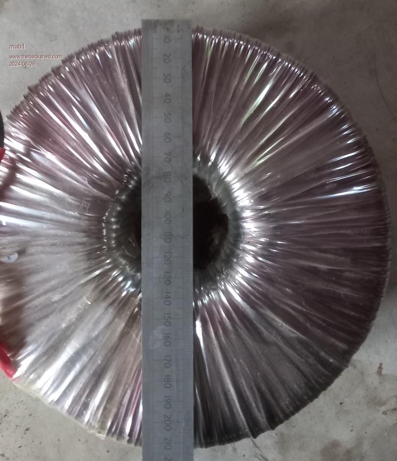

KeepIS: i hadn't actually measured the core area, just judged by eye, but i did manage to measure the core sections today as best i could though:-
42 x 60 mm variac = 2520mm2
74 x 52 mm each santerno = 3848mm2
Can't really tell with the aerosharp as it's still intact.
So the double stack santerno should be 3x the iron area of the variac.
WG: adding 17 turns to the aerosharp sounds like the easiest option for that transformer- i have the wire and mylar i unwound from the 1st santerno 230v winding to try it, and i have lots of 10mm2 16mm2 and 25mm2 houshold wire here, though the hole in the centre looks very small to get 2x 10mm2 through to me.
But it does sound like the santerno double stack should be the 1st choice for the house inverter - though just the thought of all that unwinding makes my elbows hurt

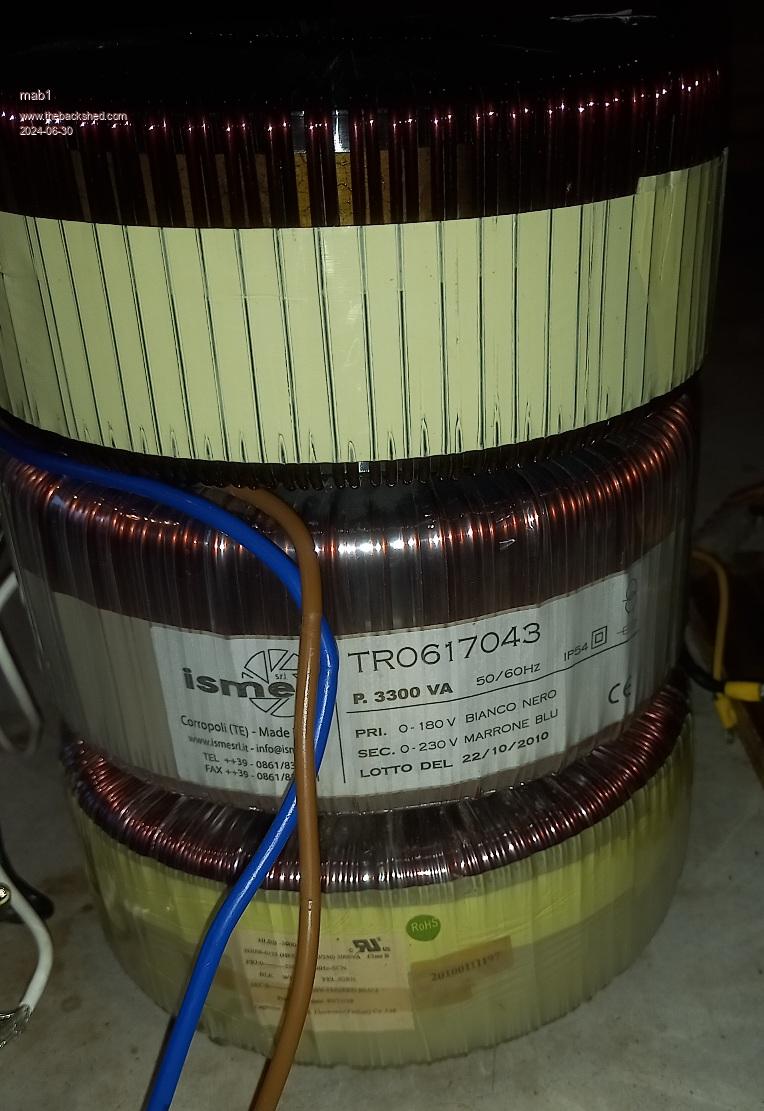

I did stack them to compare sizes directly- the two 3.3kva santernos on top and the aerosharp 3.0kva on the bottom - curiously the aerosharp looks bigger - but maybe that's the earth screen layer bulking it up
I suspect the cores are very similar sizes - prompting the (mad) thought that i could do a triple stack 9kva!!   but if your 3x2kva does your workshop and house,  i definitely don't need 9kva - and i probably wouldn't be able to move it without an engine hoist.
So, back to sanity:
I counted 155turns for the 180v winding (took three counts to get two the same)
So that's 1.163 v/t
So 140v nominal (but actually to run at 230/2v) = 121 (120.55) turns.

Ok I've confused myself now   but i think if i wind 121 turns on each and run at 115v each, thats 82% nominal voltage, or equivalent to running
148v on the 180v winding or
188v on the 230v winding
Interpolating the tables above that would be 8.3w per core from the upper table or 7.4w per core from the lower table. Not sure why don't agree better, but i guess they're plausible figures
Edited 2024-06-30 07:53 by mab1
