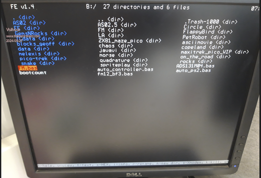

4 years ago, I wrote a file manager program for the CMM2. It's main purpose was to test the various image and audio formats that are supported by the CMM2.
I had a few hours to spare so I decided to see how well it ran on the picoHDMI.
The original was hard coded for 800x600 display so that was the first thing to fix.
There are still a couple of tweaks needed.
I decided to remove the mouse controls but that could be reintroduced if required.
There are two changes I was not expecting.
SEEK 0 on the CMM2 gets you to the start of a file.
You need SEEK 1 on the pico. SEEK 0 throws an error.
The pico drive A file system is case sensitive.
The attached program should run on any display resolution and will adjust the number of columns automatically. If you don't like MODE 3 on the HDMI or VGA, edit line 29
I suggest renaming it to File Explorer to avoid confusion with Javavi's File Manager.

Hello Jim,
it runs on a lcdpanel 800x480 just as well.
Thank you!

Thank you for File Explorer for pico. Some minor remarks:
- In VGA Mode 1, the file highlighting (colouring) is only in the first column.
- The help text banner is wider (800 ?), and does not scroll, so some parts are not visual on 640.

@Volhout
I haven't any experience with the magic that produces the colour in VGA mode 1 but I am guessing that I need to start the text on a byte boundary. The program simply divides the pixels by 3. I will do some adjusting.
The help banner is as short as I could make it. The main one is 'h' which shows the full help.
You could try a smaller font. 'f' toggles between font 1 and 7

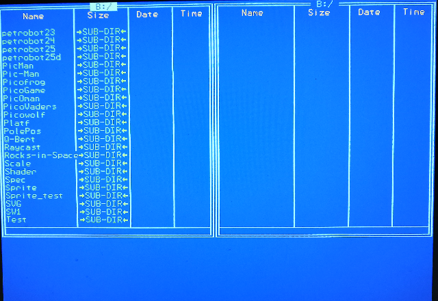

I also started programming a file manager once. (only the basic structure and optics)
'MartinCommander ;-) MC
MODE 1:Font 1:CLS RGB(blue)
Dim integer fh=MM.Info(FONTHEIGHT),fw=MM.Info(FONTWIDTH),fnr,dnr
Dim String folder(512)length 64
Dim string fls(512)length 64
topln%=0
dframe 0,topln%,39,28-topln%
dframe 40,topln%,39,28-topln%
MText 5,topln%+1,"Name        Size     Date    Time",RGB(Yellow),RGB(Blue)
MText 45,topln%+1,"Name        Size     Date    Time",RGB(Yellow),RGB(Blue)

maybe we can try to combine the best of all of them
Martin

I have sorted out the strange colours/lack of colour
I should read the manual more often.
A fix tomorrow ...

I think I have fixed the colour in MODE 1
Using font 7 will be in monochrome, font 1 colour.
I also fixed a couple of other bugs.
