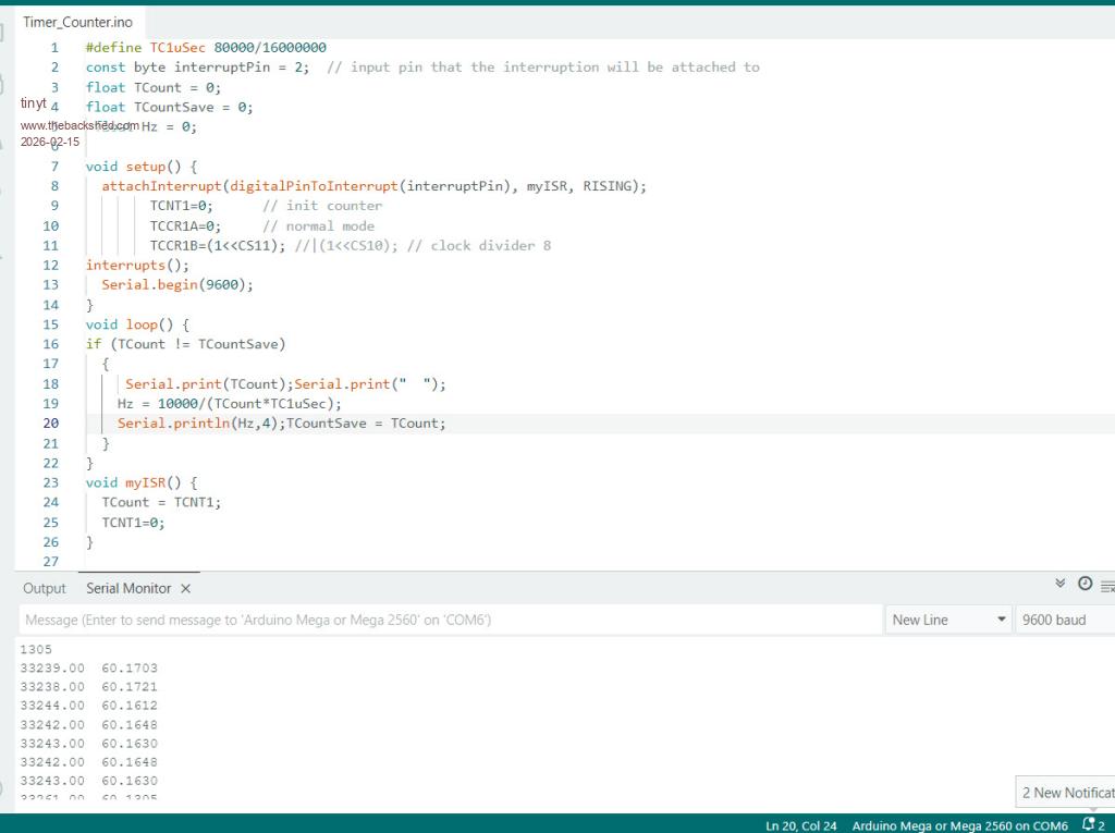

I removed the existing crystal, connected the LTC6900 output to the OSC1 input of the EG8010. (I lost 1 LTC6900 because I sneezed when I was trying to solder it).
According to the LTC6900 data sheet, the resistor value for 12 MHz is 12.5k ohms if my calculation is correct. So I used a fixed 10k resistor and a 5K trimpot. But the resulting 1LO frequency is 71Hz to ~90 Hz with trimpot adjustment.
So, I changed the fixed 10k to 15k.
Here is the arduino/code report. Will continue testing how much it drifts. But looks promising.

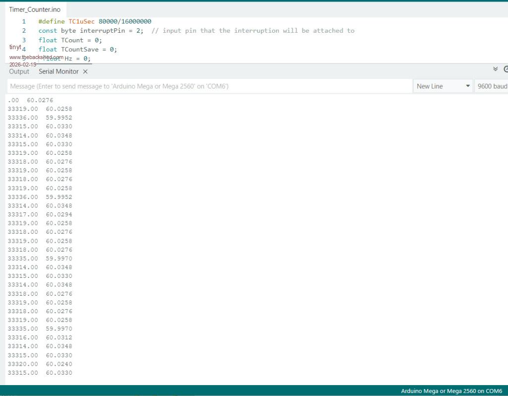

Update:
Frequency(60.0x) did not change much at room temperature for about 2 hours.
So, I used a hair dryer and blew hot air to it and frequency increased to 60.27x.
Frequency went back to 60.0x when it cooled back to room temperature.
The 5K trimpot has its wiper set for 1.46k to get 60Hz. I think I can change it to 2K for finer adjustment with the same number of maximum turns.
The LTC6900 has a TCR of +/-40ppm/C. I don't know the TCRs of the fixed resistor and trimpot. The LTC6900 data sheet recommends using precision metal film resistor for stability.
