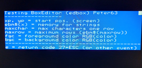

My old LineEdit looked like this, based on my version for Maximites.
BTW: Check out the Print @() function for inverting characters!
The @(x,y) function will automatically suppress the automatic line wrap
normally performed when the cursor goes beyond the right screen margin.
If 'm' is specified the mode of the video operation will be as follows:
m = 0 Normal text (white letters, black background)
m = 1 The background will not be drawn (ie, transparent)
m = 2 The video will be inverted (black letters, white background)
m = 5 Current pixels will be inverted (transparent background)

Daniel,
I have made a Subroutine I call edbox (BoxEditor), which I think you can try. It may contain some errors, but as far as I have tested it seems to work. Please come back if you find any strange things.
edbox.zip
/Peter63

Hi,
I've tested your BoxEditor and I am really happy with it. Can't find any problems yet! Exactly what I searched for. Now I only have to shrink / optimize the code from my GUI Editor   ...
Do you plan to make something out of your small programs? I am just curious and was amazed by your Paint program, which I am using quite often just for fun   Good work!
Greetings
Daniel
