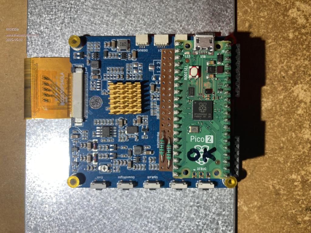

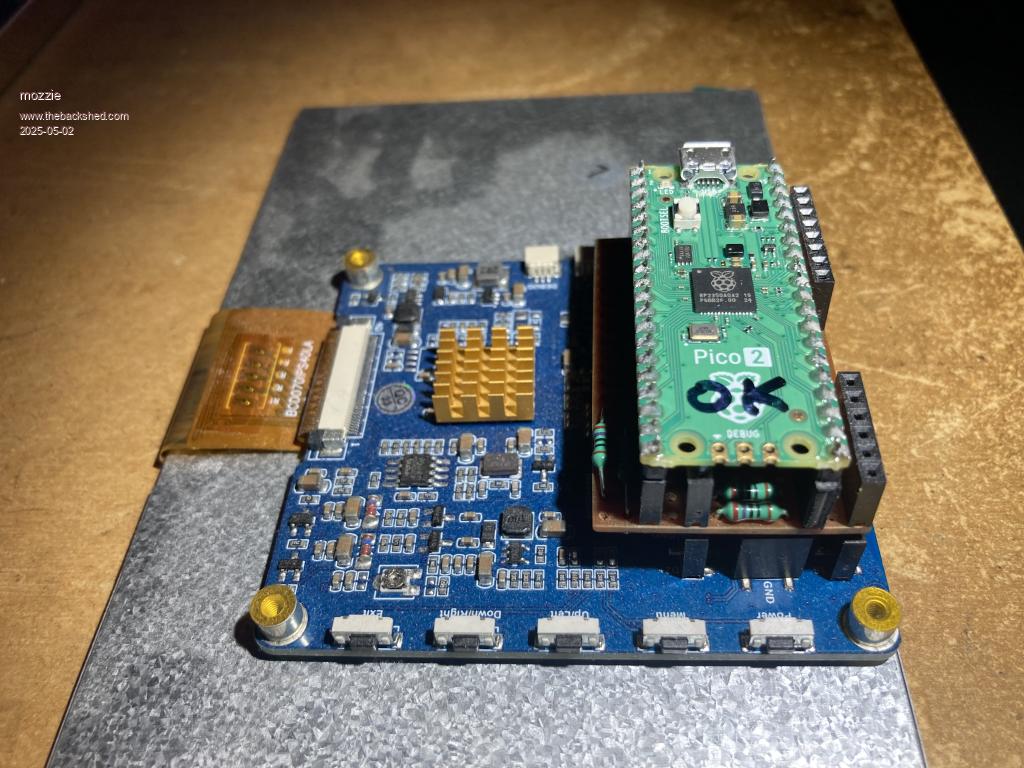

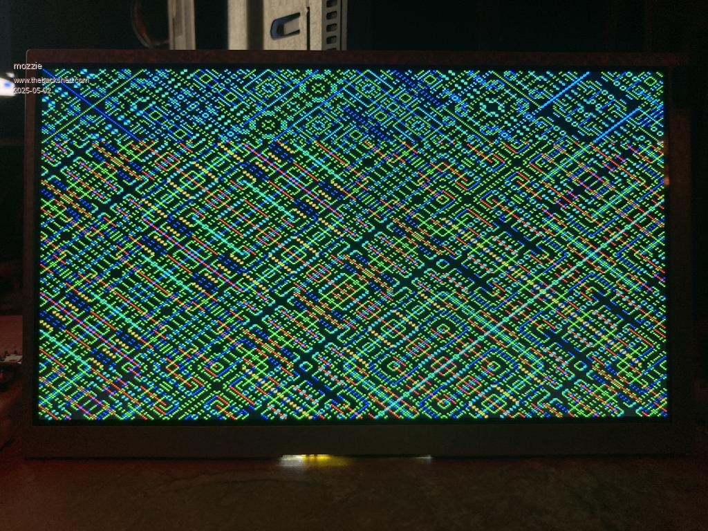

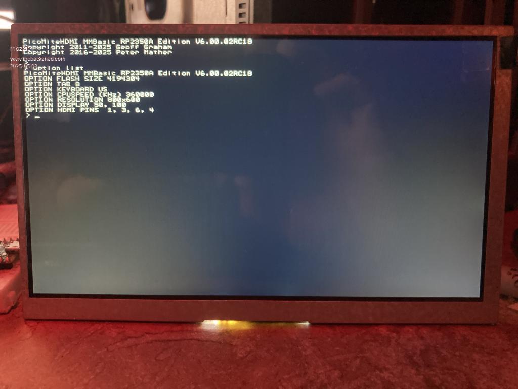

With a simple breadboard adapter these DVI screens work very well, the native 1024 x 600 resolution is a pain but they scale to whatever you drive them with.
Can confirm 640x480,800x600,1024x768 and 1280x720 all work fine, haven't tried the others yet.
Photos don't do the real thing justice, this is the 7" version.

Posted: 02:45am 02 May 2025
G'day,
See below for... well... ummm... a diagram...
You loose GP8,9,10,11 on the PICO side and GP16,17,18,19 on the DVI side using veroboard.
These could be connected with jumpers of course with a bit of juggling.
Use option HDMI PINS 1,3,6,4 if you do it this way.
Also tested 720x400 and 848x480 resolution and can confirm they work as widescreen modes.

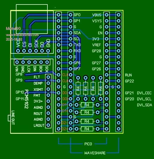

I'm just having a play with a design. I'm wondering if I can fit an audio module on too....
Fairly early days.

Posts: 9281
Posted: 01:35pm 02 May 2025
So far...

I'm not far off now. I've added some GPIO pins and a reset button. Mostly tidying up now.

G'day,
A couple more observations
The 7" display drags:
0.5A with backlight at MIN
0.9A with backlight at MID
1.5A with backlight at MAX
So might be a good idea to power via the USB-C on board.
The 5V VBUS is not powered so USB firmware will be a problem.
The Waveshare schematic is not much help.
The controller on the board is a RTD2281
IanT, Hope you survived the baby sitting adventure...

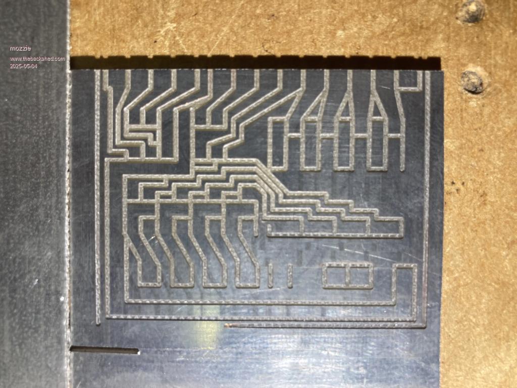

There is a design in the "to do" list however I cut boards from CAD with an engraving machine (2hr turnaround   ) so hopefully Micks will work for you.

Posts: 9281
Posted: 03:54pm 02 May 2025
PS2 not on board at the moment. You could connect one to the GPIO pins though. I'm not sure I'd want to hang a keyboard cable off the piggyback board.
I've just suspended a mini RTC over the top of the uSD card socket. :)
I'm picking up 5V from the Waveshare VBUS connection and feeding it into VSYS via a Schottky diode on the Pico. The Waveshare can power the Pico but not vice versa. The Pico can then be programmed using it's own USB connection, which may not be able to supply the current as it's not USB-C.
The circuit shows the USB-C VBUS going directly to the Pico VBUS. Not a good arrangement.

Thats interesting, if you have a diagram indicating the USB-C on the main board is connected to VBUS then there must be at least 2 versions of the main board.
There is no version info on the board here.
The schematic I have here shows no connection to VBUS and this is confirmed on the board itself, VBUS is not connected, VSYS is connected to the 5V from USB-C on main board directly.
Adding a jumper to your design (VBUS-VSYS) may solve the problem and allow USB firmware to power keyboards etc.

Posts: 9281
Posted: 07:53am 03 May 2025
You're right - I'd misread the info. It's got 5V on pin 39, intended for VSYS. That's fine. I'll feed it to VBUS via a diode. To install or update MMBasic unplug the display and connect the PC to the Pico USB as usual. You can then use the Pico's USB in host mode for a hub while you power the system from the display's USB. The diode will prevent a big current draw from the PC.
According to the circuit diagram we don't need to provide DVI resistors or I2C pullups. They are already there.
I think I'll move the UART connector to GP8/GP9. It's of more use to us. It's still COM2 anyway, which is equally inconvenient. :) There aren't many COM1 pins but I'll try to do something with GP0/GP1.

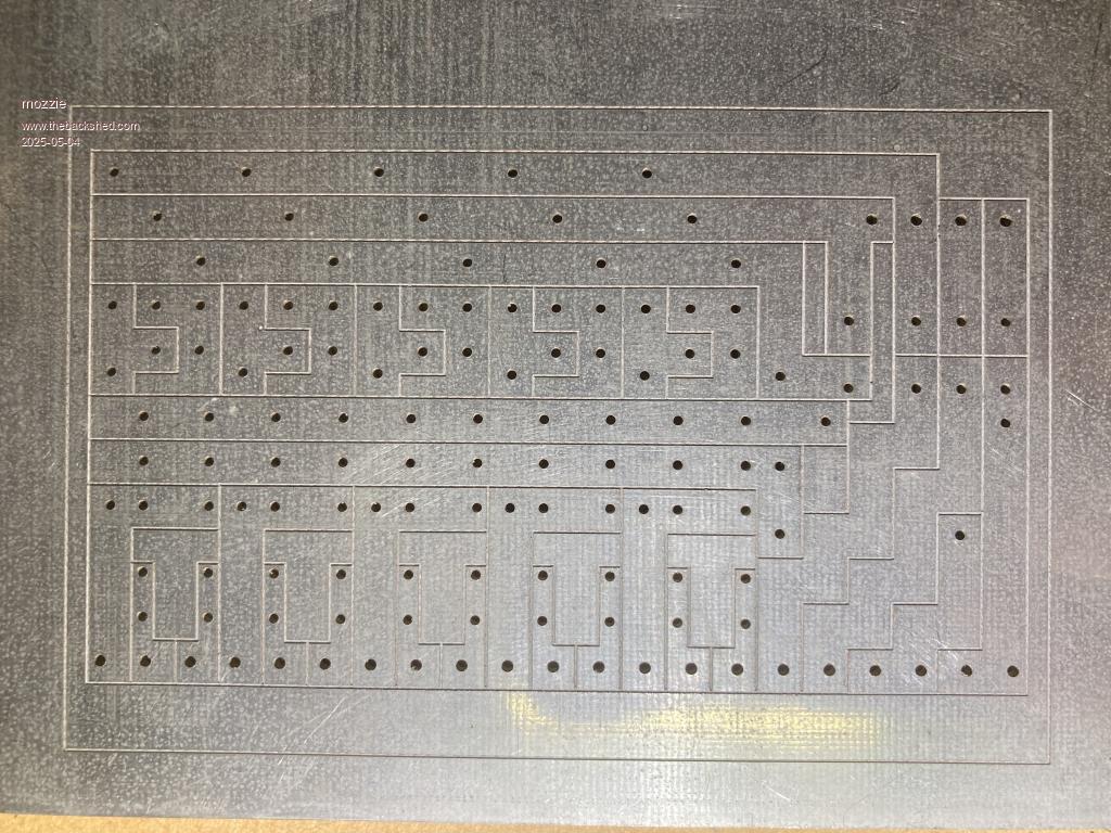

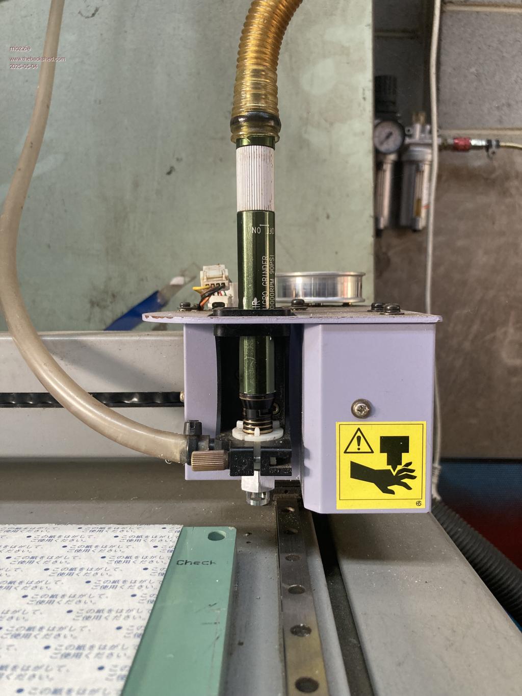

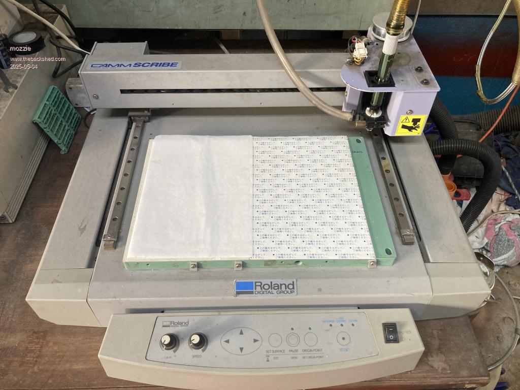

I am very lucky to have a ROLAND CAMM-Scribe CS-20 engraving machine, purchased in approx 1997. This is perfect for making front panels etc with its inbuilt electric spindle drive.
We found that a micro die grinder fits with a small machined adaptor and accepts 1/8 carbide PCB mills and drills, PCB production was now a goer
Software wise, for intricate PCB's I still use CircuitMaker / TraxMaker to draw the design and IsoPro to create the cut paths and drill files. This is all WIN98 era software.
Most of my PCB's are for power electronics / auto electrics so using CAD to draw all the holes, then lines where I dont want copper, and plot direct to the CAMM-Scribe machine, see pic below
Have been tinkered with 3D filament and resin printers as well and they are both awesome in there own way.

Relay PCB for something long ago
Oooops, cutter too wide
28 years old and still going strong
Micro Die Grinder with adaptor
Lyle.
