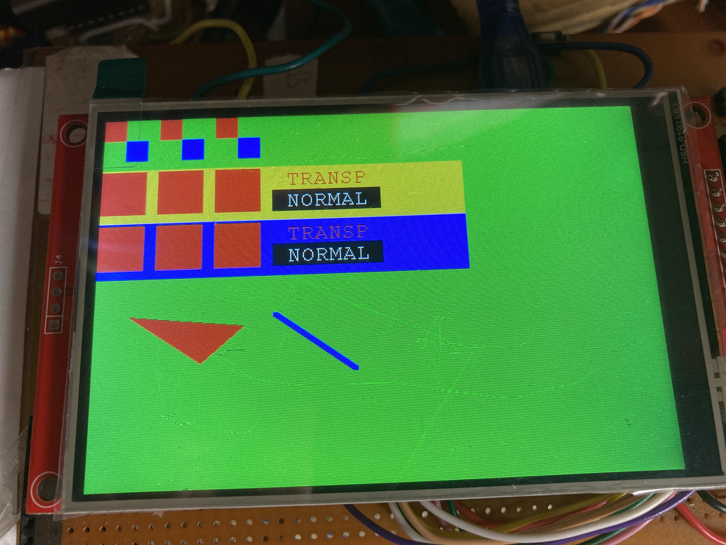

Peter,
I have an ST7796S and have sort of got it going on the Armmite F4.
I had to set the delay to switch back to Write mode to 5ms to get it to work.
i.e.
//#define ST7796Schangetowrite  1600
#define ST7796Schangetowrite  5000
Also BLIT READ and BLIT WRITE need a extra read in ReadBufferSPI before they work and the colour of WRITE copy is not quite correct.
On a Picomite I had to recompile with the same changes to use any read operations.
As a first step can you confirm this program behaves as expected on your ST7796S display.
i.e. Transparent text,BLIT, BLIT READ/WRITE
I will try and read out the ID of the display to see if yours is the same.
Print "st7796S Test"
CLS RGB(GREEN)
Box 100,100,40,40,,RGB(RED),RGB(RED)
Print Hex$(Pixel(1,1))
Blit READ 1,100,100,40,40
Blit WRITE 1,150,100,40,40
Blit 100,100,200,100,40,40
Print Hex$(Pixel(121,125))
Print Hex$(Pixel(171,125))
Print Hex$(Pixel(221,125))
Text 300,150,"HELLO"
Text 300,100,"HELLO",,,,RGB(RED),-1
Timer =0
Box 0,0,10,10,1,RGB(red),RGB(red)
Box 10,10,10,10,1,RGB(BLUE),RGB(BLUE)
Print "WRITE TIME: ",Timer
Timer =0
Blit 0,0,200,200,20,20
Print "BLIT TIME: ", Timer
Timer =0
'CLS
Print " CLS TIME: ",Timer

I can get it to work reliably with the following changes
The delay set to 4500
and doing a wait at the end of ReadBufferSPI.
#define ST7796Schangetowrite  4500
void ReadBufferSPI(int x1, int y1, int x2, int y2, unsigned char* p) {
if(Option.DISPLAY_TYPE==ST7796S){
int n=(x2- x1+1) * (y2- y1+1)*3;
while(N){
h=p[N-2];
l=p[N-1];
N-=2;
p[n-1]=h & 0xF8;
p[n-2]=((h & 0x7)<<5) | ((l & 0xE0)>>3);
p[n-3]=(l & 0x1F)<<3;
n-=3;
uSec(ST7796Schangetowrite);
ST7796Swritestate=true;
} else {
This is my test program result.
The first column is the source.
Next column is result of BLIT READ / BLIT WRITE
Next column is result of a BLIT.
Next is TEXT and Transparent Text
Triangle and LINE AA I think call ReadBufferSPI as well.
Various subtle things occur when it not right.
e.g. BLIT and BLIT READ/WRITE can give incorrect colours.
It seems to be correct with the two changes above.
Maybe its worth printing out the chip ID and see if its different from yours.
The test code is below.

Hi Peter,
I think I have stumbled on the solution for not requiring the delay.
On the Armmite I have it working with #define ST7796Schangetowrite  1
i.e. 1 uSec. I have not pulled out all the code for the delay but I suspect its not need at all.
P.S. All delay code removed and its still good!
    also removed from Picomite RC23 and recompiled. All good.
The fix is to bypass D1 in series with CS on the board as covered in the post below.
I added jumper J1 (for 3.3v) as well at the same time so not 100% sure which fixed it, but suspect its the D1 bypass.
Extract from post.....
Some ST7796 (and ILI9486) displays have a diode inline with the TFT chip select. This is a board design error as there is nothing the other side of the diode to pull the TFT chip select high. If there are other devices on the SPI bus, such as a touch controller then this diode is likely to cause problems.
It would affect how long before CS wanders to the high state, so we needed a delay to ensure CS went high after the read, before it was pulled low again on a write.
Link to solution
Edited 2025-05-19 14:41 by disco4now
Footnote added 2025-05-19 15:55 by disco4now
From the datasheet
8.4.2.2 Read Sequence
The read mode of the interface means that the micro controller reads register value from the driver. To achieve read function, the micro controller first has to send a command (read ID or register command) and then the following byte is transmitted in the opposite direction. After that CSX is required to go to high before a
new command is send

OPTION LCDPANEL ST7796S, PORTRAIT,GP15,GP14,GP13,GP7
OPTION TOUCH GP12,GP11
GUI CALIBRATE 1, 154, 3980, 863, -1279
OPTION SDCARD GP17
OPTION RTC AUTO ENABLE
> gui test lcdpanel
> gui test touch
> RUN
ST7796S Test by disco4now 19-05-2025
F80000  RED F80000
F80000
1CC0    GREEN FC00
1CC0
F80000  BLUE F8
F80000
F80000
F80000  BLUE F8
F80000
F80000
F80000  BLUE F8
F80000
F80000
F80000
1CC0
1CC0
F80000
1CC0
WRITE TIME:      0.684
1CC0
F80000
BLIT TIME:       16.948
CLS TIME:       0.104
Using Peter's last .uf2
