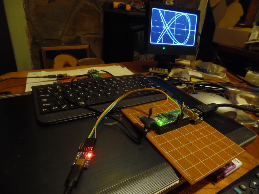

ok the first try which I tested with molex type male to female, The idea was wires under the board but just testing and isn't it amazing you can use molex like this to test and it works.  bubble universe running
it's not a bad dvi board Mick. I just want more people to use mmbhasic but not get cocky or it get rocky

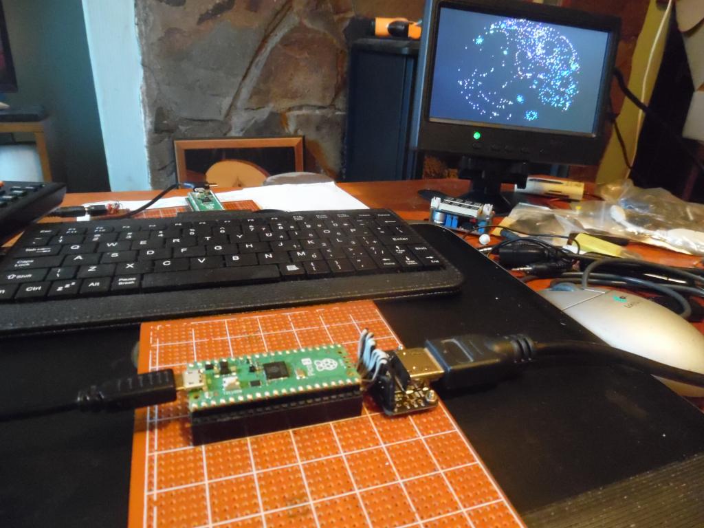

Posts: 2807
Posted: 07:44pm 12 Jun 2025
it looks tidier than before but not fun wiring/ add usb to ttl and sd card reader next.
no joining links between strip board tracks yet.

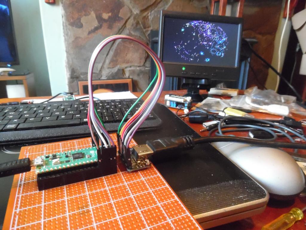

Posts: 2807
Posted: 08:26pm 12 Jun 2025
a point is hdmi isn't as fussy as some say. this is first try at using flying leads and the leads from dvi to gp pins I haven't have not cut all the extra unused tracks and the capacitance between them yet.
using ribbon cable is capacitance between leads but is common. maybe it's accounted for
Posts: 9241
Posted: 09:19pm 12 Jun 2025
To know if it's ok you have to run the HDMI at the highest speeds, not necessarily the ones that that monitor can handle. In other words, you need a known good design to see what the maximum speed is that your monitor will work with then test it using the knitted wires system. Even then, unless you reached the top speed you can't really say that the rats nest works properly.

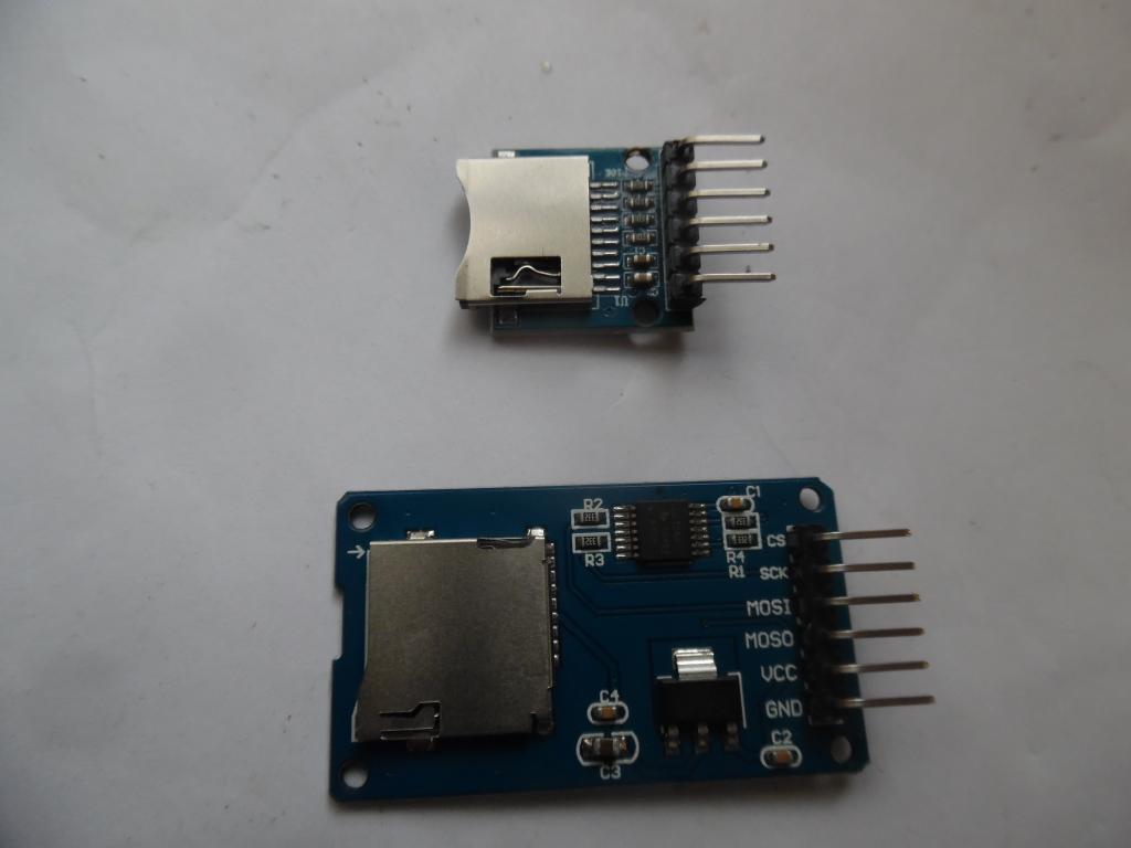

got a few sd card readers, latest 3V so use pico 3.3V out or usb to ttl 3v out?

Posted: 07:22am 13 Jun 2025
SD card sockets can't have the built in level shifters. They convert the signals to 5V, which is no use for the Pico. They are usually sold as being for the Arduino. SD cards are all 3V3 and the Pico needs a direct connection. Avoid any card modules with components on them with one exception that I know of. That one is the one I call the "inverted" module because it always used to be sold with ready soldered pins on the same side as the socket, although you can get it without the pins now. That one has decoupling capacitors and pullup resistors on it but it works very well indeed.

2 sd  card readers, one looks passive and meeds 3.3V, the other looks like it got a reg so probably needs 5V
never had problems with sd card readers before. used the manual suggested settings

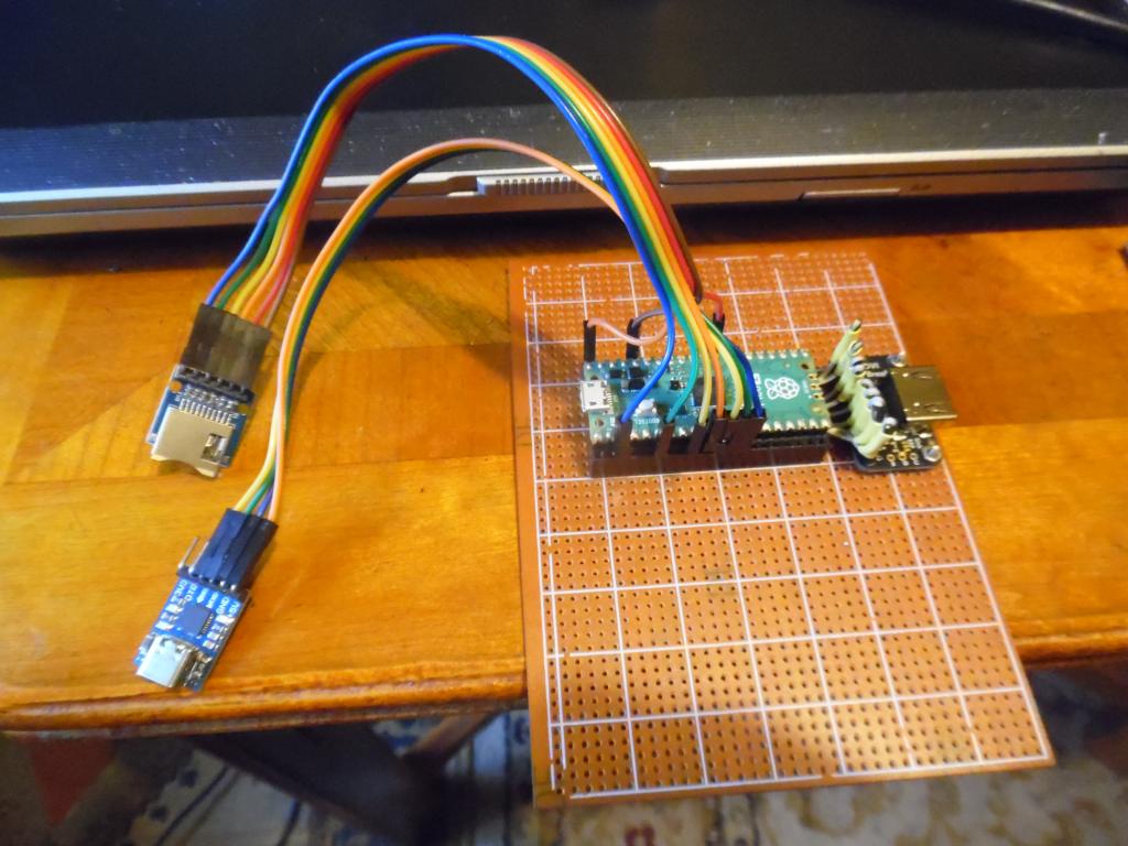

Posts: 2807
Posted: 06:36pm 13 Jun 2025
looking  in the manual is this correct please?
card pins
gnd
miso-----GP4
clk------GP6
mosi-----GP7
cs-------GP22
3v3--- from pico or usb to ttl
then use OPTION SDCARD GP22,GP6,GP7,GP4
haven't tried cos only 6 wires I could mess up.
Posts: 9241
Posted: 06:51pm 13 Jun 2025
The top module will work. The bottom one might work, might not or might be touch and go, depending. :)  It's intended for a 5V supply. The voltage regulator won't regulate if you power it at 3V3 (not enough voltage across it) and the level shifter might be marginal because of that.
All SD cards are 3V3. They work fine when fed from the Pico. You can probably use the socket in the bottom picture by powering it from 5V rather than 3V3. Take the supply from VSYS.
For testing purposes you can use any GPIO pins for a SD card providing you specify them all in OPTION SDCARD.
Edited 2025-06-14 04:54 by Mixtel90
Posts: 2807
Posted: 07:16pm 13 Jun 2025
got this from passive card reader so think it's ok... now to wire it as all this was test wiring then audio out, yawn

this was with "the top one" Mick but I gonna try the 5 V? card cos I used them dim problemo... just to test. it was initially an easy diy plan but take it back it's not easy.
soldering is worse than smoking
