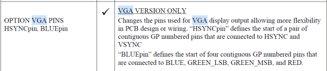

Posted: 06:40pm 07 Feb 2026
Per the Picomite manual for setting alternate VGA pins:
Would this apply to the upper pins of this module, e.g., GP27, 28, 29, 30 for blue, green1, green2, and red?

Posts: 9238
Posted: 06:50pm 07 Feb 2026
I think I might have tried it at some point. It will probably work. AFAIK there's nothing special about the VGA pins apart from the fact that they have to be consecutive. There's no special internal hardware like there is for DVI/HDMI.
