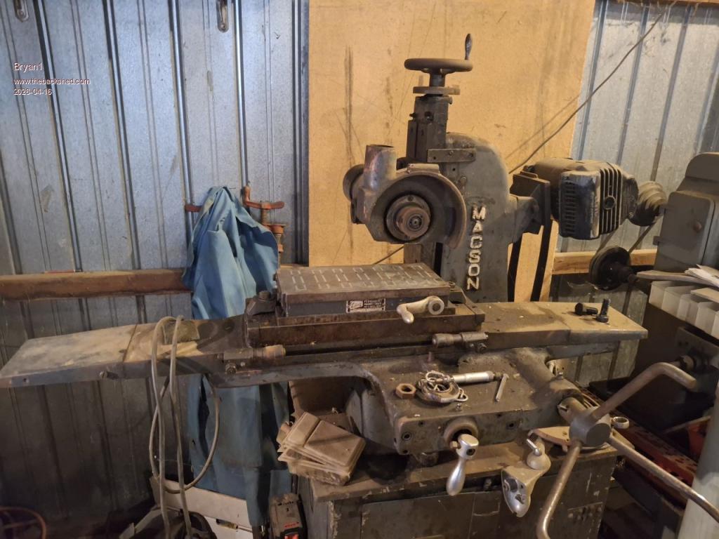

Ok Guy's the whole point of this project is to make a state machine so I can run my old Macson surface grinder.
Now the inherent problem is with the Z axis on this machine where the lead screw has a heap of backlash and when setting the grinding wheel doing 2,000 RPM it tends to jump and I have already broken a grinding wheel trying to use this machine.
This is where a ball screw can come into play for the Z axis so if needed a step by step can set the cut then the DRO on the screen can be set to zero where the predetermined cut is done.
I do have a 2 pole 3 phase motor for this project and a Delta VFD so the motor can run off single phase and the best part the Delta VFD does have a serial interface where the hertz can be changed so the speed once calibrated can be dialed in using the G-code.
Now the X axis rack and pinion drive and as it's only going back and forth I can machine the stepper mount off the original handle and fabricate up the securing mount for the stepper motor.
The Y axis in operation is going to increment in steps every forward pass depending on the width of the grinding wheel.

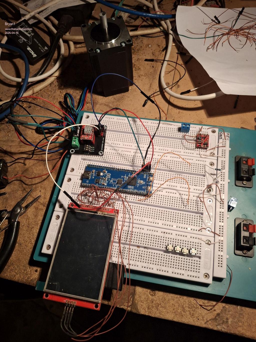

Now here is a pic of my test setup
For now the 3.5" touch screen can do while the code is built up and as there are so many spare pins I do think a 9" touchscreen in 16 bit mode as reading in the manual today 16 bit can be done. I do need to order more dupoint cables for this project so no rush as I have been thinking about this project for a long time.

Phonix back in the day when I worked as a heavy machinist I was starting my 30' planer motor when I went from star to delta a arc went over the the planer bed and one guy walking by copped it full on and he was gone.That 200 Kw motor was toast and that planer was never run again.
Now as the steppers I have here are 2.4 Nm I don't think they will handle the current needed to run this surface grinder so I am thinking of getting somemore DM556 micro stepper modules off ebay.
I did look at my old code in MMEdit that was still there and I'm sure you will remember that code Harm gave did run the stepper on my cnc.
The problem is when I did that code GP numbers wern't needed so I do think this can done on 2040 without the new stepper code

You have likely figured this out already but you don't need to set the GPIO pins to DOUT first, let the STEPPER AXIS command do it for you. Should stop the error messages.

As this surface grinder is fully manual my idea of automating it does make sense so the grinder is more efficient.
Now going a damper on the Z axis could work but I already have a ball screw that is suitable to fit. I got this off an old Hercus cnc lathe and length wise it will fit easily.

  Quote  I have declared X position as 0 but the software is homing the axis in an endless loop
Here is your endless loop:-
do
  RunStepper
loop
Sub RunStepper is being called endlessly.
Maybe try without Do and Loop.
Edited 2026-04-17 16:03 by phil99

Ok did the Stepper Limits X, 0, 200 also the same for Y and Z now when I run it got the error Y axis wasn't set so commented Y and Z out.
Now when I removed the do loop
Stepper initialized - 100KHz timer active
Warning: Soft limits not configured. Use STEPPER LIMITS to set working area.
Hardware limit switches configured
X axis limits: 0.000 to 200.000 mm (0 to 160000 steps)
Stepper armed - executing buffered commands]
Then it goes straight to the prompt so it exits the stepper program
Now with the Do Loop
[44] Stepper gc g1 x0 f100
Error : G-code buffer full
Now I did put a Stepper Clear in so the buffer was reset
OPTION EXPLICIT
On error skip
Stepper close
Stepper Init 0.05, 150, GP22
'setpin GP27, Dout
'setpin GP25, dout
'setpin gp26, dout
'const dir = "GP25"
'const steppin = "GP27"
'const enable = "GP26"
const E_Stop = "GP22"
STEPPER HWLimits GP23, GP21, GP20, GP19, GP18, GP17
Stepper Axis X, GP27, GP25, GP26, 0, 800, 100, 100
Stepper limits X, 0, 200
'Stepper Limits Y, 0, 200
'Stepper Limits Z, 0, 200
Stepper Position X, 0
Stepper run 1
Stepper Clear
'Stepper Position Home
do
RunStepper
loop
Sub RunStepper
'Stepper gc g28 x0 f100
Stepper gc g1 x100 f100
end sub
Edited 2026-04-17 16:42 by Bryan1
PhenixRising
Joined: 07/11/2023
Posts: 2100
Posted: 07:07am 17 Apr 2026
  Bryan1 said  Ok a pinch as I'll just put the leadscrew in my lathe and drill a 8mm hole where a couple of grub screws can be used for the drive. Then a simple mount can be made to clamp the stepper.
But with a coupling, correct? If not, the motor bearings will have a very short life-span.
