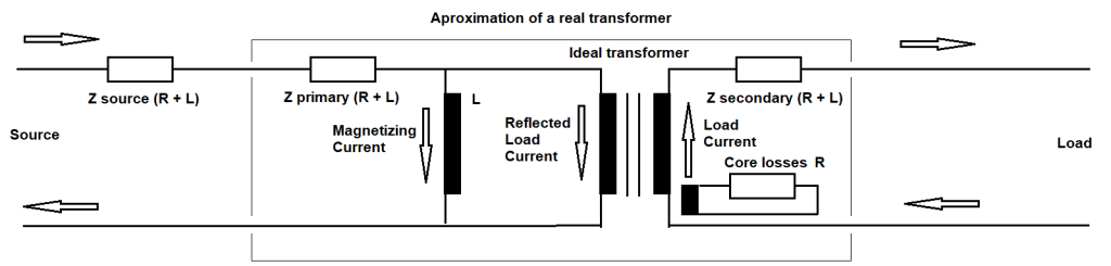

The two components of the transformer primary current can be seen better if you view a real transformer as an ideal lossless transformer with an inductor across the primary (assuming its series resistance and inductance are small).
Then the inductor current is the transformer magnetizing current and the primary current is simply the load current multiplied by the turns ratio.
The load determines what that current is, you can't change it without changing the output voltage. If you reduce the drive to one half cycle you will get a distorted voltage waveform.
Easier to see if the ideal transformer is 1:1. Vs = Vp and Ip = Is, You could replace it with a pair of wires. The only thing left is the parallel inductor.
All you need to do is ensure there is no DC through the inductor by adjusting the PWM a small amount.
The low impedance of the H-bridge will give the load whatever current it demands. The PWM adjustments above mean a non-linear load will produce a little voltage distortion but you just have to put up with that.
The only catch is in the real transformer you can't directly measure the inductor (magnetizing) current, making correcting it tricky.

This feels a bit like poking a hornets nest but I feel the need to look deeper into what is going on in our inverters
The inverter power stage has impedance - it is not an ideal drive, the transformer has impedance it is not an ideal transformer, a half wave load is not an ideal load, sensing from the output voltage load winding is not the ideal way to sense. I find that trying to relate all this to an ideal transformer etc is not really very helpful in finding a solution.
In laymans terms when a half wave load is connected to our inverter, yes the current drawn is reflected back to the primary. But due to the secondary impedance and to a much lesser effect the primary impedance and the impedance of the supply battery through the power stage & choke/s we have an issue.
The PWM% that was being used up to the point of driving that half wave load is now not enough to drive the output winding to the same peak value that occurred just prior to the connection of the half wave load. The reason for the droop is due to the addition of all the series impedances.
The net result is the toroids primary magnetising current is less for the loaded half cycle due to the losses involved.  However the unloaded next 180 degree waveform is a totally different story as its magnetising current will be the same as before the half wave load was connected - the series impedances have essentially no effect on the unloaded 180° as only magnetising current is being drawn for that unloaded half cycle.
If we now consider if feedback is being used and applied to the PWM generator it will cause a higher PWM% drive due to the reduced average output voltage, caused mainly due to the loaded & reduced peak half wave.  The unloaded second 180 degrees will then have an even higher level of magnetising current for its next half cycle.
So it is my contention that the asymmetrical magnetising drive will drive the transformer towards saturation (on the unloaded 180 degrees) after a few cycles.

  phil99 said  Then the inductor current is the transformer magnetizing current and the primary current is simply the load current multiplied by the turns ratio
Er no, over simplified, the primary magnetising current 180° sections are not equal for a large half wave load due to the impedance issues outlined above.

The net flux in the core (AC and DC) is the difference between the fluxes produced by  both primary and secondary Amp-Turns, plus the magnetizing current.
I hope this diagram better shows what I was trying to describe before. In that I left out all the series impedances as they are small compared to the load impedance (after factoring in the turns ratio) but have included them here for completeness.

I like the new diagram much better, I think I am a more visual person.
The idea of a current sensor with two windings equal to the turns ratio of the toroid sounds like a good plan. ie Toroid 8:1 then 1 turn on primary side 8T on secondary side. For a balanced load the magnetising current needs to be removed or ignored by the anti-saturation circuit.
If an LEM or similar solid state sensor is used, by using the single sensor dual winding, I would expect the usual annoying drift and offset issues of solid state sensors would be largely ignored/cancelled as they are using a common sensor.
