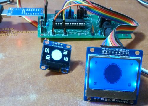

I've completed a fully working version of the graphics library including drivers supporting both the SSSD1306 OLED and the Nokia 5110 displays. I'm using cFunctions to optimise some of the critical code areas and I think the speed achieved now is fully usable for most applications. Obviously more of the basic could be converted into cFunctions to speed it up further and I haven't yet tackled accessing the PIC device registers from C. The downside of cFunctions is that errors typically result in a processor reset making debugging much harder than in basic alone.
I'll attach the code and Cfunction source below but first I wanted to thank Geoff (what you have achieved is extraordinary!),Jim Hiley (mm-edit) and Peter Carnegie (cFuncgen and the tutorial) for creating a great development environment for embedded computing. I've used a fair range of the options out there, picaxe, arduino, Texas Instruments Tiva, etc. but the micromite mk2 together with the cfunction capability is just superb.
The development process I've used for the code is to have mm-edit, notepad++, mplabx, and cFuncgen all open on the computer. The basic code development is done in mm-edit, cfunctions are developed in mplabx, once compiled press the refresh button on cfuncgen and it reads in the new elf file and then press the make cfunction button. Notepad++ immediately recognises that the cfunction basic file has changed and reloads it, then it can be copied and pasted into mm-edit. Using this process a change to a cfunction and retest on the micromite can be done in less than a minute. If cFuncgen doesn't work for you, re-install XC32 and make sure you tick the "add-to-path" box.
There is one common issue with the SSD1306 OLED boards. Many of the cheap boards (even the 4 pin ones) say they are i2c but don't work properly. They do not send the required "ACK" when receiving data. The Arduino community have solved this by producing an i2c library that works without the "ACK" but this is a poor solution. There is however an easy hardware fix. A blob of solder between pins 19 and 20 on the cable from the display where is connects to its PCB connects DIN and DOUT which is one of the requirements for the SSD1306 controller to work properly in i2c mode - check your display and mod if required!!!
My code is a port from the Adafruit graphics library - thanks to them for making their code available. It uses two 128 element 64-bit integer arrays "screen" and "displayed" to map the actual display. The graphics routines modify the "screen" array in the micromite memory and then the "refresh" command writes to the actual display and updates the "displayed" array. In this way the "refresh" command can compare the arrays and optimise what it need to write. I'm using a cFunction to do this compare and this function not only returns the x,y coordinates of the screen element to be updated but also whether a cursor positioning instruction is needed (quite pleased with this )
There are only 6 display specific subroutines required to integrate another type of display: initialise, sendcommand, sendchar, refresh, clearscreen, and cursor position. Both the Nokia5110 and the SSD1306 take an 8-bit data input and write it as a vertical block of pixels within a display row. The Nokia is 48 pixels high and 84 wide so there are 6 (48/8) rows of 84 data bytes required to write the full screen. The SSD1306 has 8 rows with 128 positions on each.
The text routines in the library allow the text to be position in any orientation at any position on the display unconstrained by the row structure. A faster text mechanism could be produced that only wrote within a single row.
I've tested this fairly thoroughly but please let me have details of any bugs I've missed. During the course of this development I've found only one trivial problem in the MK2 code despite it being beta and one out-and-out bug in the XC32 C compiler (shifts on long long variables don't cross the "long" boundary)
The routines support display rotation (separate from text rotation), however, the optimisation of the text functions when the character size is greater than normal do not support a rotated display so text write will be slower if the screen orientation is not "normal". This can be solved but is yet more coding and one has to draw a line somewhere!
If this library is useful I'm happy to act as a central clearing station for any additional cFunctions upgrades or any other additional functions.
Best Regards
Peter
NB Just noticed the board software had corrupted the C file - something to do with square brackets so I've attached it as a zip. Any problems with the basic let me know and I'll do the same

Posts: 11905
Posted: 02:26am 17 Nov 2014
BUG
In two subroutines drawCircleHelper and drawLine I have put the LOCAL definition of the return from the drawpixel cFunction inside a conditional statement so depending how they get called there will be a "not-defined" bug at run time. These definitions should be moved to a simple declaration "LOCAL dp" at the top of the two subroutines.
This happened when I was changing drawpixel from a basic subroutine without a return to a cFunction - sorry
Best Regards

Posts: 11905
Posted: 07:42am 24 Nov 2014
Another new version. The variables and functions are now fully typed so it will run whatever OPTION DEFAULT is specified.
The font array is replaced by a data Cfunction - many thanks to Peter Carnegie (G8JCF) for sorting out how to do this. This has saved significant space.
Also variable, subroutine and function names have been shortened to save space.
