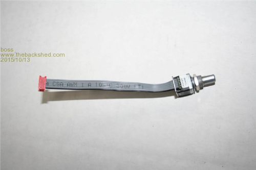

another choice is to use an optical encoder. I found this one (Grayhill with push button) on ebay for ~$10 new.

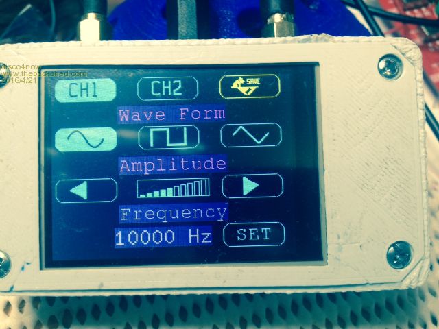

I ordered one of the AD9833 modules above sometime ago and started to write a GUI for it. I was removing the header pins to put it into a case when I made it not work by breaking some tracks.
So I ordered another one and then also managed to repair the first one.
So I updated the GUI to make a dual channel signal generator.
It looks like this.
The code for an MM2 with a 320*240 screen is below. It uses all Peter's code, gets a few ideas from Parking Assist and Boat computer, and I used FontTweak to make the graphic fonts. Thanks,Peter,Geoff and Jim.
I terminate the signal output in a 50ohm resistor as its supposed to be 50ohm output impedance.
The software works without any hardware attached so it can be run to get a feel for the interface with just the MM2.
2016-04-21_131530_SignalGeneratorAD9833_v1.0.bas.zip
Gerry

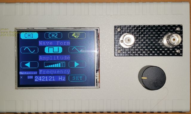

Posted: 05:32pm 24 Mar 2017
Hi
I had just finished my dual AD9833 Function generator before I saw the article in SC. So I thought I would share it.
My version uses Micks BackPack170 Micks BackPack170
I used the software posted by Disco4Now and added a rotary encoder and some code to use the encoder. The encoder has a built in switch so a quick press sets the multiplier from x1 to x10000 in 4 steps and longer press (+-2 seconds) updates the AD9833 with the new frequency.
Pic of the completed unit below
I will post the code if anybody is interested.
Jman

Joined: 12/06/2011
Posts: 711
Posted: 10:00pm 25 Mar 2017
Hi
The rotary encoder is an Ebay special from here Rotary encoder
Any cheap rotary encoder will do I added .01uf caps from the encoder pins to ground and a .1uf to ground for the switch to assist with debounce
Program is attached with my modification's
Credit to disco4now for the original program
Jman

Even after I cleaned it with a CR + Schmitts, It does work but it is very "coarse" and sometimes it still can't tell which way it's being rotated (which is probably timing)...
I always intended to use some "inverse LOG" function or something like it to smooth out the increment based on the time... just never got round to it as I tend to "work-around" it for now.
we'll give this code a trip and see if it helps.Edited by CaptainBoing 2017-03-27
