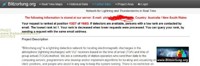

Phil23
Joined: 27/03/2016
Posts: 1667
Posted: 10:59am 03 May 2017
Hi Grog & Lew,
There's another Lightning monitoring product that's very interesting.
The Blitzortung Project. Really good data, but you can't just "get one".
http://en.blitzortung.org
You have to jump in the hardware queue & wait & see what happens.
Could be a good thing to have installed in it RicTech office though.
Help improve accuracy for the region.
Phil23
Joined: 27/03/2016
Posts: 1667
Posted: 11:15am 03 May 2017
  lew247 said  or THIS module?
They are both based on the AS3935
There is code available for the Arduino and Mikrobasic but I've no idea how to "translate" them into MMBasic
Hmm,
Had a quick look at the code, but it's out of my skill set.
I'd need to better understand SPI or I2C first.
But looks like an interesting device.
Anyone interested in playing with it?
If I can get a few commitments to trying it out, I might grab one & put it on a MM that members can log into externally for a play.
Any takers?
Phil.
