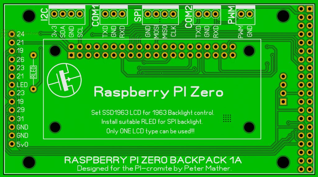

I've been playing with this idea a little tonight. I have designed a Pi-zero and a standard PI footprint, and have been playing with these along with LCD footprints.
The standard PI might need to be dropped on this backpack board idea. The PI-Zero fits beautifully with a 2.8" SPI LCD, on a board of the same size as the 2.8" LCD.
The standard-size PI is too big to fit as a piggy-back arrangement with any LCD smaller then 4" or so.
The Pi-Zero is a perfect match though, as it is small and SO CHEAP, that this makes it the most logical choice - for SPI LCD's. The PI-Zero and a 2.8" SPI LCD give you a complete system with touch and advanced GUI controls for fifteen bucks or so, which is very impressive. So, at this stage, I am dropping off the standard-size PI footprint, and the piggy-back board will concentrate on the PI-zero module.
I am designing for either a 2.8" LCD with ILI9341, or a 3.2" LCD with SSD1963 - you can use either type on the same board(but not together).
EDIT: Seems there is no 3.2" SSD1963 LCD - all the 3.2's seem to be SPI with the 40-pin header - but they are still on the SPI port with the SD card. I will design the board to suit the 2.8" LCD directly, but able to be plugged onto any standard SSD1963 parallel interface TFT, that way, you can pick and choose, but it keeps the PCB small, which keeps the cost down.Edited by Grogster 2017-06-12

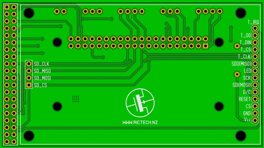

Posts: 10116
Posted: 11:29pm 11 Jun 2017
Well, here you go led-bloon:
Will that do?
EDIT - Forgot to mention:
SPI LCD D/C = Pin 29
SPI LCD RST = Pin 31 (same as 1963)
TOUCH CS = Pin 26
TOUCH IRQ = Pin 24
SD CS = Pin 33
1963 RD = Pin 36
H/W PWM = Pin 12
All other pins are as already stated. You can use either a 2.8" SPI LCD with touch, or ANY supported SSD1963 LCD with SPI touch and SD card. For the latter, you don't fit the SPI LCD, and instead plug the PI-zero board directly onto the pin-header on the 1963 LCD module of choice. You would need some self-adhesive PCB supports for the arse-end of the PI-zero board, to stop it flapping around on the LCD header, but that is dead-easy to do.Edited by Grogster 2017-06-13

led-bloon
Joined: 21/12/2014
Posts: 210
Posted: 12:43am 14 Jun 2017
@Grogs very nice .. but does it come in red?
@Mick - all I can say is that the displays are relatively cheap (ILI9341
& SSD1963) and the code is written for them .. sounds pretty good to me.

led-bloon
Joined: 21/12/2014
Posts: 210
Posted: 02:18pm 14 Jun 2017
Just checking the pins in use now .. would like to see any
pins not connected going to a row of vias for future connection
(possibly at the bottom of the board?)
Also, any room for a "click" board adapter area?
Miss you George

Joined: 21/12/2014
Posts: 210
Posted: 02:43pm 14 Jun 2017
@Grogs
You have directly connected the CS of both LCDs to ground.
The SPI LCDs should use an output pin from the pi for CS
(not sure if SSD LCD should have a separate CS too)
Otherwise it will clash when selecting touch/SD card or anything
else on the SPI bus
Edit: My bad - NO unconnected pinsEdited by led-bloon 2017-06-16
Miss you George
Posts: 10116
Posted: 03:23pm 14 Jun 2017
You are correct about the SPI LCD CS - My mistake - will fix. 1963 LCD CS is grounded, as you will always be using that LCD if it is installed at all, but I made a boo-boo with the SPI LCD CS.
I don't think there is room for a Click socket - I will look and see, but the entire bottom edge of the PI module has to be kept clear for connectors on the PI module, so you can't put anything there, which pretty much.....
led-bloon
Joined: 21/12/2014
Posts: 210
Posted: 07:20pm 14 Jun 2017
Grogs
The SPI Header at the top of the board is pretty much wasted
as it has no CS output. Could I suggest increase header to
5 pins & using COM2 TxD doubling up as offboard SPI CS?
At least COM2 RxD could still be used for logging on a serial
line say.
I would probably mount the Pi Zero between the PCB and
the SPI LCD display (albeit upside down) and soldered in, with
adequate spacing for connectors.
I think too much to ask for a re-design or second version.
Using SPI LCD additional (spare) GPIO pins are available at the
SSD LCD header .
SSD LCD there are no spares available, but COM2/PWM/I2C can be
re-deployed.
