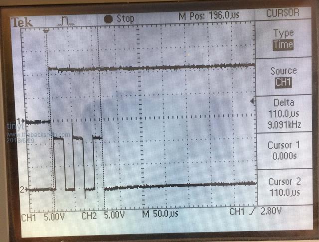

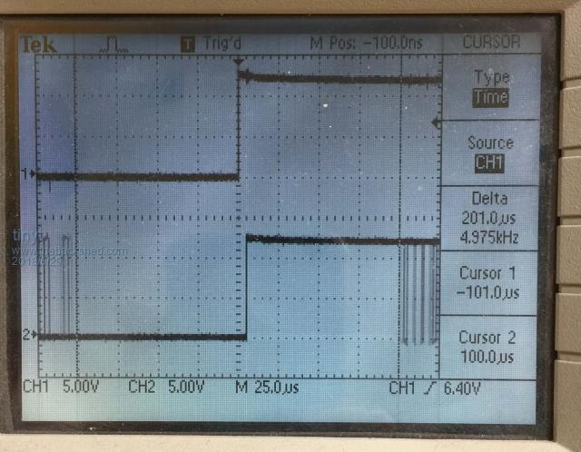

  wiseguy said   ....But certainly playing with triggering and filling the screen side to side with the whole 100uSec pre and post trigger (from the 50Hz transition) should improve what we are trying to see.
Then it will look like this.
The picture is a screen capture of moving 'bar code' because of continuous triggering. Too bad I cannot upload video clip. Still it shows absence of pulses 100usec pre/post trigger. If the TDS 220 still misses pulses in that area, I think it is time for me to junk it. I also believe that this contributes to the distortion near zero crossing. Because of the jittering 'bar code' I think I agree with poida that this asic uses code instead of programmable logic.
Also, I think I have left the impression that I am not going to use a choke. ESL problem I guess.

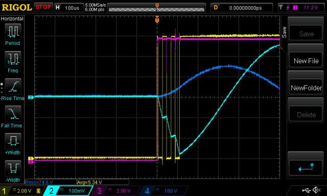

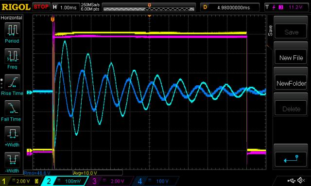

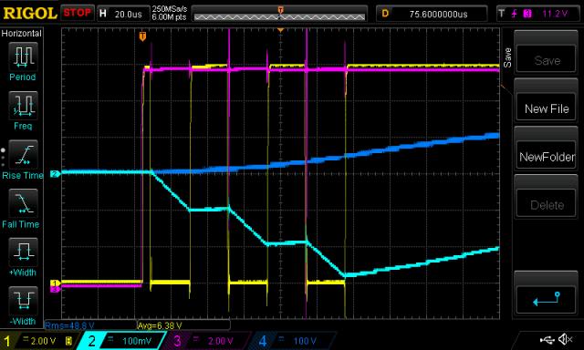

  tinyt said
And then there are these three musketeers popping only once right after power on. CH1 at Test1 and CH2 at Test4. They don't appear at the Test2 and Test3 pair. Scope is set for single trigger mode this time.
I hope somebody else can confirm/or not what I found. Note that the EGS002 I tested as received, is jumpered for 50 Hz and 1.5 usec dead time which I confirmed between Test1 and Test2 outputs. It also has cross-conduction prevention transistors. I will see if I can check right at the EG8010 outputs.
I can confirm this.
I apply 12V to the board, which brings up the 5V supply quite soon afterwards and
then this:
Yellow 24Khz pwm gate drive
Pink 50Hz gate drive
Light Blue primary current (10 A RMS/div)
Dark Blue, AC output on secondary.
zoomed in, 20 usec/div
and back a bit, showing the ringing of the toriod/inductor/capacitor combo
that results from this huge pulse of energy.
The ringing is an audible click too. Every time I apply power I get the click.
It seems to be about 825Hz. hmmm
But I get a lovely smooth AC output waveform from this, so I'm happy.
This also shows the inductor behaviour very clearly, you can see the current
rise/fall linearly during each switch event (i.e. V1 to battery, V2 to ground), and then current drops slowly when the switch is open (i.e. connecting the primary winding ( V1 ) to ground and V2 to ground).

  poida said
I can confirm this.
then this:
Thanks poida for confirming. If there is a huge pulse of energy created by the switching of the mosfets at this time, maybe it is over stressing the mosfets leading to their eventual failure, just guessing. And even if it does not (30A peak is shown), maybe this condition should be addressed.Edited by tinyt 2018-07-04

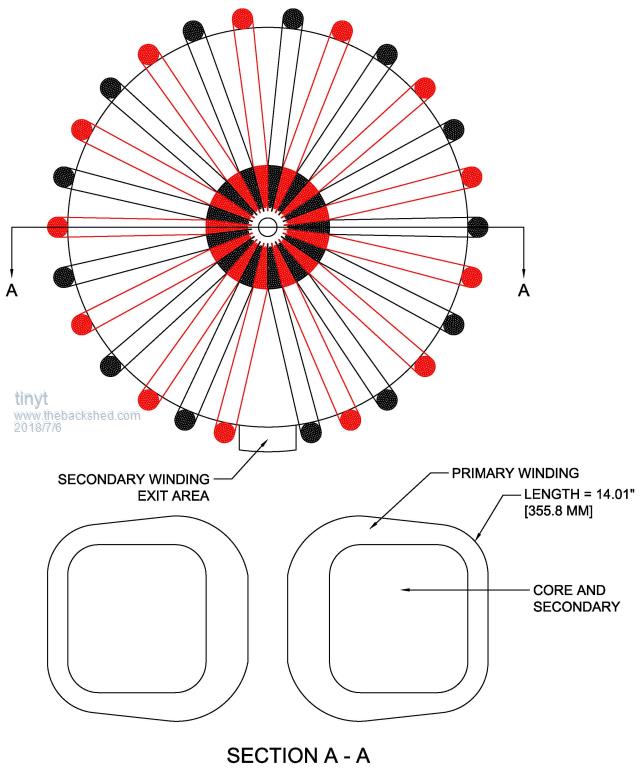

Posted: 04:54pm 05 Jul 2018
A sketch of my impossible primary winding approach (the inside is similar to a motor stator). The two colors is just to visually differentiate adjacent turns. The 355.8 mm turn length is estimate of maximum possible for a wire strand. Still making my fixtures, tools, etc. (plus doing a lot of prayers).
Edited by tinyt 2018-07-07

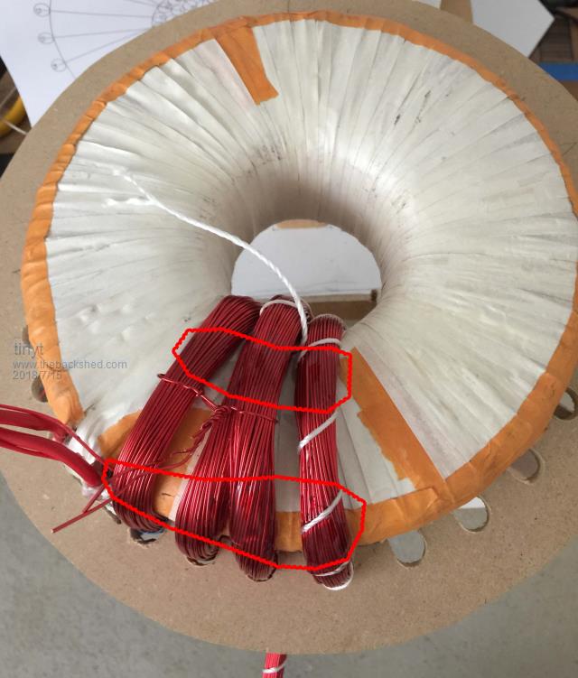

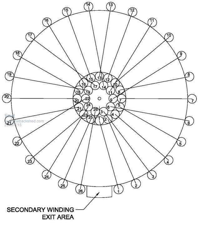

Posted: 04:17pm 14 Jul 2018
That wedge shaped strand bundle is just an impossible dream.
Plan B:
Winding two at a time and applying 5 minute epoxy at the areas shown to keep the winding in place.
The plan is after all turns are done, cut and remove the strings, then force a wooden rod wrapped with poly thru the center and use boat epoxy to keep everything in place.
I used 84 instead of 86 strands and still it doesn't look like it is going to fit. But there is no turning back now. I should have used a flexible toroid. Edited by tinyt 2018-07-16
Posted: 04:39pm 14 Jul 2018
It might be easier to go around the toroid once putting on just one layer first, as many turns as will fit around the inside of the hole, probably fifteen or sixteen turns.
Then fit a second layer over the top of that doing a second lap around the toroid.
Work the turns that go around the outside so they all look evenly spaced for aesthetics. There will be many lumpy cross overs, but there is nothing you can really do about that.
tinyt
Joined: 12/11/2017
Posts: 564
Posted: 05:17pm 14 Jul 2018
  Warpspeed said   It might be easier to go around the toroid once putting on just one layer first, as many turns as will fit around the inside of the hole, probably fifteen or sixteen turns.
Man, this old man has completely forgotten about that.
Posted: 08:56am 15 Jul 2018
Tinyt, yours is the most elaborate toroid rebuild I have yet seen, right down to the slotted MDF disk to keep the outside wires evenly spaced .
When you push the completed wire layer in place through the hole, use something softish and slippery. The wire enamel is tough but it does have a limit before it abrades and we definitely do not want that happening.
I used thick wall PVC irrigation pipe, slotted and perhaps a segment cut out so it can form a smaller diameter if required.
If this is waxed well before inserting it can be left in place while epoxying and later knocked (gently!) out for the next layer.
One piece of PVC tubing served several single layers of wire, it just required another segment cut away.
