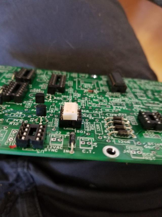

kentfielddude
Joined: 09/05/2019
Posts: 121
Posted: 06:52am 12 Jun 2019
Is this the right opto? I saw some were using single version
renewableMark
Joined: 09/12/2017
Posts: 1679
Posted: 10:24pm 12 Jun 2019
Mine had 4 pins, have you got a link or a better pic of the part?
If you got the tlp523-2 that is a 2 channel, the top channel just wont get used.
Here is some info on them.
Cheers Caveman Mark
Off grid eastern Melb

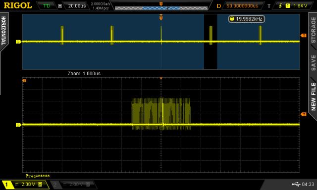

poida
Joined: 02/02/2017
Posts: 1497
Posted: 12:56am 04 Jul 2019
Mad,
I would not consider changing over to the STM32.
Firstly, there are marginal if any benefits from the point of view of the performance of the code when running. The Nano only uses about 20% of the cpu cycles to control the PWM output and run the closed loop output control. There remains approx. 80% of cpu cycles left unused. Memory use is moderate and no problem.
The Nano runs in a way that is completely determinable, which I mean to say each interrupt of the 20kHz PWM routine occurs at about the exact same time it should.
There is very little jitter, I estimate way less than 10ns.
And this is running the Nano with the bootloader enabled, which permits easy uploading of the software.
Secondly, the cost is not large, when choosing to use 2 nanos. They go for about $5 each, buy them in lots of 5 or so. This compares well with the STM32, which are also similarly cheap.
Thirdly, I like very much separating the two functions of the control board
into 2 microcontrollers. One just generates the PWM and runs a closed loop control.
It also can alter the output sine wave frequency to sync up with an external source.
The other interacts with the world and the humans. It can perform it's tasks in however long they may require. Updating LCD data can require appreciable amounts of non-interrupted time. I could not get smooth LCD updates when running it all on one cpu. The PWM interrupt upset aspects of the I2C communication codes.
Fourthly, I have looked at the STM32 closely and I like a lot of it's features.
The 32bit architecture appeals greatly. It has a lot of program memory and RAM.
It runs at 72MHz, not 16Mhz as with the Nano.
But there are aspects of the STM32 Blue pill board that are fiddly. Getting USB working, for easy programming was a pain, but it's possible and I have done it.
Interrupts do not run as jitter free as the Nano, though.
Below is a capture of the STM32, running an interrupt code that just pulses an output pin, at 20kHz. The capture is triggered on one pulse and in the lower screen shows all the occurrences of the following pulse. There is jitter in the interrupt service starting time of about +/- 1.5uS.
If I did this with the Nano, we would see only one pulse, superimposed on itself, and my oscilloscope's performance is insufficient to discriminate anything much less than about 5nS. No point in showing that capture here.
This jitter is the result of the STM32 running a bootloader that must poll the USB status registers even if the USB cable is not connected.
Programming the STM32 can be done without a bootloader of course (that's how I managed to load the bootloader in the first case!) but it's a pain.
Then you get much less jitter, down to the DSO's time resolution.
The STM's 32bit timer counters are sex on wheels, I love them. So much more timer resolution compared with the Nano. And the RAM and program size...
But in this application, the Nano brings highly predictable timing of it's events, and there are cpu cycles and memory to spare. All with a reliable bootloader.
And 5V logic. No farting about to get the USB working either.
The nanoverter board is completed and works fine. I just ordered another 10 boards and they are $6.70 AUS each, including postage. Add the 2 $5 Nanos etc.
It's not a lot of money to make a good controller.
I also looked at the ESP32 (the tiny board with onboard wifi) and it's
interrupt jitter is a lot worse. There are some parts of it's firmware that interrupt
the interrupt as it were. Not good for my purposes in this project.
And every program has a minimum size of about 200kbyte. Bloatware.
here is the STM32 interrupt code used in the above DSO test.
