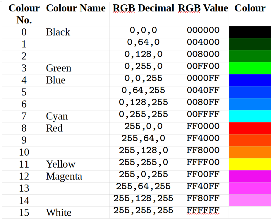

Thanks @phil99, I must have been reading incorrect information.  Maybe it was related to different hardware.  Like I said, I was Googling, looking for the answers.
I'll update the table and see what it looks like.
Mmm...unfortunately it just darked all the blended colours, reducing the dynamic range of the palette.
Are the values you've given based on the resistor values in the Green circuit of the VGA?  ie. bit values 10 is twice the voltage of bit values 01.

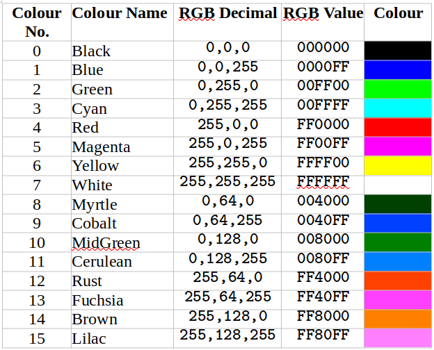

  Hawk said
I've been playing with creation of graphics for the PicoMiteVGA.
Can I also suggest that an updated version of the manual include the colour palette mapped to the RGB values, the names, and the numbers (if that bug/feature) has been changed?
Also, I have seen conflicting information in the existing manual regarding the number of sprites supported.  Is it 32 or 64?
Thanks,
Mike
Mike
The Order of the Colornubers, as also used in Sprite Files, are
0=BLACK
1=BLUE
2=GREEN
3=CYAN
4=RED
5=MAGENTA
6=YELLOW
7=WHITE
8=MYRTLE
9=COBALT
A=MIDGREEN
B=CERULEAN
C=RUST
D=FUCHSIA
E=BROWN
F=LILAC

  Hawk said  Are the values you've given based on the resistor values in the Green circuit of the VGA?  ie. bit values 10 is twice the voltage of bit values 01.
For green the two most significant bits of the byte become Green High and Green Low.
For red and blue just the MSB is used.
For the VGA that program just reads back values from the frame buffer. The resistors determine what actually goes to the screen. Put a 1k trim-pot plus 220R in series with each of 4 pins and you can have whatever you like.
Four bits just isn't enough to be too fussy about precision. No matter what 16 you choose all colours in between those will be wrong, and that is the great majority of colours.

OK, I've updated according to Martin's info.  I can't go against the facts, but I do like the palette I posted that has the shades of the same colours all together.  I can see the patterns in the numbers of the correct palette so I guess there's a programmatic reason for it.
So when you create an indexed bitmap to use in a program, the palette needs to be like this?   I'll need to update my palette in the GIMP.
Sorry...this has really corrupted the original topic.  I didn't intend this to get so far off topic.  Perhaps it needs moving to it's own thread.

@phill,
The green levels look like 0,1/3, 2/3, 1
Not 1/4 and 1/2.
Correct me if I am wrong...

  Volhout said  @phill,
Not 1/4 and 1/2.
Ah...I think you are where I got the information from, and it made sense to me at the time.
00 = Black
01 = ?
10 = ?
11 = Bright Green
b10 is twice as bright (twice the voltage) as b01.
b11 is not twice as bright as b10.  It's only b01 brighter.
I cut out the section of this post relating to the resistor values, as I found that the VGA portion of the circuit in the manual for the Silicon Chip kit is different from the VGA portion of Ver 5.07.06.
The Silicon Chip circuit gets the correct ratios by using all the same resistor values, but using some in series and some in parallel, thus maintaining the correct ratio for each bit.
Edited 2023-04-29 16:37 by Hawk

Posted: 07:05am 29 Apr 2023
The PicoMite's / MMBasic's VGA system is fun. :)
Only the resistor values affect what you see. The PicoMite doesn't care what you see, it just outputs a 4-bit binary number on the video pins. The colour names in MMBasic are only relative to the values that were used with the original VGA circuit.
There is no "palette" in the conventional sense. You can't choose the colours, you are stuck with a 4-bit binary number and you can call the values anything you like. e.g. MYPINK = RGB(0,64,0) and what you see will depend on what you dd with the resistors. :)
Normally you have 1 bit for red, 1 bit for blue and 2 bits for green. You can work out the VGA input voltages:
For red and blue 270R into 75R will give about 664mV
For dark green 820R into 75R will give about 250mV
For green 390R into 75R will give about 484mV
For light green 264R (820R//390R) into 75R will give about 660mV
As it's a binary output the greens should ideally have a 2:1 relationship that gives 650mV for light green. It's very unlikely that you'd spot the difference though. If you want to experiment change the 390R to 410R - but it's non-standard so use two 820R in parallel. That gives 460mV for green and 645mV for light green if I've done my sums correctly ...
Edited 2023-04-29 17:19 by Mixtel90
Posts: 5998
Posted: 07:41am 29 Apr 2023
Add the output impedance of the pico, 30 to 50 ohm.
Also take into account that when 820 pulls up, and 390 pulls down, rhe divider is 820 onto (390 parallel 75).
That is all theoretical, fact is that there are 16 fixed colors. The pallette can be used to dither any picture to these 16 colors. With more or less quality loss.

Thanks for the explanation gentlemen.  So the upshot is, the actual colours that are displayed will be different for each version of the VGA output circuit.  There is no standard.  So what might look good on one machine may look very different on another.
Any palette that we define in a paint program to use to create graphics for the PicoMiteVGA will be just an approximation of the final output from the device.
At least now I have that palette to work with, and based on my experiments on my device, it's a pretty good approximation, so thanks again.
I'm finding working without a grey value challenging, but it's the limitations that bring out creativity, right?  Was RGBI ever considered as a viable option for the PicoMiteVGA?
For those that use the GIMP, here is the palette.
PicoMiteVGA.gpl.zip
