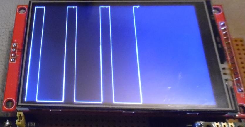

Posts: 2807
Posted: 06:35pm 28 Aug 2023
mem says 142K ram so my bad.
ili9341 320x240x3=230400 so too big as well.
I had tried your code phil99. Nice but I prefer faster display so redoing original code with additions.
SetPin GP2,pwm1A 'this optional test signal comment out
PWM 1,5000,30   ' square wave ,this optional test signal comment out
dim count%,samples!(320),old_samples!(320)
SETPIN GP26, AIn
adc open 500000,1 'samples per second
cls
do
  adc start samples!() 'get new samples
  math scale samples!(),319,samples!()'scale to 320 pixel
  for count%=0 to 318 'screen width
   'pixel count%,old_samples!(count%),rgb(black) 'erase old_sample
   'pixel count%,samples!(count%),rgb(white) 'draw new sample
    line count%,old_samples!(count%),count%+1,old_samples!(count%+1),,rgb(black) 'erase old_sample
    line count%,samples!(count%),count%+1,samples!(count%+1),,rgb(white) 'draw new sample
  next count%
  math add samples!(),0,old_samples!() 'copies new samples to old_samples
loop
I still have the problem of using pixels and only see bottom lines but using lines all wave shows.

Posts: 2807
Posted: 09:38pm 28 Aug 2023
in my simple scope above doesn't do anything but if I comment it out I get a tiny wave but changing it shows no change

Posts: 3325
Posted: 12:58am 29 Aug 2023
math scale samples!(),190,samples!()'scale to 320 pixel
Math Scale scales the value of each sample, not the number of samples. Replace 190 with (MM.VRes / 3.3) to get the right height.
The lack of width suggests you may be using the ILI9488 with MM.HRes = 480.
Try these changes, they should work for any screen:-
HRes = MM.HRes * 2
dim x%, samples!(HRes), old_samples!(HRes)
  inc c%:loop while c% < MM.HRes
  for x%=0 to MM.HRes - 1 'screen width
Edited 2023-08-29 11:07 by phil99
Posts: 2807
Posted: 02:35pm 29 Aug 2023
Hi phil99. ili9488 and scope x and y height/width 320x320.
dim x%,samples!(640),old_samples!(640)
math scale samples!(),190,samples!()'scale to 190 pixel
This scales the matrix in() by the scalar scale and puts the answer in out()
so I read 0V to 3.3V and scales to 0 to 190... all 640 elements of samples!() back to samples!()
It should scale to any val but it doesn't, it stays 3.3V=320.
Posts: 3325
Posted: 09:41pm 29 Aug 2023
  Quote  so I read 0V to 3.3V and scales to 0 to 190
Math Scale scales the value of each sample By 190 not To 190.
ie. 3.3 (input) x 190 (scale factor) = 627 (output) which would be off screen, but the display driver (or the panel) limits it to 320 (MM.VRes).
To scale to 190 use (190 / 3.3).

Dim INTEGER v_time, v_diff, v_state, v_old, v_press ' Volts   scale button debouncing and status
Dim INTEGER t_time, t_diff, t_state, t_old, t_press ' Trigger type  button debouncing and status
Dim INTEGER a_time, a_diff, a_state, a_old, a_press ' ADC frequency button debouncing and status
Dim INTEGER Horizontal(Hres)      ' Horizontal coordinate buffer for fast graticule and buffer draw
Dim FLOAT   sample(2*Hres)        ' Extra size to hopefully pick up a trigger event
Dim FLOAT   buffer(Hres)          ' Display buffer for screen output
Dim INTEGER addr.sample, addr.buffer
Dim INTEGER HMajorX1(HMajor+1), HMajory1(HMajor+1), HMajory2(HMajor+1) ' For Horizontal Major Axes
Dim INTEGER VMajorX1(VMajor+1), VMajorx2(VMajor+1), VMajory1(VMajor+1) ' For Vertical   Major Axes
Dim INTEGER HMinorX1(HMinor+1), HMinory1(HMinor+1), HMinory2(HMinor+1) ' For Horizontal Minor Axes
Dim INTEGER VMinorX1(VMinor+1), VMinorx2(VMinor+1), VMinory1(VMinor+1) ' For Vertical   Minor Axes
Dim Float   V.Scale(10), V.Offset(10), V.MajVolts(10)
Dim Float   H.Freq(10),  H.Seconds(10)
Dim String  H.Units$(10), keypress$
' ========================== Initialization =================================
Timer = 0
Initialize_Arrays
Initialize_Hardware
Display_Instructions
Draw_Graticules
' ========================== Processing Loop ================================
 Randomize_Test_Signal
 trigger_timeout = Timer
   Handle_Keypresses
   Handle_Switches
   trigger = -1
   Get_Samples
   trigger = find_trigger(Trig_Type)
   If Timer-trigger_timeout > 2500 Then Display_No_Trigger ' Waiting too long for a trigger.
 Loop Until trigger >= 0
 If Timer-trigger_timeout > 2500 Then Draw_Graticules      ' OK, we've got a trigger. Clear message.
 Scale_Samples
 Update_Display
' ========================== Interrupt Service Routines ====================
Sub V_ISR ' Interrupt Service Routine for Voltage SPST Button
 If v_press = 0 Then ' Ignore further  button presses until handled in main loop
   If (Timer - v_time) > debounce Then v_press = 1 : v_time = Timer
 EndIf
End Sub
Sub T_ISR ' Interrupt Service Routine for Trigger SPST Button
 If t_press = 0 Then ' Ignore further  button presses until handled in main loop
   If (Timer - t_time) > debounce Then t_press = 1 : t_time = Timer
 EndIf
End Sub
Sub A_ISR ' Interrupt Service Routine for ADC Frequency SPST Button
 If a_press = 0 Then ' Ignore further  button presses until handled in main loop
   If (Timer - a_time) > debounce Then a_press = 1 : a_time = Timer
 EndIf
End Sub
' ========================== Subs and Functions ============================
Sub Handle_Keypresses
 keypress$ = Inkey$
 Select Case keypress$
   Case "0"      : Vselect = 0
   Case "1"      : Vselect = 1
   Case "2"      : Vselect = 2
   Case "3"      : Vselect = 3
   Case "u", "U" : Trig_Type  = Trig_Up
   Case "d", "D" : Trig_Type  = Trig_Down
   Case "n", "N" : Trig_Type  = Trig_None
   Case "f", "F" : ADC_select = Min(ADC_select+1, ADC_Max) : Set_ADC_Timing
   Case "s", "S" : ADC_select = Max(ADC_select-1, 0) : Set_ADC_Timing
   Case "" : Exit Sub               ' No key pressed. No change.
   Case Else : Display_Instructions ' Unknown key pressed.
 End Select
 Draw_Graticules
End Sub
Sub Handle_Switches ' using Ganssel's debounce routine in Fruit of the Shed
 Local INTEGER V, T, A
 If v_press = 1 Then
   v_press = 0
   Vselect = (Vselect+1) Mod (V_Max+1)
 EndIf
 If t_press = 1 Then
   t_press = 0
   Select Case Trig_Type
     Case Trig_Up:   Trig_Type = Trig_Down
     Case Trig_Down: Trig_Type = Trig_None
     Case Trig_None: Trig_Type = Trig_Up
     Case Else :     Trig_Type = Trig_Up
   End Select
 EndIf
 If a_press = 1 Then
   a_press = 0
   ADC_select = (ADC_select+1) Mod (ADC_Max+1) : Set_ADC_Timing
 EndIf
 Draw_Graticules
End Sub
Function find_trigger(a)
 Local median = Math(MEAN sample())
 Select Case a
   Case Trig_Down
     For c = 0 To Hres-1
       If sample(c) > median+0.1 And sample(c+1) < median+0.2 Then find_trigger = c : Exit Function
     Next
     find_trigger = -1 : Exit Function
   Case Trig_Up
     For c = 0 To Hres-1
       If sample(c+1) > median+0.1 And sample(c) < median+0.2 Then find_trigger = c : Exit Function
     Next
   Case Else
     find_trigger = 0 : Exit Function
 End Select
End Function
Sub Display_Instructions
 FRAMEBUFFER WRITE L
 CLS Background
 Text   6,  Vres/2, "PicoScope", CMV, 7, 1, Signal, Background
 Text   18,  3,     "Keyboard:", LT, 7, 1, TxtColor, Background
 Text   25, 15,     "Volt: 0, 1, 2, 3", LT, 7, 1, TxtColor, Background
 Text   25, 27,     "Time: Faster, Slower", LT, 7, 1, TxtColor, Background
 Text   25, 39,     "Trig: Up, Dn, None", LT, 7, 1, TxtColor, Background
 Text   25, 51,     "Pin 24: Test Signal", LT, 7, 1, TxtColor, Background
 FRAMEBUFFER COPY L, F
 FRAMEBUFFER COPY F,N
 Pause 4000
 Text   20, 79,     "Waiting for Trigger.....", LB, 7, 1, Signal, Background
End Sub
Sub Display_No_Trigger
 FRAMEBUFFER WRITE L
 Text Hres/2, Vres/2, "Waiting for Trigger.....", CM, 7, 1, Signal, Background
End Sub
Sub Initialize_Arrays
 addr.sample = Peek(varaddr sample())
 addr.buffer = Peek(varaddr buffer())
 Math Set 0, HMajory1() : Math Set Vres, HMajory2()  ' Set Arrays for Time  Major Axis
 Math Set 0, VMajorX1() : Math Set Hres, VMajorx2()  ' Set Arrays for Volts Major Axis
 Math Set 3*Vres/4+Minor/2, HMinory1()
 Math Set 3*Vres/4-Minor/2, HMinory2() ' Set Arrays for Time  Minor Axis
 Math Set Hres/2+Minor/2,   VMinorx1()
 Math Set Hres/2-Minor/2,   VMinorx2() ' Set Arrays for Volts Minor Axis
 For x = 0 To Hres-1 : Horizontal(x) = x     : Next ' used in array graphics
 For x = 0 To HMajor : HMajorx1(x) = x*Major : Next ' for Time  Major Axis graticule
 For y = 0 To VMajor : VMajory1(y) = y*Major : Next ' for Volts Major Axis graticule
 For x = 0 To HMinor : HMinorx1(x) = x*Minor : Next ' for Time  Minor Axis graticule
 For y = 0 To VMinor : VMinory1(y) = y*Minor : Next ' for Volts Minor Axis graticule
 ' RP2040-LCD-0.96 - specific values here.
 ' For Voltage, Zero is at pixel 60, 3/4 down the display
 V.Scale(0)= -4.0 : V.Offset(0)=60 : V.MajVolts(0) = 5.000 ' 5.000 Volts per Major Division
 V.Scale(1)= -8.0 : V.Offset(1)=60 : V.MajVolts(1) = 2.500 ' 2.500 Volts per Major Division
 V.Scale(2)=-16.0 : V.Offset(2)=60 : V.MajVolts(2) = 1.250 ' 1.250 Volts per Major Division
 V.Scale(3)=-32.0 : V.Offset(3)=60 : V.MajVolts(3) = 0.675 ' 0.675 Volts per Major Division
 ' For Time,
 H.Freq(0) =   1000 : H.Units(0)="mSec" : H.Seconds(0) = 20.0
 H.Freq(1) =   2000 : H.Units(1)="mSec" : H.Seconds(1) = 10.0
 H.Freq(2) =   4000 : H.Units(2)="mSec" : H.Seconds(2) = 5.0
 H.Freq(3) =  10000 : H.Units(3)="mSec" : H.Seconds(3) = 2.0
 H.Freq(4) =  20000 : H.Units(4)="mSec" : H.Seconds(4) = 1.0
 H.Freq(5) =  40000 : H.Units(5)="uSec" : H.Seconds(5) = 500.0
 H.Freq(6) = 100000 : H.Units(6)="uSec" : H.Seconds(6) = 200.0
 H.Freq(7) = 200000 : H.Units(7)="uSec" : H.Seconds(7) = 100.0
 H.Freq(8) = 400000 : H.Units(8)="uSec" : H.Seconds(8) = 50.0
 ADC_select = 3              ' Select from a number of time scales
 Vselect    = 1              ' Select from a number of Scale factors and offsets for volts
 Trig_Type  = Trig_Down      ' Select from a number of trigger types
End Sub
Sub Initialize_Hardware
 SetPin V_SW, INTL, V_ISR, PULLUP ' Switch to cycle through Voltage scales
 SetPin T_SW, INTL, T_ISR, PULLUP ' Switch to cycle through Trigger types
 SetPin A_SW, INTL, A_ISR, PULLUP ' Switch to cycle through ADC Frequency (Time) scales
 SetPin GP18, PWM1A               ' Set up pin 24 for PWM test signal output
 PWM 1, PWM_Freq, PWM_Duty        ' Square wave on Pin 24
 SetPin (31), AIn                 ' ADC input on Pin 31
 ADC open H.Freq(ADC_Select), 1   ' Sample at specified frequency
 FRAMEBUFFER CREATE F
 FRAMEBUFFER LAYER  L
End Sub
Sub Set_ADC_Timing
 ADC FREQUENCY H.Freq(ADC_Select)
End Sub
Sub Draw_Graticules
 Local STRING T$, V$, A$
 FRAMEBUFFER WRITE L
 CLS Background
 Line HMinorx1(), HMinory1(), HMinorx1(), HMinory2(), 1, GMinor ' Draw minor horiz graticules
 Line VMinorx1(), VMinory1(), VMinorx2(), VMinory1(), 1, GMinor ' Draw minor vert  graticules
 Line HMajorx1(), HMajory1(), HMajorx1(), HMajory2(), 1, GMajor ' Draw major horiz graticules
 Line VMajorx1(), VMajory1(), VMajorx2(), VMajory1(), 1, GMajor ' Draw major vert  graticules
 A$ = Str$(H.Seconds(ADC_Select),3,0) + " " + H.Units(ADC_Select)
 Text    0, Vres, A$, LB, 7, 1, TxtColor, Background     ' Draw Time Scale at Lower Left
 V$ = Str$(V.MajVolts(Vselect), 2, 2)+" V"
 Text Hres, Vres, V$, RB, 7, 1, TxtColor, Background     ' Draw Volts Scale at Lower Right
   Case Trig_Up:   T$ = "/"
   Case Trig_Down: T$ = "\"
   Case Trig_None: T$ = "-"
   Case Else :     T$ = " "
 End Select
 Text Hres/2, Vres, T$, CB, 7, 1, TxtColor, Background    ' Draw Trigger at Lower Middle
End Sub
Sub Randomize_Test_Signal
 PWM 1, PWM_Freq, PWM_Duty+PWM_Jitter*Rnd  ' Randomize duty cycle to ensure displayed signal is refreshing
End Sub
Sub Get_Samples               ' Load ADC inputs into sample() array
 sample(2*Hres-1) = -1       ' Samples will never be < 0
 ADC start sample() : Do While sample(2*Hres-1) < 0 : Loop
End Sub
Sub Scale_Samples
 Memory copy FLOAT addr.sample + trigger*8, addr.buffer, Hres
 Math Scale buffer!(), V.Scale(Vselect),  buffer!()  ' Scale samples to fit vertically
 Math Add   buffer!(), V.Offset(Vselect), buffer!()  ' Offset to bottom of screen (positive is up)
End Sub
Sub Update_Display
 FRAMEBUFFER WRITE F : Pixel Horizontal(), buffer!(), Signal
End Sub
Er..wow! I have been using math scale under a mis preconception all along, DOH!
Ta for pointing out my error. stan
