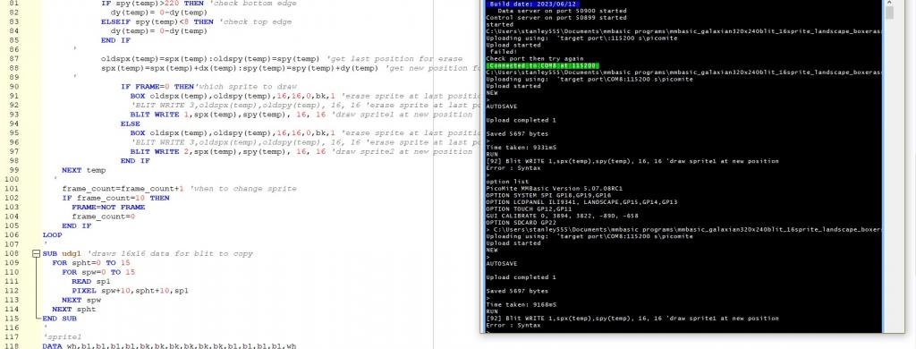

Using V5.07.08RC1 and getting blit error I did not get before. Has it changed?

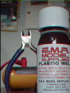

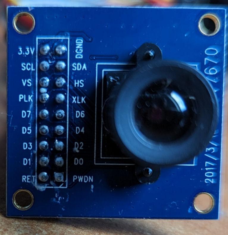

New Command supporting the OV7670 camera module e.g.
Wire 3.3V to 3.3V on the Pico
Wire GND and PWDN to GND on the Pico
Enable OPTION SYSTEM I2C on the Pico and wire SCL and SDA to the relevant pins (may be labelled SIOC and SIOD on the camera module). These connections must have a pullup to 3.3V - 2K7 recommended)
Other pins are wired as per the OPEN command. (NB: VS may be labelled VSYNC, HS may be labelled HREF, PLK may be labelled PCLK, RET may be labelled RESET and XLK may be XCLK on your module)
D0pin defines the start of a range of 8 contiguous pins (e.g.GP0 - GP7).
Basic commands
BITBANG CAMERA OPEN XLKpin, PLKpin, HSpin, VSCpin, RETpin, D0pin
This command initialises the camera, It outputs a 12MHz clock on XLK (PWM) and checks that it is correctly receiving signals on PLK, VS, and HS. The camera is set to a resolution of 160x120 (QQVGA) which is the maximum achievable within the limits of the RP2040 memory. However the image quality is remarkably usable.
BITBANG CAMERA CAPTURE [scale, [x , y]]
This captures a picture from the camera (RGB565) and displays it on an LCD screen. An SPI LCD must be connected and enabled in order for the command to work. (ILI9341 and ST7789_320 recommended).
Scale defaults to 1 and x,y each to 0
By default a 160x120 image is output on the LCD with the top left at 0,0 on the LCD. Setting scale to 2 will fill a 320x240 display with the image. Setting the x and y parameters will offset the top left of the image on the LCD.
Update rate in a continuous loop is 7FPS onto the display at 1:1 scale and 5FPS scaled to 320x240.
Of course, assuming the display has MISO wired it is then possible to save the image to disk using the SAVE IMAGE command as used to create the example image above.
BITBANG CAMERA CLOSE
Close the camera subsystem and frees up all the pins allocated in the OPEN command

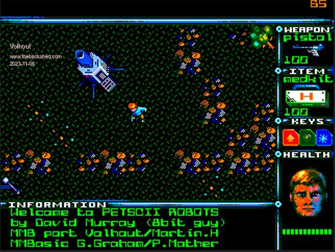

Dear Peter,
The PETSCII team is trying to make the game compliant with both LCD and VGA.
In that effort they are using the "FRAMEBUFFER WRITE sc$" where sc$ is either N or F, depending on the platform.
When running PicoMiteVGA 50708RC12, the command FRAMEBUFFER WRITE sc$ gives a syntax error when sc$="N" or "n".
I tried the latest PicoMiteVGA 50708RC14, and the same happens.
I am not sure the command is correctly implemented in picomite VGA. Can you confirm?
Thanks,
Posts: 11662
Posted: 09:07am 06 Nov 2023
Try this
PicoMiteVGA.zip
Posts: 5998
Posted: 09:14am 06 Nov 2023
Yes, now it works...

Posts: 5998
Posted: 09:52am 06 Nov 2023
Peter,
You have made changes that we can do an SAVE IMAGE combining 2 layers L and N.
Is that function compatible with the programable transparency color in L ?
When I try SAVE IMAGE "xx" regardless if I select layer N or L for write, I see the magenta transparency color we have selected (color 9).
Posts: 11662
Posted: 10:04am 06 Nov 2023
Try this (untested)
PicoMiteVGA.zip
Posts: 5998
Posted: 10:49am 06 Nov 2023
Not working...
'test screen dump
MODE 2
Text 0,0,"Hello World"
FRAMEBUFFER layer 9 'magenta is see-through color
FRAMEBUFFER write l
Box 20,0,40,40,1,RGB(magenta),RGB(magenta)
FRAMEBUFFER write n
Save image "test.bmp"
Text on layer N, layer L only box is see-through. So you only see part of test in box.
Second framebuffer write can also be commented out (stay on L), makes no difference.
After running:
NEW
MODE 2: LOAD IMAGE "test.bmp"
NEW should make sure you are back on layer N, L does not exits anymore.
And you see only the magenta box...
Edited 2023-11-06 20:51 by Volhout
Posts: 11662
Posted: 11:23am 06 Nov 2023
OK got it
PicoMiteVGA.zip
Posts: 5998
Posted: 11:46am 06 Nov 2023
Yes, that works.....
Thanks you, now it is easier to make documentation and show the program to others on the forum....
Edited 2023-11-06 21:50 by Volhout
