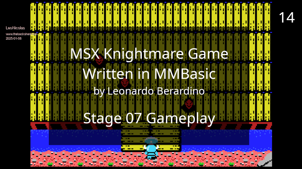

Hello everyone
Today I released the stage 7 gameplay video. The source code is up to date on my GitHub.
This is the first gameplay where the game is running on the MMB4L interpreter version. I want to especially thank Tom (@thwill) for his amazing port. I don't need to rely on wine anymore to run the game on my Linux
Enjoy   https://youtu.be/WcIpNk5oHE0

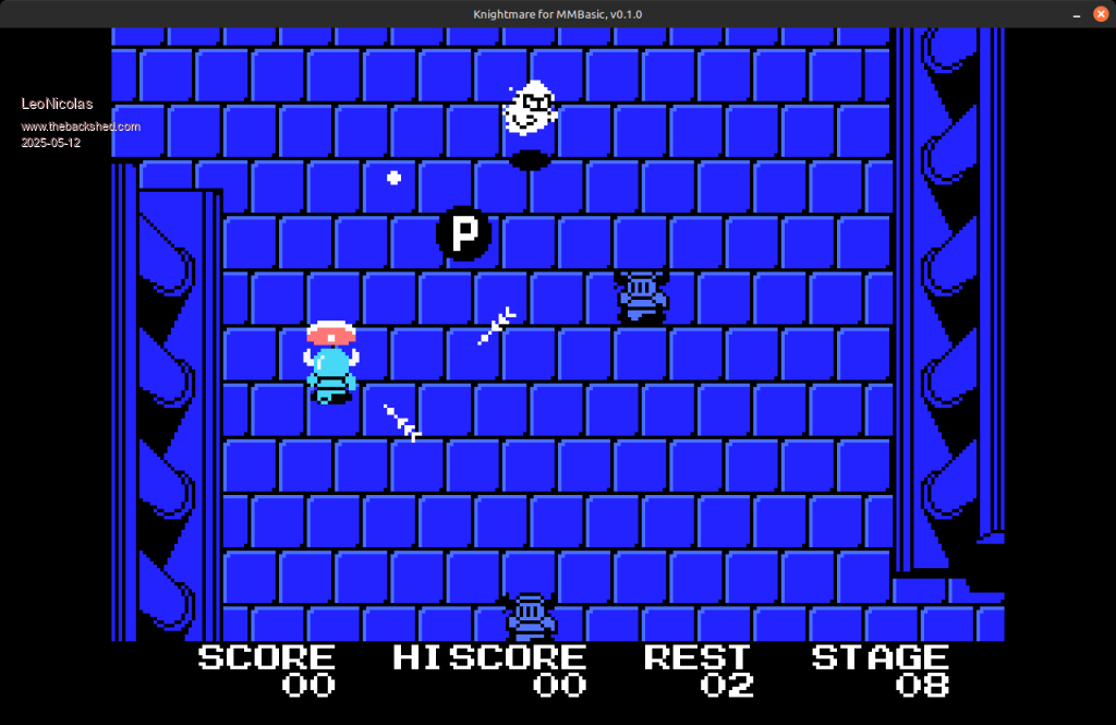

LeoNicolas
Joined: 07/10/2020
Posts: 625
Posted: 01:21am 12 May 2025
Hi everyone
I pushed the stage 8 map to the game repo. Now I'm implementing the final boss behaviour. This stage is not easy
This version has only been tested on the MMB4L. After finishing the game, I will add support for the other platforms.

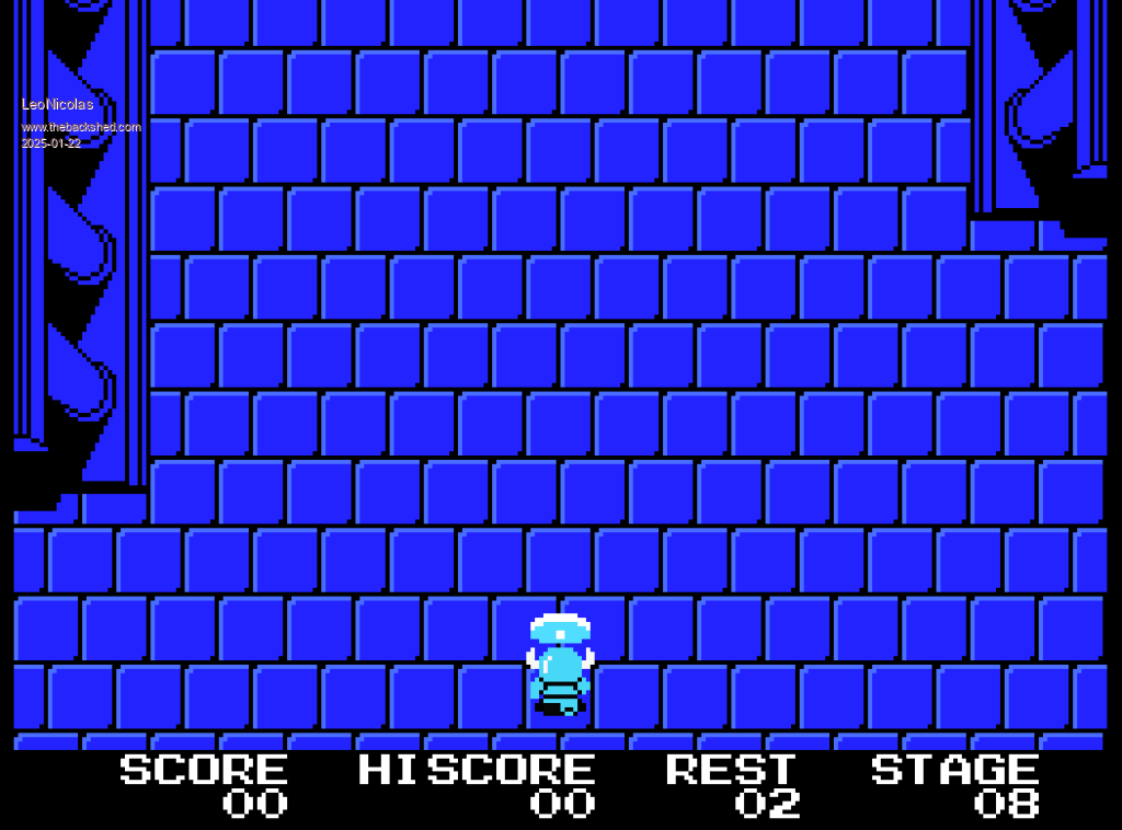

homa
Joined: 05/11/2021
Posts: 725
Posted: 03:59pm 05 Sep 2025
@LeoNicolas
I just wanted to try out the status on a w11 with 5.07.03b24 again, but keyboard input isn't working?
Matthias
LeoNicolas
Joined: 07/10/2020
Posts: 625
Posted: 12:38am 06 Sep 2025
Hi Matthias
I fixed the issue two days ago. Let me know if it is still happening.
This week I'm implementing the final boss behaviour
https://youtube.com/shorts/lSZANt6-UX4
These are the remaining items to complete the game development:
- The final game cutscene
- Properly port the game music to MOD files (any help here is welcome  )
- Fix the position of the player when re-spawning after a death
- Minor bug fixed
- Make it work on the real hardware (CMM2 and PicoMite)
