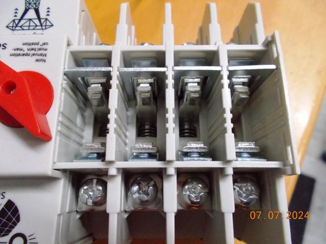

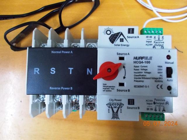

I have been reworking the corner of the shed that houses the inverter and solar regulators, so we have been on grid power for two days, late yesterday I finally had everything ready to switch back to Solar.
I finished up and threw a switch to signal the ATS (automatic transfer switch) to switch to Inverter AC.
Some good news and BAD news.
Bad news first .... The inverter failed.
The good news .... This time I was standing beside it, and knew what happened - but why now? This has happened once before, but when switching from Inverter to AC under a high load.
The hint, as before, was the mains circuit breakers tripping in two locations, the bang I heard was the Kilovac dropping out, the over current LED was flashing, the other thud was the mains breaker tripping.
I walk over to the House and find that my wife had the drier running on high, and the Hot water system was still switched over to top it up, so mains load was around 6kW when it switched from mains to the inverter. The inverter normally has no trouble with this.
The first time it happened I had immediately suspected the ATS might have arched over - Mains AC and Inverter AC don't mix in this way.
I ordered a different type of ATS, and as sh*t happens, I never got around to changing it over, but it was always in the back of my mind and was the next item on the to-do list.
The Inverter took all of 15 minutes to get up and running, as I simply swapped in the new power board that I had recently built. A quick look and absolutely no sign of blown FETs, no smell, nothing, but three FETS were shorted - love these Kilovacs.
So today, I had to find a way to incorporate this different type of ATS - and to pull the old one apart and see if my suspicions were supported.

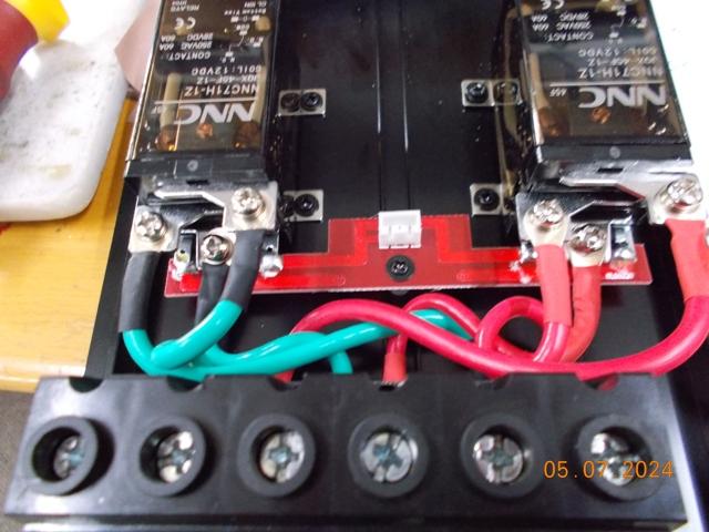

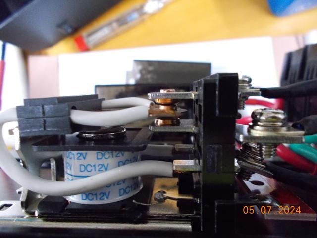

I should have ripped that old ATS apart long ago. Inside I find two relays, each rated at 60A, one switching Neutral and one switching Active - simply connected in parallel, the gaps are TINY, what could possibly go wrong above 5kw, it's rated for over 11kW.
Below
The newer low cost ATS has a gap measured in inches - a rotating cam, huge contacts and dual solenoids.
I'm using the 2 pole version of this similar unit for now.
There are dozens of the videos on the internet, some are wrong and would burn out a solenoid in no time, none show any use for the passive relay contacts apart from switching indicator lights, and the dam circuit supplied with them is wrong, and circuits on the internet are also wrong - WTF.
None mentioned the warning about burning out solenoids if the AC was low, the manufacture does not hint why, but one look inside and it's bleeding obvious, I should have realized without opening it, but when your doing 100 things at once - sigh.
So, I have it working with the addition of a single small 3A AC SSR "Solid state Relay"
I used the same Mains/Solar priority switch with a tiny 240vac to 6v transformer and small housing I had used before, the only connections to the inverter are the AC enable output pin from the controller FET and a ground connection - brilliant!
The circuit shows two relays, one on the Main power input and one on the solar/Generator input, this is wrong, there is only one relay for the two "Passive contact outputs" on each AC input.
That relay is controlled by the Top input only, because of that, it allows the use of lower input passive contacts of that relay be used to stop the backup AC input powering the solenoid if the Top input also has AC mains. You cannot have AC on both inputs unless one solenoid is disconnected. The solenoids are driven by two wires from each AC input connected to the AR, AN and BR, BN terminals on the two green plugs.
When a solenoid detects AC, it pulls the switch cam across and a micro switch disconnects the Solenoid to stop it burning out. You can see what would happen if both inputs had AC applied. It turns out though, that this is a really brilliant design and so easy to use once you realize the dam circuit is wrong.
I can post the connection layout I used if anyone is interested.
Edited 2024-07-05 20:20 by KeepIS

That is true, but the these ATS devices are designed for this, the one I had for years was not up to the task on high loads, as others have reported when I searched for the old ATS, a number of cases reporting inverter failures from arching, the design was crap.
Automatic is simple with these new ATS unit, there are no extra components needed.
Mains stops, switch to inverter (if it's running) or back to Mains when it returns.
My slight mod was to simply allow the priority of Solar over mains or mains over solar.
The new ATS has a manual/Auto switch, so it can be manually switched if you want.
As I indicated, it's not the load that is the problem, it was that old ATS arching to Mains AC when as it's connecting to Inverter AC - that can NEVER happen again, it's impossible in this new ATS

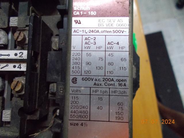

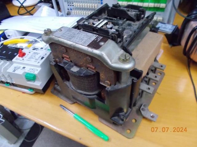

KeepIS.s old transfer switch might comply with the regulations for ELV (up to 50V RMS sinewave) but not for LV. For an automatic transfer switch simple changeover contacts are not permitted, at a minimum they need to be on separate armatures to ensure adequate isolation between the two inputs.
Normally two separate contactors are used with both electrical and mechanical interlocks. The electrical interlock ensures the first is off before the second can be energised while the mechanical interlock ensures, in the event of welded contacts etc. the second can't close until the first armature is released.
With regard to synchronizing the inverter with the mains, this is common on large 3 phase UPSs. As long as the mains is within about 0.2Hz of normal it is used as the reference for these inverters.
It makes for seamless changeovers, especially if there are induction motors running. They can produce a large current spike if there is a sudden, large phase shift.

The manual is in Dutch and English, the manual states 240VAC, but that does not mean much with a compliance, it has a CE sticker but that means nothing.
The new one is not a relay, it's physically impossible to have a changeover contact fault.
EDIT: This is why I was amazed when I opened up the old one, no interlocks of any kind - absolute crap, it was raved about on line a few years back.
Edited 2024-07-06 10:50 by KeepIS

No physical damage to the power board, just 3 shorted fets, no smoke, not even a hairline crack in the FET cases - AC and DC input current trip and a Kilovac to the rescue.
FYI:
The GAP on the first ATS.
GAP on the ATS I'm now using.
What about one of these solenoid switches
It's the weight of a small vehicle battery.
Edited 2024-07-07 11:30 by KeepIS
