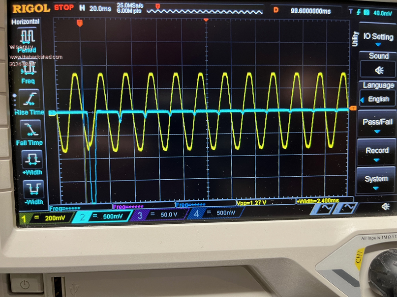

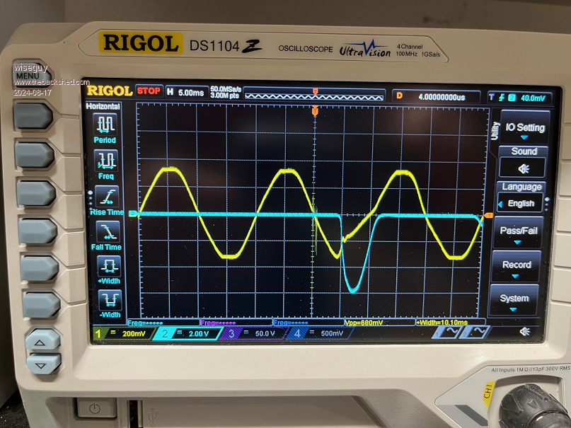

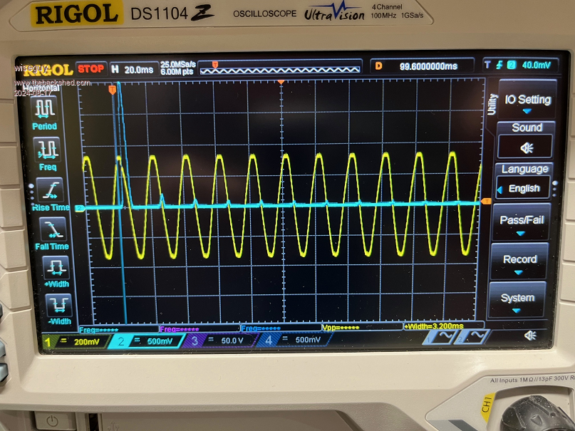

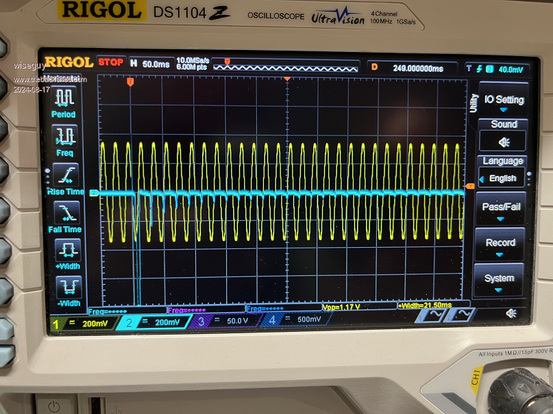

You are now on the same page I am on, re your understanding of how and why it is intended to function. After multiple starts using the second stage switching PCB I eventually saw ~ 60A surges of start current. I used household mains as stage 1 but have to admit I was a bit cautious and initially crept up to 240V with a Variac.
Then I got braver and just used house mains direct. The 60A surges at switch on were because all the relatively rapid start stops to find a start surge had eventually heated up the NTC thermistors so they were almost a piece of wire. You can see the house mains collapsing at the Toroid input in the pictures for the 60A event.  The long run of mains supply cable from my workshop back to the house switchboard and the extension lead I was also using obviously added some impedance, which was good, I didnt even trip the breaker once.
I cheated a bit though, each start up of the NTC limiting stage was looking for the start surge so when the CRO triggered I immediately removed the 12V, cancelling the on board 2 & 10 second timers, reprimed the CRO and applied the 12V for another cycle, 2-3 seconds between each successive multiple start ups, that was why the thermistors eventually heated up to become a very low R.  Ok some short pauses when I captured something worth showing I took a quick screen shot and then carried on.  In retrospect the little 6A start relay handled the 60A surges very well  .
If we use the 60A single cycle surge current as a starting figure, with around a 1-8 turns ratio between primary and secondary that equates to at least 480A of primary current on stage 1 but remember there is less impedance in the primary than my equivalent mains side testing so no doubt higher than this figure, the NTCs are very important.  We always knew/suspected this to be the case so the tests are just emphasising what would really happen without mitigation to control the second stage start up.
Having time now to digest the results, a 1 second timer for stage 2 NTC start up should be ample and NTC values of around 20-25R each should limit the primary current to worst case single cycle of ~ 40-50A, piece of cake!  Of course switching the stage 2 to manual before switching the inverter to "run" allows a gentle soft start simultaneously of both toroids.
In the following screen shots the yellow mains had a 1000-1 divider so 200mV = 200V.
The blue trace when set for 1V = 10A/div, 0.5V = 5A div and 200mV = 2A/div
First a 60A surge
Now a ~25A surge showing reducing currents each cycle
And a positive cycle capture for completeness
And finally a longer capture of reducing current amplitudes
Edited 2024-08-17 09:06 by wiseguy

After looking at the pictures for a while the large current peaks are always captured at the peak of the mains. Sure there are other smaller surge events but the significant ones are 10-20 times larger than the smaller ones. This appears to mean that if the start up was synced to a zero cross then these huge start up surges could be avoided anyway. I know KeepIS and myself (maybe others too) had considered using a solid start relay (zero cross type) that was then bypassed by a relay a short time later could also work.
I also think that one day when so inspired I will experiment with a way of applying some DC to the second stage toroid briefly to bias it in one known direction and then ensure the first start cycle is in the opposite direction so it will begin by pulling it out of saturation rather than adding to it.

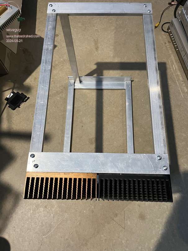

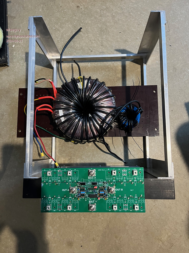

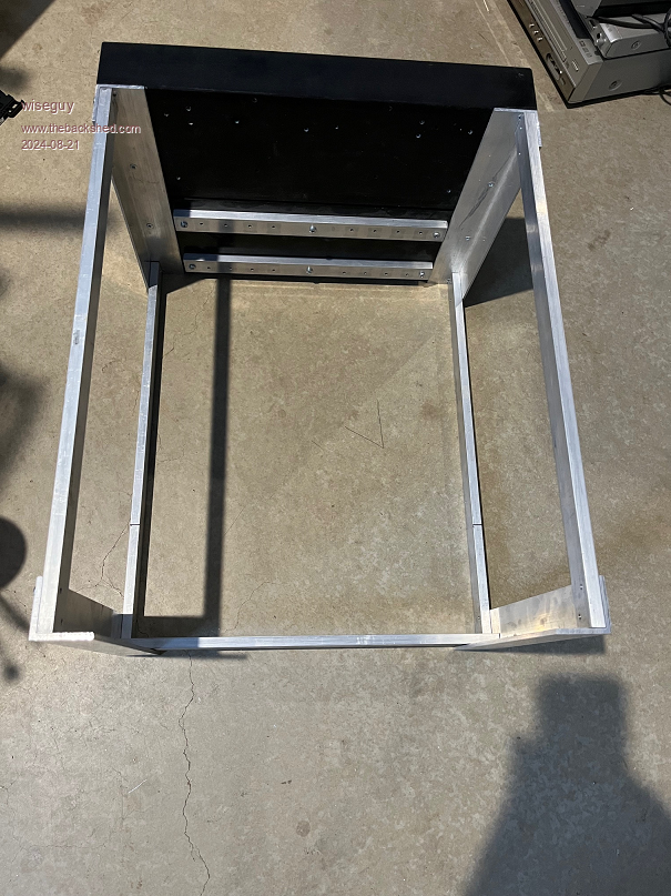

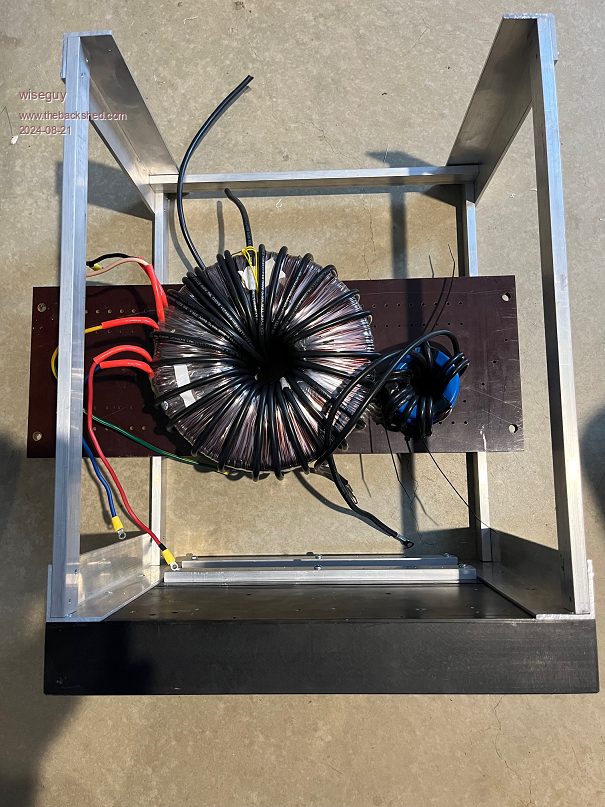

I am busy building up my own 2 stage inverter, it is using 2 Aerosharp heatsink modules and lots of 10mm x 25mm Aluminium lengths and 4mm x 4mm aluminium angles etc.  So far I have the frame built, I have also wound the primary for one 3.5kW Toroid, another still to do, I used some 10mmsquare cable I had to hand (time will tell) and I decided to add a 17T overwind to the 195T secondary to match the other 212T winding for lowest secondary losses - & so much more still to do.....
It will be a lot smaller and using less combustible material than KeepIS (who has lots of access to wood and woodworking tools) but due to the open frame construction I am using should still be really easy to work on once covers are removed.  I do see the sense though in using wood screws as an alternative to my method, (I have lost count of all the threads cut so far) and plenty more still to do, the novelty wore off after about the third thread cut!
Basic Frame dimensions are ~ 500L x 400W x 300H and I expect it to house both stages, 2 x toroids (second on top of first), 2 x chokes etc, tight yes, bloody heavy, but I think do-able.
Basic Frame Top
Basic Frame Side
Mock up (fibre board to be cut to size)
Against Power PCB for size comparison

Nice to see that coming together, heatsinks appear to be the same size as the two I'm using
Fine on the timber, countless years of making "big" Valve stage and guitar amplifiers gives me confidence to go with what I know and am able to work with.

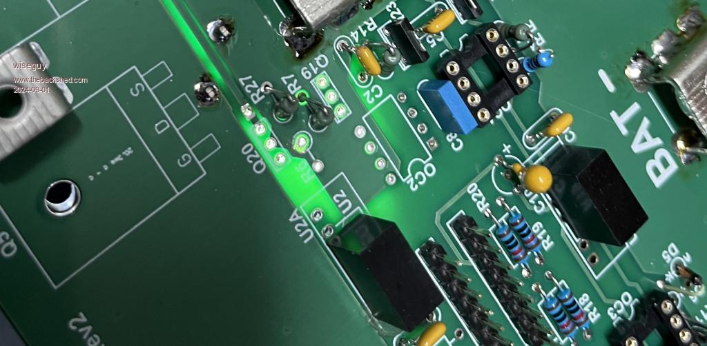

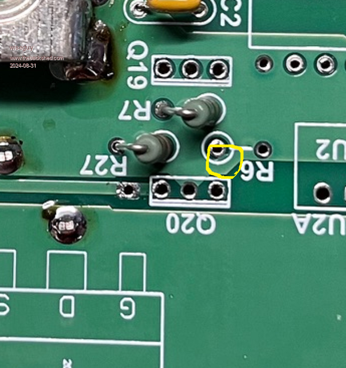

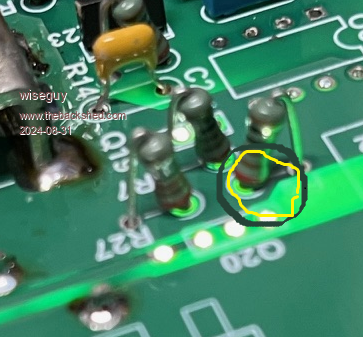

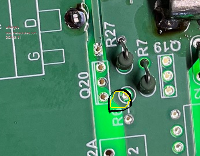

I have been building up a second 16 FET Power PCB for my dual stage inverter.  After soldering the last component in place I ran some tests. Which for 3 banks I got expected results but the fourth bank went into current limit (supply to Dc/Dc was 12V @ 50mA).
After removing the 4 components that could have been causing a short to ground it was finally located under R6.  The insidious fault was a small section of ground plane that was not etched to clear the flow through joint under R6.
As far as I can ascertain the boards from JLPCB get 100% testing for continuity and also to identify short circuits. I believe that they can include 4 wire kelvin tests for guaranteed 100% defect free pass but at extra cost.  I was not expecting shorts between tracks and although Warpspeed implied it never happens these days as I pointed out to him at the time, my experience is different, BTW I miss him on the Forum.... The 3 photographs I took to take up this matter with JLPCB I decided to post here.  I am disappointed that The 2oz main FET Power PCB, which I might add has a much higher cost than 1oz, I have endured a time consuming search for the fault which should not exist.  I still have to remove the fault and as the board is 100% built I cannot afford to make a mistake or accident in fixing it.
The area is almost hidden under the resistor - it is not just a light shadow.
The reasons for presenting this issue here are two fold, one be cautious about assuming that the blank PCBs I supplied have been manufactured defect free. Two this emphasises the benefits of testing at low currents the functionality of the various circuits before applying full power. Lastly it makes a bitt of a mockery of their full electrical testing (but not Kelvin tests which is not meant to discover this type of fault anyway).

I just had a look at the 2 power boards and around R6 looks the same as in your photo above, I will have to get to it using the big illuminated magnifying glass.

I have one V2 PCB, put it under the electronic microscope, the same fault, R6 is effectively shorted, looks like a careful job for the Dremel - that is just ridiculous.

Just checked mine - couldn't see under the resistor but R6 is shorted.

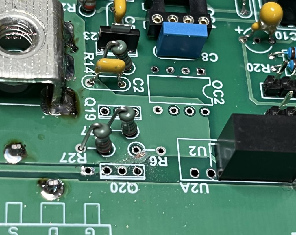

Sorry gentlemen all the Power PCBs have this damn defect and need to be fixed. I have lodged a complaint to JL with pictures I'll let you know their response. It would be nice if they offered to send replacements to everyone I have already sent them to but I suspect I will be lucky if they will even offer to replace them or give me a store credit (I would push for replacement).
If anyone would rather replacements (assuming JLCPCB will come to the party) I am happy to send out their replacements if you are happy to pay for postage.  If you have already loaded the parts and dont have a good solder sucker I suggest sacrificing the 1K resistor by cutting the leg at the top and then pulling both halves out after heating with the iron and using solderwick (I call it "track lifter" - be careful!) to clean out the holes.
If you have a sharp scalpel/hobby knife you can cut the sliver off but being 2oz board it is not all fun to do. It is also good to use a backlight behind the board as it helps to see the results.
RogerDW and Bryan being locals we can work out picking them up sometime - if we get the offer of replacement...
My repair in progress started with a dremel
Finished using scalpel
