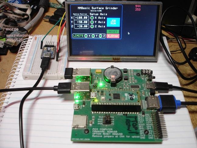

mozzie
Joined: 15/06/2020
Posts: 469
Posted: 08:55pm 22 May 2026

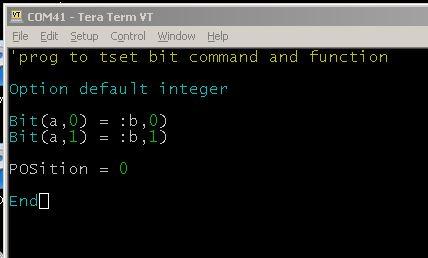

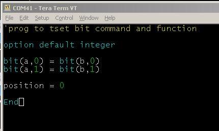

G'day,
Should have been in bed hours ago but couldn't resist giving this a try
Initial testing shows this is an awesome concept, can now do HDMI with touch quite easily
Couple of minor bugs plus the previous comment above regarding CLICK:
BIT command is replaced with : in programs.
pos becomes POS in command and variable names.
The Pico-Zero showed up as a USB drive a couple of times but a pattern is hard to discern.
> option list
PicoMiteHDMI MMBasic USB RP2350A Edition V6.03.00RC11
OPTION FLASH SIZE 4194304
OPTION COLOURCODE ON
OPTION KEYBOARD US
OPTION RESOLUTION 800x480 @ 333000KHz
OPTION DISPLAY 40, 100
Now its time for bed as the sun comes up
Regards, Lyle.

Posts: 12055
Posted: 06:36am 23 May 2026
  Quote  BIT command is replaced with : in programs.
Can't replicate - please post a program that demonstrates the issue

G'day Peter,
Not the original program but typing the following into the editor:
Save and re-open editor becomes:
Also won't work at command prompt:
> bit(a,2)=bit(a,3)
Error : Cannot find A
> dim a
> bit(a,2)=bit(a,3)
Error : Invalid syntax
So it looks like the function is playing up rather than the command.

Looks like the Pico-Zero is not resetting properly due to power via the interrupt pull-up, please ignore.
Before I get too far messing around with the Pico-Zero sending touch via USC-CDC, are you considering adding resistive touch support for the GUI functions in the VGI/HDMI firmware or is this a step to far?
P.S. Can anyone remind me how to clear the Cache on WIN7-32bit, had a brain fade and can't remember
Regards, Lyle.

  mozzie said
... are you considering adding resistive touch support for the GUI functions in the VGI/HDMI firmware or is this a step to far?
is there any hardware available for res-touch with HDMI/VGA monitors that will support that screens (and the controller supported by MMBasic)?
73 de OE1HGA, Gerald
mozzie
Joined: 15/06/2020
Posts: 469
Posted: 08:13am 23 May 2026
G'day Gerald,
There are quite a few available with the XPT2046 resistive touch in 4" to 12" sizes, hence the question on this specific controller, as support is already in the LCD firmware.
The pic in the post above has a Pico-Zero reading the XPT2046 on the 5" touchscreen and sending the co-ordinates via USB-CDC to the PicoMite HDMIUSB. I guess the advantage of this is you only use 8 pins for the HDMI, none more required for touch etc.
Don't want to waste time on taking this idea further if Peter is thinking of baking it into the firmware.
Regards, Lyle.

Posts: 12055
Posted: 08:34am 23 May 2026
  Quote  So it looks like the function is playing up rather than the command.
Bummer, I've run out of function tokens and BIT( is the last one defined. Some nasty surgery needed.
