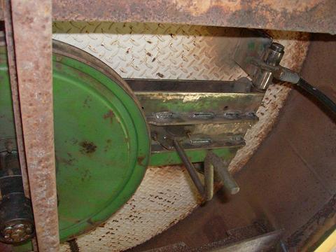

Vawt, going in a big way...
I needed to make one more trip after tools so I brought along the camera...
This is a break...don't look much like one, but it is. I installed a smaller drive pulley just over the original pulley, and in doing so the allowed space for the hydralic break caliper was reduced...did'nt find out untill I had everything back together that I did'nt have enough room. So I made up this system to replace it.
This is the break pad end, "duh", as you can se there is'nt a whole lot of room up here...I had trouble getting this picture.
....Mac46

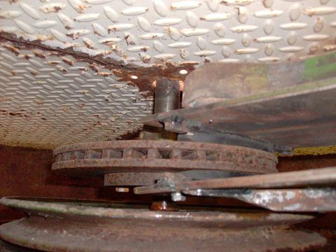

Ok, thats better, I've got my glasses on now. Sorry about that.
This is the break disc end.
Mac46
