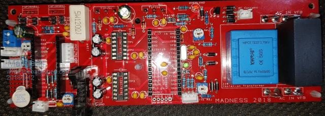

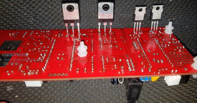

Posted: 07:18am 12 May 2018
Almost ready to run the control board, just need to clean the flux off and check it. Bottom photo show where the I am mounting the fan MOSFETs and TIP35c's so the can be screwed to the power board heatsink.

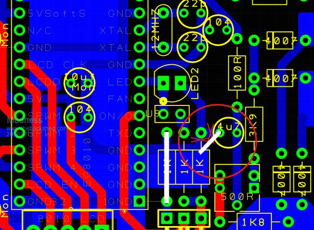

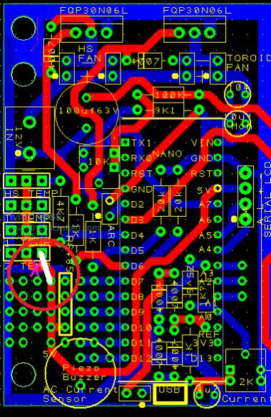

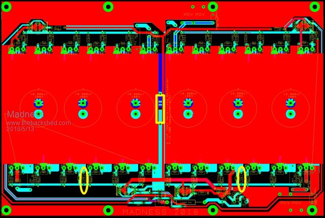

Madness
Joined: 08/10/2011
Posts: 2498
Posted: 07:08am 13 May 2018
I have effed up a little, couple small errors on the control board.
You will need to cut the 2 tracks as per below and connect the 4u7 cap to ground, replace the left 1K resistor with a wire link.
The 5V is connected to the wrong spot for the temperature sensors, so the track needs cutting and a link soldered in as shown.
Also R44 and R46 on the power board are shown as 10 ohm on the silkscreen, they should be 5K1 ohm.
Apart from that seems to be all good I have had the Control Board and Power Board running but just with 4 FETs and no caps so far. Unfortunately, I have had other things taking up my time ATM.Edited by Madness 2018-05-14

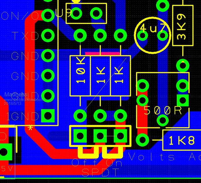

Posted: 07:29am 13 May 2018
While you are modifying your control board, may I suggest you solder a 10K resistor from pin 6, EG1810 to ground. Its a safety device that lets you unplug the power switch (accidentally ) while the unit is still powered up and nothing happens. No instability blow ups .
Madness
Joined: 08/10/2011
Posts: 2498
Posted: 07:40am 13 May 2018
Sounds like you are speaking from experience Klaus?
So like this.
yahoo2
Joined: 05/04/2011
Posts: 1166
Posted: 08:20am 13 May 2018
  Madness said   Hi Yahoo,
That is the off position of the SPDT switch connects to ground via the resistor.
I will see if I can post some clearer pictures soon, just redoing a lot of the area around the Nano to include temperature sensing, fan control and current sensing.
Also a slight change to the mounting holes so the TIP35c's and MOSFETs for the fan control can be flipped (if you want to) under the PCB and screwed to the +48V heatsink
Dammit! we were looking right at it almost a month ago and still missed it! I knew something wasn't right in there, I was just too slow to figure out what.
Madness
Joined: 08/10/2011
Posts: 2498
Posted: 08:31am 13 May 2018
It works but does not turn off and the LED did not work as it was.
I should have look at it more seriously when you raised the question Yahoo. Fortunately, it is not hard to fix.
