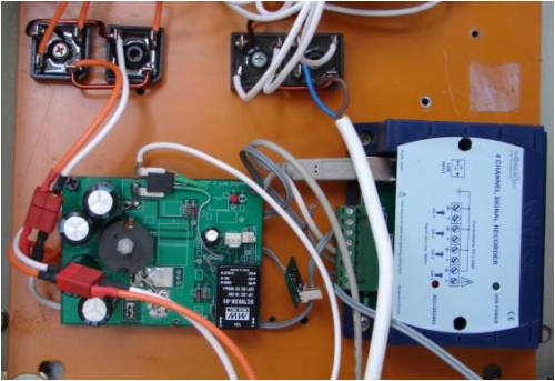

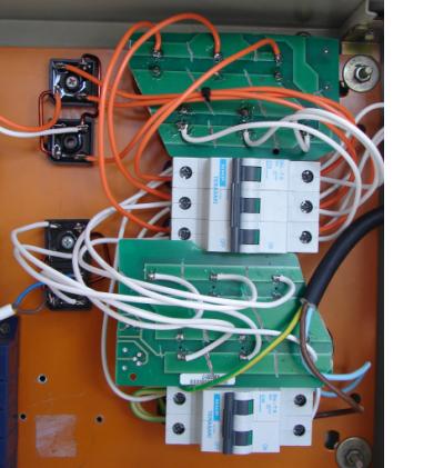

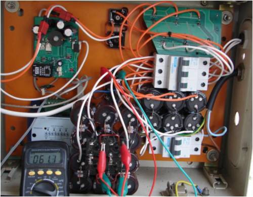

I have been asked to provide some pictures of the capacitors used.
The first pic is of the general layout. This includes the the mill input shorting switch at the bottom. Above is the PCB with the 48V cct, AC coupling caps. Above this is the 24V cct, AC coupling cap shorting switch. Above this is the PCB with the 24V cct, AC coupling caps. To the left are 2 of the 3phase bridge rectifiers.
This next pic is of the cct to give variable boost to 24Vnom battery on the left. On the right is the 4 channel data aquisition unit. The rectifiers are shown as well at the top.

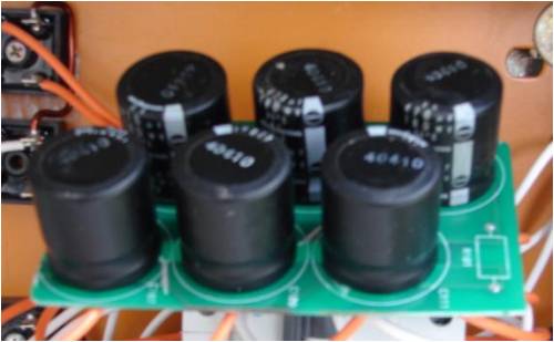

The next pics are of the 2 back to back cap PCB's
The top PCB is the 470uF,180WV set, and the bottom is the 330uF,400V set. I reused the PCB's, by cutting tracks and reversing cap orientations.
This is not a doubling arrangement. These are 2 separate AC coupled ccts. The boost cct works on the 12V-24V mill output. The 470uF set works on the 24V-48V mill output. The 330uF set works on above 48V output. The boost and 470uF cct feed current to the 24V battery. The 330uF cct feeds current directly to the gridfeed inverter. There is a separate DC-DC boost converter that feeds current to the gridfeed inverter when the 24V battery voltage is above designated SOC voltages set by the PL20.
The systems all work together to get the most from the available wind energy, until furling.
I intend to eventually use a quadrupler,doubler, and direct AC coupling ccts to directly feed my 48V grid inverter, without any battery, or DC-DC boost ccts. This will require 42 [the answer to life, the universe and everything] capacitors.

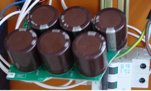

A 7phase doubler, requires 7/3 times more capacitors and rectifiers for a std 3phase arrangement. This would not be a problem electrically. This would require 28 caps and 8 bridge rectifiers.
My doubler is a 4x3 hotmelt glued block of 330uF,400V caps, with rectifiers wired together, atttached with standoffs to the caps. The AC from the mill is connected to the cap connections down the middle.
For a 7phase, I would just make a 7x4 block. This doubler is placed in parallel with the normal 7phase rectifier. Windmill cutin rpm will be halved.
Here is a pic of my capacitor, voltage doubler.
The doubler is the block in the centre bottom. The meter is reading the DC output. The block arrangement keeps the cap & rectifier interconnects as short as possible. There is less risk of shorts and mistakes as well.
Gordon.
PS This is only a temporary arrangement, conected with clip leads. In this instance, the grid connect inverter is connected as well as the 24V battery. The purpose of the doubler in my application is to reduce the loading on the battery boost DC-DC converter. The caps seem to be more efficient than the inductor/mosfet/diode, but there is no voltage regulation or current limiting components. I have measured 140VDC on the caps, with the grid connect inverter disconnected, but the battery still connected. I intend to add a detector to the grid inverter to enable the doubler only when the inverter is supplying power to the grid. This may be a custom made optocoupled/isolated 3phase SSRelay, that will reduce the voltage protection needed to the battery only, that is already in place.
The capacitors I used in the doubler were 330uF, as these were a value I had 12 of. This may be too high. 100uF may be a better value for a 7phase.

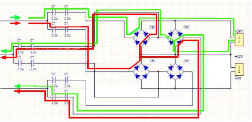

Gill
Joined: 11/11/2006
Posts: 669
Posted: 10:39am 13 Dec 2008
robbo,

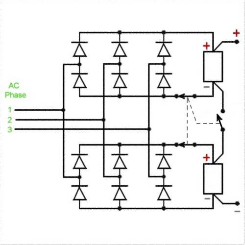

In response to your questions I have looked at that circuit on page 15 of this thread and would not use it.
I am of the opinion it is not a voltage doubler but a load 1/2er and battery paralleler.
As drawn, it short circuits and consequently bypasses the lower battery. The caps are not in a charge pump configuration as in the traditional 3 phase voltage doubler and serve no function in that regard.
If you feel you must use this circuit you would need to fix the shorting but in doing so you loose the ability to draw off the seriesed batteries whilst in the low wind mode which kind of makes it awkward. Here is the same circuit without caps and shorts.
Perhaps Gordon will comment further?
Cheers Gill _Cairns, FNQ

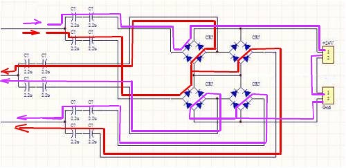

Gill
Joined: 11/11/2006
Posts: 669
Posted: 01:31am 14 Dec 2008
John,
There were two viable parallel circuits through both batteries (for clarity, only the top greed shown)but the 3rd path (the short) dominates, passing near all the current.
With 3 phase, the + 1/2 cycle of one phase is the - part cycle of the other two phases so a short, though presented as one 1/2 cycle is a total short of the circuit; all phases, all cycles.
Gordon,
Sorry, the edited schematic is also shorted. I too have these 'Blond Moments' as most will have noticed. I'm sure you'll get it sorted.

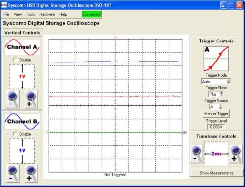

Joined: 01/09/2006
Posts: 2127
Posted: 06:19am 14 Dec 2008

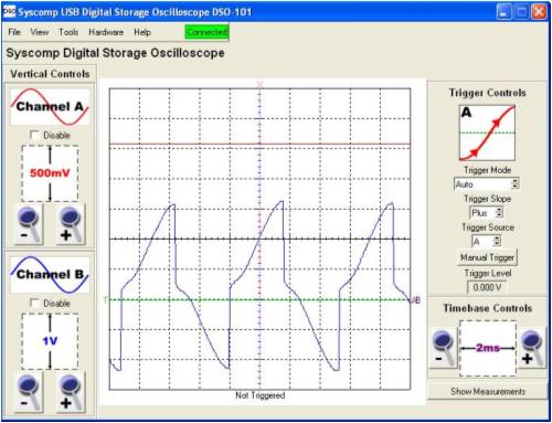

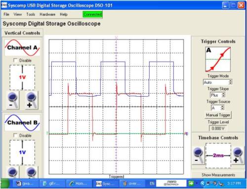

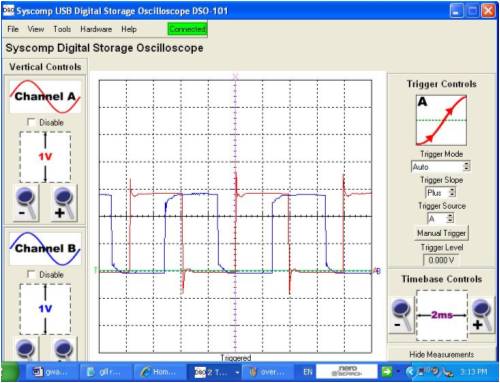

Hi Gill,

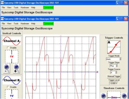

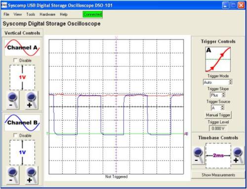

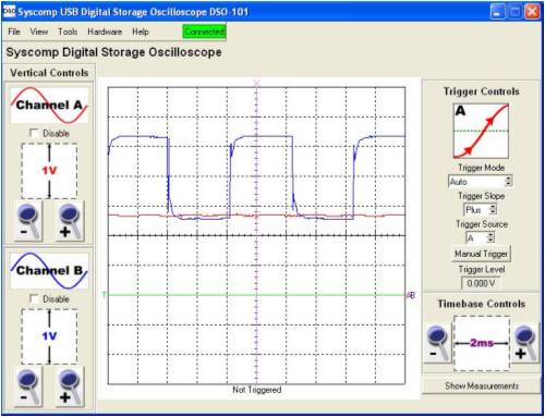

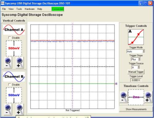

I will present some DSO readings, [actual measurements, and not an attempt to draw what is thought to happen].
For clarity, in most of the tests, the waveforms are referenced to system [battery & grid inverter] -ve.

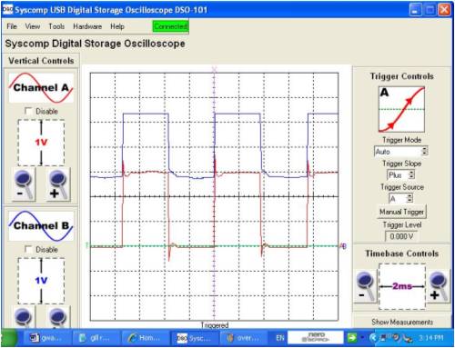

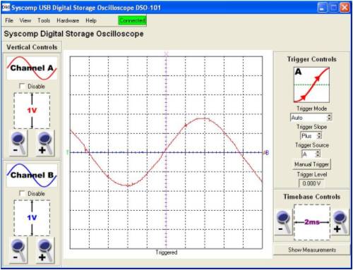

I present,
1. a single phase, mill side of caps, with the DC voltage present at the upper connection of the voltage doubler as a reference.
2. the DC present on the top of the doubler with the DC present at the joining of the seriesed bridge rectifiers
3. the AC present on the top rectifier, with the DC voltage present at the joining of the seriesed rectifiers as a reference.
4. the AC present on the bottom rectifier, with the DC voltage present at the joining of the seriesed rectifiers as a reference.
5. the DC voltage present at the 24V battery with the DC voltage present at the joining of the seriesed rectifiers as a reference.

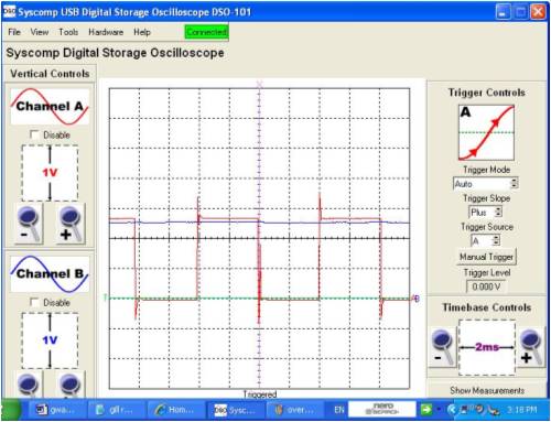

6. the between phases voltage just befor cutin.
7. the between phases voltage at an approx 250W power level.
The doubler was functioning during all of these measurements. The windmill is a std F&P series 100, wired in delta. The windmill is only AC coupled to the loads. There is no DC path between the mill and the loads. The DSO probes are x10 settings. The ranges I have left shown for clarity. The green line is the zero reference line for both traces. This has been moved down to allow more visible use of the DSO screen. The timebase was free running, and not triggered.
pic 1.

I have provided the output waveform between phases before cutin as a comparison [pic 6], and that during a mid range power output condition [pic 7]. The capacitors do change the sine wave significantly. The flat topping that normally occurs with a battery loading is not evident.
You will also note the strong correlation in voltage between the battery voltage and that present at the joining of the seriesed rectifiers [pic 5]. If there was "shorting", then this could not be.
You will notice that the voltage present at the joining of the rectifiers is almost identically half that of the doubler output voltage [pic 2]. There is no bypass capacitance from the seriesed rectifier joining to ground.
If there was any "short" that you describe, then this would be evident in the DSO traces. This would be manifested in some AC that would be visible, on the recorded voltages, primarily in the voltage recorded on the seriesed connection between rectifiers.
If there is a short that you believe is there, then this somehow results in an increase in power supplied to the loads, with no discernable detrimental effects.
You will notice the AC waveforms presented [pic 3, pic 4]. These are square wave in form and close to 50% duty. One waveform indicates power from 0 to half the doubler voltage. The other waveform indicates power from half the doubler voltage to the doubler voltage. These are in phase, so the voltages are additive.
I cannot provide much more proof. The theory you present does not seem to be backed up in the measurements I have recorded. This may be due to the square wave nature of the voltage waveform, that reverse biases the diodes, you indicate are providing a short.
I welcome anyone else to do the same types of measurements as I have and come to a conclusion that the cct will present a short.
PS. I think you will find that a clue as to what is happening is given by the waveforms of pic 3 & pic 4. The voltages on the caps prevent the current from going the wrong way. The currents are steered through other diodes, and do not present a short.

Gill
Joined: 11/11/2006
Posts: 669
Posted: 11:23am 14 Dec 2008
Gordon,
On further study of the circuits old and new it is necessary to revise my use of the term 'short' as it applies to them. The circuits do short circuit the load (battery) this still effectively draws most current until I suspect the (red)caps reach saturation.
I note the caps in the shorted legs (red)are in parallel with the load and all current passing through them is lost to the battery. Once saturation of the red caps is achieved, the seriesed caps(violet) will then pass current and this circuit includes the battery.
Back-to-back caps in series and parallel and called a voltage doubler???? You don't seem to be aware of any of the processes at work here. But so long as you are happy with the results.
Gill EDIT:
Haa! I see now. On the negative 1/2 cycle the former serisied caps are now in shunt and are charged to saturation then the former saturated shunt caps are now in series and discharge as a charge pump through the battery. The voltage is effectively doubled.
OK. So why don't you explain it simply without all the crap?Edited by Gill 2008-12-15
