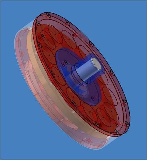

My latest AxFx mill is finally coming along. I have concluded the latest coil testing, and the 75turns, 0.18ohms per coil produce 3.5VAC @ 60RPM. This gives 10.5VAC per phase. In a star config, this should be 17.8VAC. 52V cutin on the Latronics should be about 130RPM. May still be a little low RPM, but I want to try a normal stator config, without caps. The output wave shape is a good sine wave, so there is potential for a delta config as well.
I have made a reusable moulding system, and this will make it easier to cast a new stator. I will have two similar alternator units, and I hope to be able to compare changes.
Gordon.
PS: I have 3D CAD modelled the new unit, so I can post some pics if required.
Here is a fully assembled view.

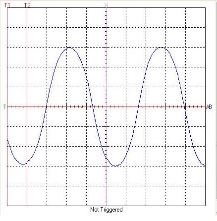

Here is a pic of the output waveform.

Well the waveform looks better than I had hoped for the magnet spacing.
Cut in looks good for low wind performance.
What does the stator mold look like?
......you sure you need 24 bolts to hold the plates on....
R is a little higher than I would have guessed.... although if you furl early, this may help low wind performance (softer on the TSR) perhaps.
...........oztules
GWatPE
Joined: 01/09/2006
Posts: 2127
Posted: 12:31am 03 Mar 2010
  oztules said   Well the waveform looks better than I had hoped for the magnet spacing.
I was a little surprised as well. I had thought there would have been a little more flat topping. The coils are 2mm larger ID than the magnet OD. This has pushed the coil resistance up a bit. The stator should be able to be delta wired, so the resistance is looking pretty good for that.
  oztules said  Cut in looks good for low wind performance.
The cut in is a little low, for a star connection, so I will look at delta. I will bring all the terminations out, so I can wire any way. Bring out the coloured wire.
  oztules said  What does the stator mold look like?
A couple of concentric rings. I have a round steel plug, that was laser cut for the inner alignment point. bolted to a flat surface. A steel ring is placed around this, and this has small bolt holes to attach it with precision to the axle adapter plate. A larger ring is placed equally around the centre plug. This is also bolted to the flat surface.
The central thin ring can be bolted to the axle adapter plates to allow the main mounting bolt holes in the newly moulded stator to be accurately through drilled directly from the holes in the axle adapter ring. The thin, precisely drilled ring can be pushed out and reused for other stators.
This sounds a bit to do, but there is really only some thread tapping, as all the parts are laser cut, so a bit of filing, and polishing is all that should be needed. The important aspect is no additional machining should be needed to make more stators.
  oztules said  ........you sure you need 24 bolts to hold the plates on....
There are 12 x 4mm bolts on the rear plate, and 12 x 6mm bolts on the front plate, that bolt the magnet plates to the spacer ring. The front [blade mounting magnet plate] is bolted to the axle hub with 3 x 6mm bolts, and 3 x 10mm bolts. This is all that is left from the F&P mill. [The front plate, spacer ring, and axle, and bearing hub assembly].
Hopefully, the only machining that needs to be done in a complete unit, is in the spacer, and the surface that is welded to the axle to mount the stator assembly. I happen to mount the flat surface directly to my yaw box, so adapter spacers are needed to position the stator between the magnet rings, to suit the internals and the bearing hub, for clearance. I hope to test with thicker magnets and other stators, and should only need some additional adapters laser cut. No additional machining.
Anyone with good access to a machine shop would probably go about this differently.
I will probably be able to wind the coils with 2 in hand, of the wire I have. There appears to be more wire space, now that the magnets are placed at a larger dia, and the total turns is down to a manageable number.
This is all good to lower resistance. 15mm mags will help again one day.
I would like to make some coils that are multi layer. I like the idea of 2 layers of wire coils, that are wound from the inside out, so both ends are terminated at the outside of the coil. This produceds non polarized coils. This will prevent the bunching of the wire that seems to be unavoidable when the coils are wound back and fourth to the outside. I think that very precise coils could be made, with possibly layers of glass between.
These are some aspects that I can try, once I have a flying windmill that is adaptable. I will need another set of magnets to leave on my test unit, to continue testing. The final alternator will still only be matched to my blades, and loading, when it flies, but at least other configs can be worked out to suit other loadings, and blades.

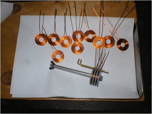

Gordon, is this the coil winding method you are talking about?
Or is it some other way I don't know about yet?

Posted: 11:25pm 03 Mar 2010
Hi Tinker,
A bit hard to see from the pic. I am not new to this technique. I made my original overlapping/interleaved coils a long time ago, I will need to disect one I had spare, and see if the solid wire will work the same way. This is a long time project for me.

Posted: 03:09pm 04 Mar 2010
Yes, unfortunately reducing the picture size also reduces the definition.
I made these coils some years ago when I started building a miniature AXFX. It was to be a triple rotor/ dual stator affair - unfortunately I got the coil connections wrong and they are all epoxy encapsulated. Project abandoned...
The coils were for 15mm dia neo magnets. Wire size is 1mm, coil thickness is only 2mm (2 layers). Winding is started from the middle of a pre cut piece of wire and requires a former like the one in the picture.
Your comment about "non polarized coils" with this technique has me wondering just what that means. Care to elaborate?
