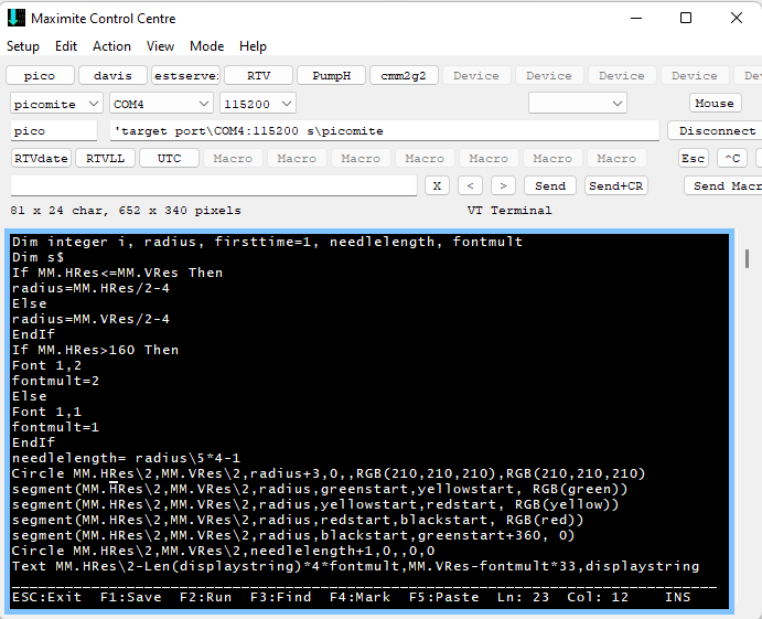

  Quote  The Pico, on first connection, is in command line mode. You set stuff up there. Press F4 and you are in the built-in editor. Press F1 from there and you are back in Command line or press F2 to run your program immediately - you don't need to download it first as it's already there. If your program stops for some reason then you are returned to the editor with the cursor on the line where the problem occurred. If you want a big editing screen set Tera Term (terminal settings) to the number of lines and characters that you want. You can also set the font etc. Then use OPTION DISPLAY lines [,chars] to match what you set Tera Term to. I currently use 40 lines of 120 characters. I could easily fill the full screen if I wanted to. All the function keys are labelled across the bottom of the display, so very easy to remember. :)
While this makes sense and all... I find the editor (when used inside MMCC 2022-08-31) to be pretty much unusable...  the Terminal in MMCC seems to have no idea what it's doing and editing just makes a mess.
Works fine in Teraterm.
Posts: 6549
Posted: 10:24pm 09 Sep 2022
  pwillard said  While this makes sense and all... I find the editor (when used inside MMCC 2022-08-31) to be pretty much unusable...  the Terminal in MMCC seems to have no idea what it's doing and editing just makes a mess.
I agree that TeraTerm is a much better terminal program but could you expand on "editing just makes a mess"
If I don't know there is a problem, I don't know to try and fix it.

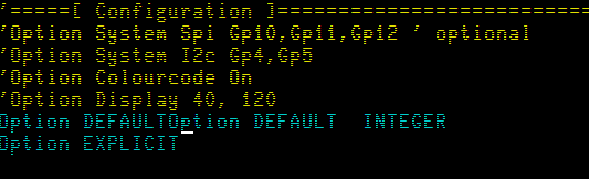

It's kind of hard to explain. I'll focus on one behavior I see.
I'm using a picomite, latest beta, latest MMEDIT and MMCC.
I have a program running. (note: It's using VT100 sequences for cursor positioning)
I'll give you an example.
If I CTRL-C in MMCC to get command mode back and I then enter EDIT mode, I can move the cursor all around, no issues it seems... but let's say I move the cursor to the end of line 14.
' References:
I move the cursor to just after the colon ":" and press the SPACE key to add spaces after it.
I suddenly get:
' Reference:' Reference:
Heck, that's not right... It's like when I press the spacebar... I'm getting chars from a line buffer pasted in somehow.  Makes editing difficult if not impossible.  The unintended characters always come from the current line.
Another example:
' Program:      Vttime<-Cursor is here and I press space
becomes...
' Program:      Vttime' Program:      Vttime
And it's not just end-of-line... if I go to the middle of a line and press the spacebar to add spaces... it inserts all the characters in the line up to that point where the cursor is.
I press the spacebar with the cursor between DEFAULT and INTEGER
Edited 2022-09-10 09:35 by pwillard
Posts: 6549
Posted: 06:01am 10 Sep 2022
Another update.
This one includes the Linux fixes.
Fixes a bug in picomite editor when OPTION COLOURCODE ON is set. When colour is turned on, the pico has to start at the beginning of the line whenever you edit it to determine the correct colours to use. The way the pico moved to the start of the line is different to the cmm2. Both methods are valid but I hadn't allowed for the pico method.
You now have to select the end-of-line being received - leaving it at CRLF should be OK for most uses.

Thank You.  EDIT works again.

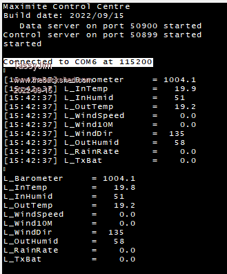

Today's update is for the Linux users. Printing now works.
If you have colour set in the editor, the printout will be in colour.
Likewise, if you are showing physical line numbers, they will be printed.
Word-wrap for long lines is a bit brutal.
The other addition is the option to timestamp incoming lines of text.
It works well with print statements but not much use if you are sending VT escape sequences. The keep-alive sequence sent by the pico after 30 seconds of inactivity is usually not a problem.
