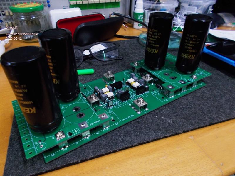

And so it begins at last.
I built Wiseguy designed power board with isolated supply's and opto-isolated drive.
I tested the boards 3 isolated supply's and the 4 Opto drivers - all worked first go.
The picture shows the mock up with the Screw in Caps boards that Mike designed for me. I don't know if I will use all 8 caps yet.
I have the older boards to swap in for testing, they are populated with 5uF 480v mains caps for testing. That should remove some HF spikes, and not have as much splat capacity as 80,000uF if something goes wrong as I work up to full voltage, and gradually increase the current limit from the DC supply, and I always use a swamping resistor between the Toriod and FETs for initial low power testing, especially at full voltage.
Tomorrow I plan to start mounting the FETS and Drilling the three Heat sink Bars. I'm mounting the FETs directly to 38mm x 22mm heavy aluminum bars, the FETS are  sandwiched between the board and these Heat Bars which become part of the Board assembly.
The Heat bars in turn will be isolated when bolted to a huge heatsink after all testing is completed.
I also started on the Controller, but taking my time to get everything right.

That looks rather familiar, very neat !
Those are some serious looking caps.
The little square parts on the ends of the capacitor boards were intended to be cut off & separated to make very useful 3mm insulating washers.
I assume that you remembered that the 8 screws mounting all the FETs under the + supply rail plane need insulating bushes that fit into the PCB holes so the screws dont short the + planes to the heatsink. I also used the square fibreglass washers on top of the insulating bushes.
To tension the Mosfets onto the silicon pads, on the 3mm screws, I use rectangular section 3mm spring washers that are ~ 0.7 of a mm thick and about 1.5mm wide. I tighten the screws so the spring washer has just become compressed enough to resemble a flat washer and no further. Has worked fine for me for many many hundreds of FETs.
Cheers Mike

Thanks Mike, yes just a mock up with the cap boards to check clearance and correct orientation of the caps, I have to cut the washers off after a band saw blade change.
No problem with shorting anything, I've done this many times building high power 1kW amplifiers. Just getting old means checking everything 20 times on different days in case one was a seniors day. I'm screwed if I get two in a row

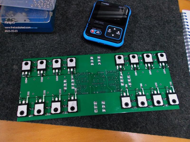

Thought I'd post a photo of the next stage of the build, 16 HY5608W mounted, ready for the board to be bolted to 3 intermediate heatsinks bars.

  KeepIS said  Thanks Mike, yes just a mock up with the cap boards to check clearance and correct orientation of the caps, I have to cut the washers off after a band saw blade change.
Cutting fibreglass PCB's with a bandsaw is *really* tough on the blade, blunts them in no time.
Here is a little project for you: make a PCB cutter using one of those 1mm abrasive disks.
How? Easy, I used an old mini angle grinder gearbox and adapted the motor shaft to fit a drill chuck. Make a little table to fit it under and if you use a slow turning drill it will cut PCB's perfectly.
I think I posted a picture of it a few years back.

Posted: 09:52am 03 May 2023
It's an old blade kept just for this kind of work, I use it to cutout sections of old Grid tie inverters boards as well, yes it does get blunt but its a big blade, cost me $15.00 to get resharpened. Biggest problem I have with the abrasive cutters is the very fine invisible dust that drifts off, for some reason I'm really allergic to that type of dust. Yes I can wear a mask but I don't need to on the BS due to massive dust extraction.
Still a great idea though, I might revisit it with some modified dust extraction when I get the time if it saves me changing a blade for small jobs.

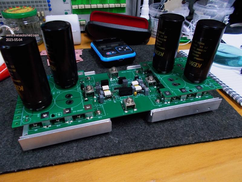

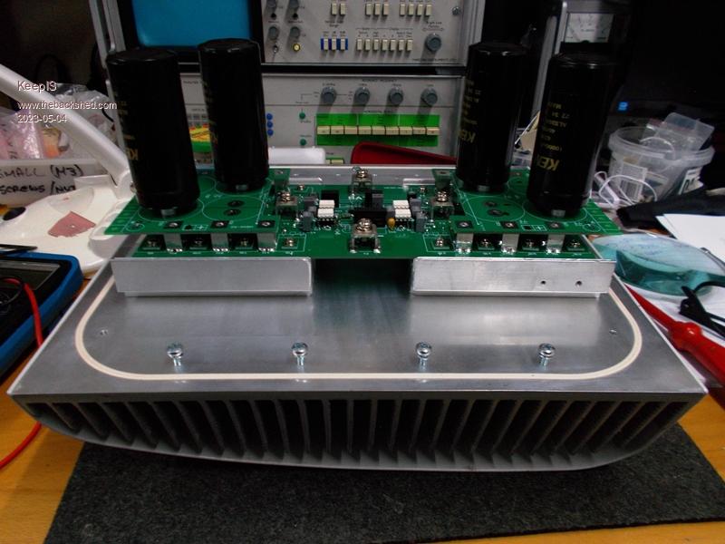

Cut down the old scavenged Heat sink bars, tapped 16 x 3mm threads, everyone of them perfectly aligned, gotta love a small drill press to start the threads "manually" in seconds with perfectly vertical alignment on the aluminum block, then simply finish using the hand tap. I just finished fitting them to the power board. A job I was dreading that turned out to be simple and pretty dam quick for a change.
I know others have their way of doing this but this is perfect, I guess whatever floats your boat.

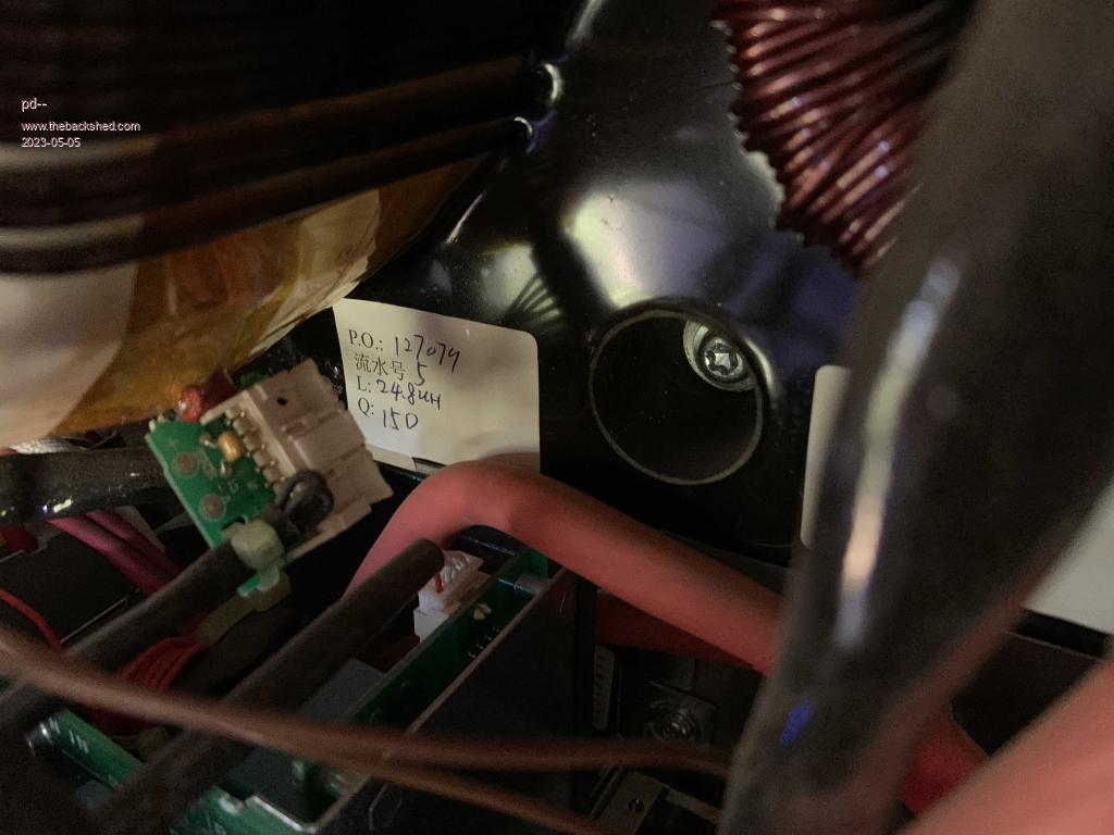

Below is a photo from a 5kw 48v commercial inverter you can see the sticker with
24.8 uh between the transformer & choke
The unit switches @20khz and uses 6 x IFRB4310Z fets in each leg of the bridge
There rated at 120A continuous & 560A Pulse each
I recon your on the money there Mike
