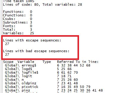

Quick heads-up. The next release will include OPTION ESCAPE. This enables escape sequences in strings and must be used in any program where you want to use them. You will be able to also use it at the command prompt but like OPTION EXPLICIT it will be disabled again by the RUN command and so will need to be included in the program. This change will ensure that the new functionality won't break any existing programs
Posts: 6603
Posted: 08:17pm 18 Mar 2023
And the next MMEdit will include a list of escape sequences, both good and iffy in the variable report.
Just to make conversion easier.
Hans
