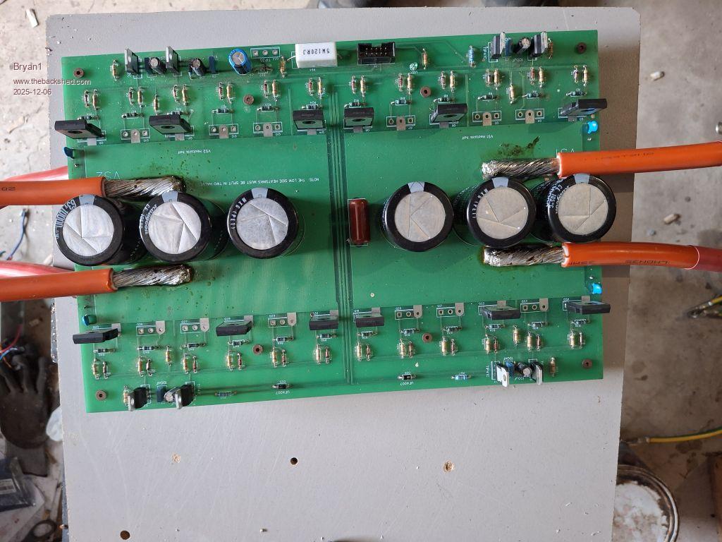

Bryan1
Joined: 22/02/2006
Posts: 2297
Posted: 07:55am 06 Dec 2025
Went upto Rogers after work today and what a learning experience it was helping solder on the wire to the board
So VS1 & VS2 now have 50sqmm wire on each pad and had enough length off the toroid wire for the battery connect so 65sqmm
So the 50sqmm wire for VS1 & Vs2 will be bent down to attach to each choke, now we did measure the inductance using Rogers meter and both chokes came in a 24uH within a point of each other so good to see they are matched.
Now I did mention about charging the caps before turn on and suggested the battery connect would do it and got told well the inrush of current to charge the caps will show the fireworks   and a bleed resistor is required to limit the current on the positive rail to charge the caps. So lesson learned and that is one thing I never read in all the reading on this inverter.
So one step closer.

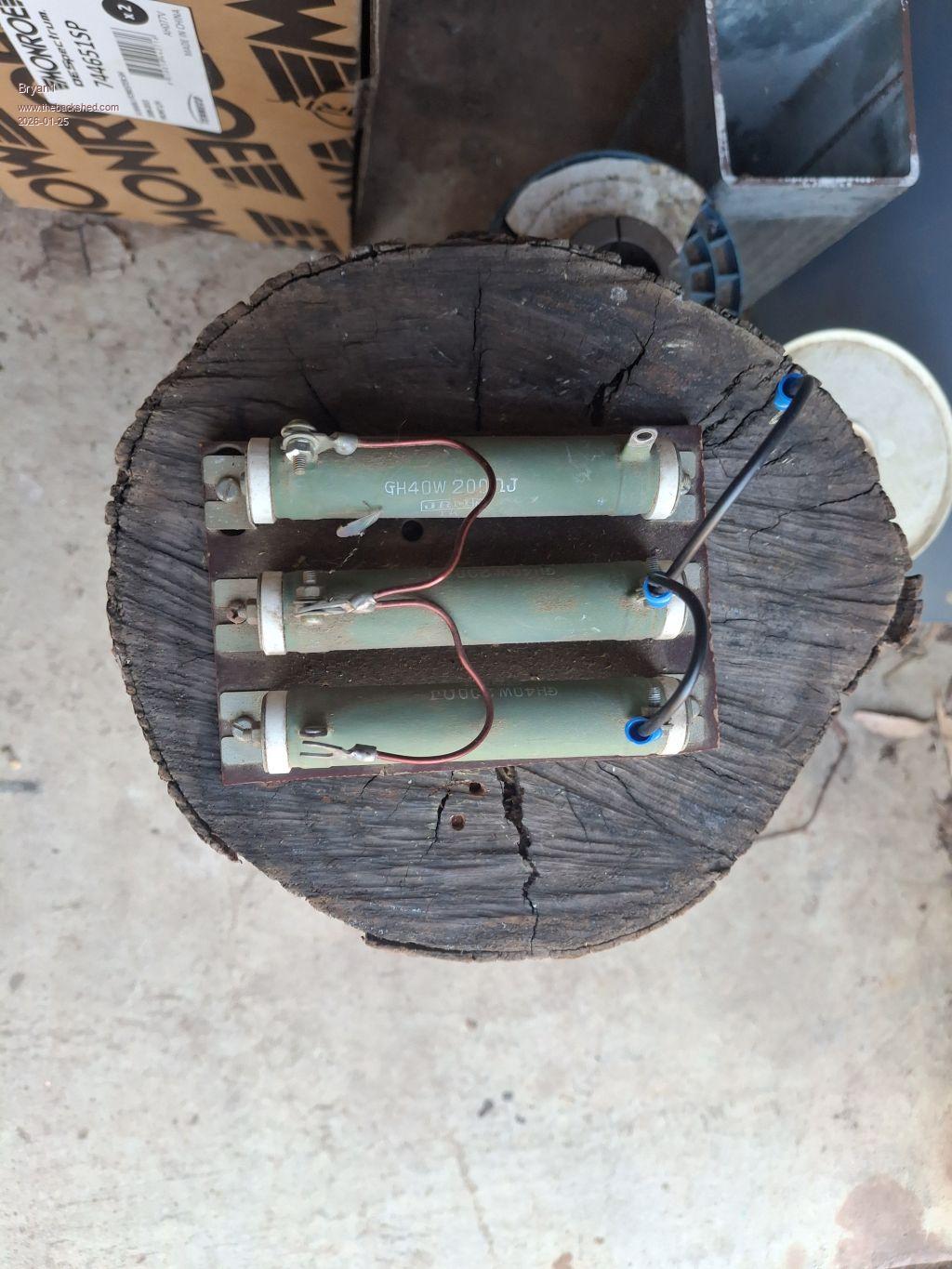

Well in my gear I did find 3 off 40 watt 200ohm resistors that all measure within 3 ohms so I could use one of them to slowly charge the caps before the first turn on.
Now for members that have build this inverter how did you guy's go about charging the caps

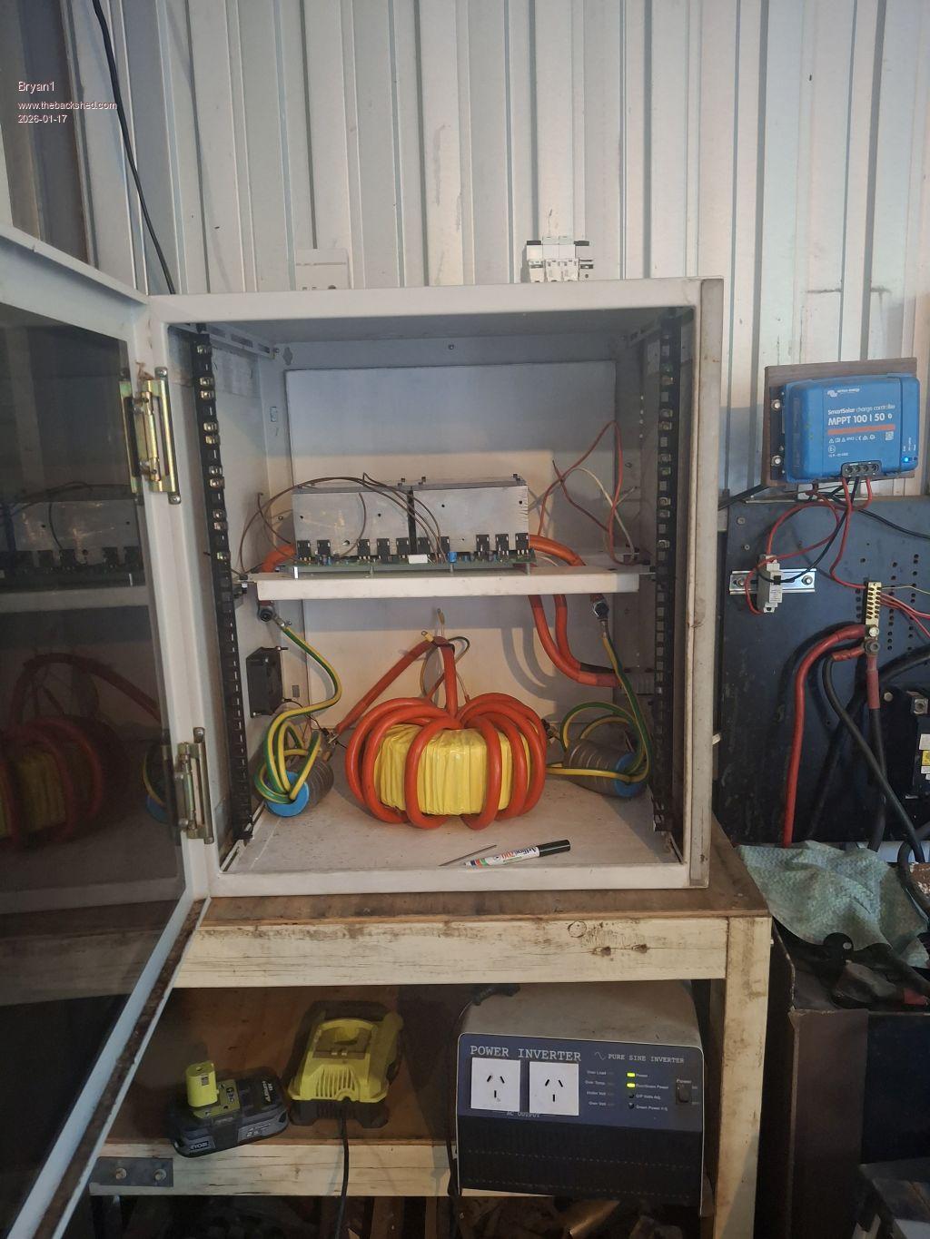

G'Day Guy's,
           Well finally had an afternoon to work on this inverter after work today and after installing the fan got the box in it's new home and got the Anderson Connector all done
So getting closer...

Well got a bit more done today and it was taking 3 steps forward and one step back   Found some old terminal block so cut it in half and screwed them onto the perspex plate only to find one of the closures was buggered   So that idea is going to be scrapped and I'll machine up some new terminal blocks.
Then got onto the finish soldering the brain board and soldered up the lcd board where silly me didn't see the front holes on the nano aren't used and lost a couple of pads desoldering.
So went and grabbed another Nano and soldered everything in properly and found out the hard way where last time I had to use my good laptop to program the nanos last time as both the linux and my shed computer wouldn't program the Nano.
I will get more done thru the week and hopefully next weekend it will be finished then the fun can start and see if it will power my mig welder.

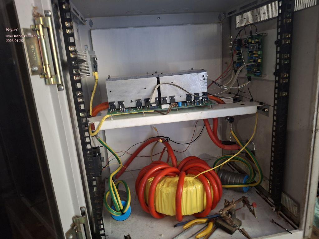

Posted: 07:21am 25 Jan 2026
Well as it cooled down had a day in the shed and this inverter is 95% done
Now call this timing from Poida or what as I do still need to wire up VFB and didn't even think about the stepdown transformer so I am glad this came out
Now a few years I did get a stepdown transformer and it's sat on my computer desk in the house for years but should fit the bill
Found some 3mm long threaded bolts and the nuts to suit but the thread isn't 3mm more likely a BA size. so with some 6mm perspex mounted to the din rail the lcd can be mounted.
So just got the AC side to sort out, VFB and the on/off switch. Also still got to tension all the bolts and insulate them with that yellow tape.
ON talking with Roger about charging the caps before turn on I do have 3 40 watt 200 ohm resistors
So by wiring them in parallel got the ohm's down to around 60 off memory which will limit the inrush current to 300mA which should suit the task I did solder the rear battery pads with some wires to bring the battery voltage for the 15 DC stepdown board so I'm thing take a rail off that to charge the caps from my shed battery and when the battery voltage is reached connect the anderson connector and turn the inverter on.

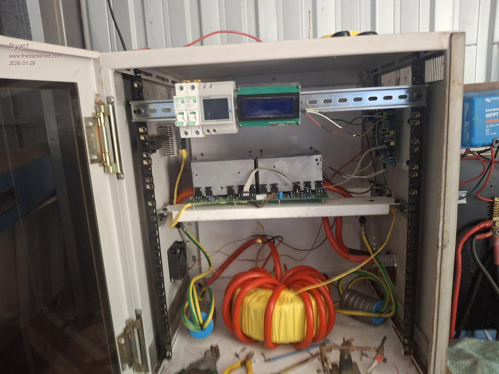

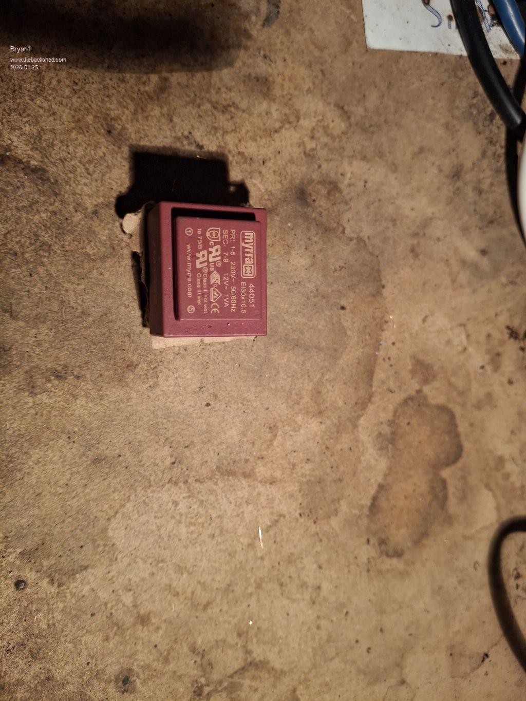

Well got a couple of hours before it heats up today and got the datasheet for that myrra transformer
Now off memory the grey cells are starting to return and on the AC output shouldn't 5uf be put across the output ?
I do need to make up a pcb for the transformer which can also mount the AC output via those 4mm pcb ones I have here and that 5uf cap once I find one can go on the board too.
So it got to 47C in my shed today and all I'm missing is that 5uf capacitor now if I may ask Roger as he has helped in this build to come over and have a look at my work so we can start this inverter and just let it go for many years.
The only thing I need to change to goto 48 volts is the 15 volt step down converter to suit 48 volts but at 5K for a 24 volt 1,000AH hour battery one will do for now.
Now this inverter will power my shearing shed so I can finally get over the line to distilling  and making a product every likes

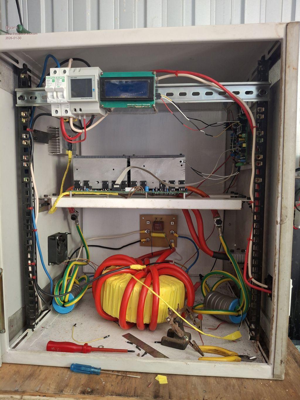

Well working on the inverter last night I did notice I had the Anderson connector upside down and I am glad I found it, anyway turning it around and clamping it back didn't take long.
So got onto finishing the AC board and got mounted then got onto the AC wires and for the wire just stripped a couple of metres of 3 phase 32 amp wire I had here and with one lead from the toroid it went thru the hole of this energy meter then back to the AC board.
A few little jobs left like make the wires for the VFB connection and fix the temp sensor wire on the toroid as it did pull out when I was tensioning the connections. Also got the earth to sort out.
So tomorrow will be the big day to see if my hard work has paid off

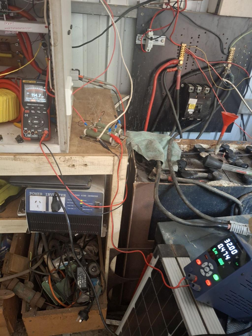

Bryan1
Joined: 22/02/2006
Posts: 2297
Posted: 05:49am 08 Feb 2026
Well tried those 200 watt resistors and found the 30 volt 3 amp supply was only drawing 70mA so tried with just the power supply and got an over current condition straight away so turned it off.
I have found the resistors are getting nice and warm yet the voltage on the inverter is only 33-35mV and rising very slowly so I do think these old resistors are breaking down so now looking for another solution.
Edited 2026-02-08 15:50 by Bryan1
Posts: 3412
Posted: 06:25am 08 Feb 2026
If the resistors are in parallel it is unlikely they are all breaking down at such a low voltage. Check their resistance before and immediately after a test.
  KeepIS said   check FET heat as you go.
  Quote  I have found the resistors are getting nice and warm yet the voltage on the inverter is only 33-35mV and rising very slowly
That looks like a short in the inverter or some high side and low side FETs are on, with the resistance rising as the short or FETs heat up.
KeepIS
Joined: 13/10/2014
Posts: 2282
Posted: 06:31am 08 Feb 2026
I assume that the 3 resistors are in parallel, the current you measure as the caps charge will be low, except for the first second which might go to a max of 500mA.
If still low after around 10 seconds then Phil is right, or you have a short somewhere.
When you tried the power supply by itself, did you very slowly raise the voltage, a current limited supply will immediately trip over-current if it is placed across the cap bank while there is voltage on the power supply terminals.
What happens if you turn it down to zero (assuming it's adjustable) and then very slowly bring it up.
FYI: Those resistors look fine to me, if they measure roughly 200ohm then they are fine, I have some from the stone age, all perfect if not damaged or open circuit.

Bryan1
Joined: 22/02/2006
Posts: 2297
Posted: 06:42am 08 Feb 2026
Ok they do say a picture is a 1,000 words
Now the fets aren't heating up at all but the resistor bank is around 75C
The DMM is connected to the Anderson connector and the input power is coming from the back pads on the under side of the board.
Now just turned it off and decided to put the DMM on resistance and sure enough I do have a short so got some investigations to do to find out where it is.
Now I do wonder if it is the fets as no isolation was done and the fets just went straight onto the heatsinks.
O'well all a learning curve and it does pay to crawl before walking
Edited 2026-02-08 17:00 by Bryan1
Posts: 3412
Posted: 07:05am 08 Feb 2026
32V / 0.474A = 57.5Ω
57.5 * 3 = 172.5Ω per resistor, so they are not the problem.
Bryan1
Joined: 22/02/2006
Posts: 2297
Posted: 07:19am 08 Feb 2026
I did do a continuity test between the fet legs and the Anderson connector and both fet legs show the short so more investigation tomorrow when I take the board out.

Bryan1
Joined: 22/02/2006
Posts: 2297
Posted: 07:39am 08 Feb 2026
Phill there are 6 off 10,000uf 63 volt caps on the board between the heatsinks so no way of taking them off unless each are desoldered.
Tomorrow I will take the heatsink off and see if that is the issue and have a real good look to see if there is anything causing the short.
KeepIS
Joined: 13/10/2014
Posts: 2282
Posted: 09:11am 08 Feb 2026
  Quote  now I do wonder if it is the fets as no isolation was done and the fets just went straight onto the heatsinks.
From memory, if the two short "split heat sinks" mounted on one side of the board are isolated, IE no phyical/electrical connection between the heat sinks, then you can mount the FETS directly to the Heatsinks.
This should be fairly easy to check and diagnose.
