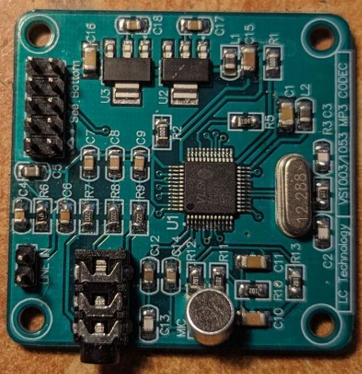

V5.07.08RC15
Full support for VS1053 sound.
This version has full support for the VS1053 sound chip as a (much better) alternative to the PWM sound or the MCP4822 DAC (no filters needed just an SPI connection to the PicoMite). It is available on all versions and the chip packaged onto a module is cheap and widely available.
To enable the VS1053 use
OPTION AUDIO VS1053 SPICLKpin, SPIMOSIpin, SPIMISOpin, CSpin, DCSpin, DREQpin, RESETpin
Note that like the MCP4822 the VS1053 uses a separate SPI port from that specified by OPTION SYSTEM SPI. A dedicated SPI channel is essential to allow it to be used in a H/W interrupt routine.
What is the VS1053 and why is it so good?
The VS1053 can decode a wide variety of audio formats such as MP3, AAC, Ogg Vorbis, WMA, MIDI, FLAC, WAV (PCM and ADPCM). There's also a special MIDI mode that you can boot the chip into that will read execute realtime MIDI data. It has a high-quality on-chip stereo DAC with no phase error between channels and stereo earphone driver capable of driving a 30 Ω load direct.
I've integrated the VS1053 so that nearly all existing audio commands will work through it: FLAC playback, WAV file playback, MOD file playback but in addition it can also provide superb MP3 audio, playback MIDI files and also provide a real-time MIDI interface. In the case of FLAC, MP3, MIDI, and WAV files, all files in a directory can be played with a single command and PLAY NEXT and PLAY PREVIOUS can step forwards and backwards through the playlist.
Finally I've implemented a MP3 STREAM capability allowing the WebMite to provide internet radio  capability with half a dozen simple commands.
So once the VS1053 is enabled with the permanent option command you can do the following:
PLAY FLAC fname$ [,interrupt] or PLAY FLAC dirname$
PLAY MP3 fname$ [,interrupt] or PLAY MP3 dirname$
PLAY WAV fname$ [,interrupt] or PLAY WAV dirname$
PLAY MIDIFILE fname$ [,interrupt]  or PLAY MIDIFILE dirname$
PLAY MODFILE fname$ [,interrupt]
To enter realtime MIDI mode use:
PLAY MIDI
then you can use
PLAY NOTE ON channel, note, velocity
PLAY NOTE OFF channel, note [,velocity]
PLAY MIDI TEST n (n=0 to 3, 0 = normal realtime, the others play note and instrument samples)
PLAY MIDI CMD cmd%, data1% [,data2%] (used for setting instruments to channels etc.)
Finally, you can use:
PLAY STREAM buffer%(), readpointer%, writepointer%
This plays anything in the circular buffer and will continuously output if the write pointer is updated. This is specifically designed for use with the Webmite but could also be used to output any WAV pattern from MMBasic by first writing into the buffer a 44-byte WAV header.
See this thread and this one for more information and history of the development.
