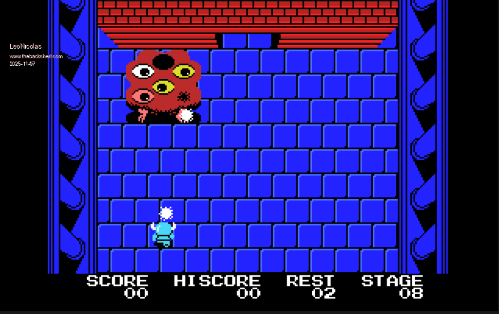

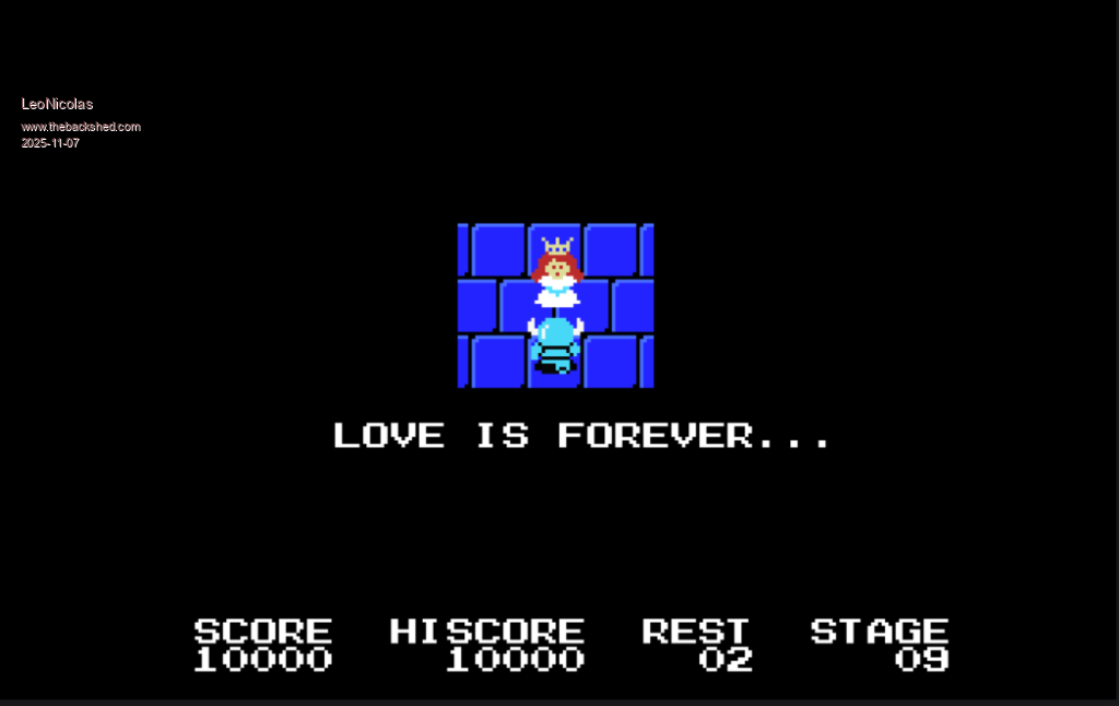

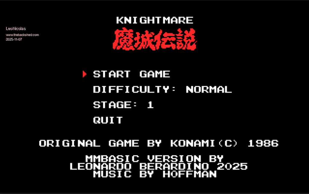

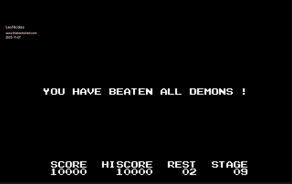

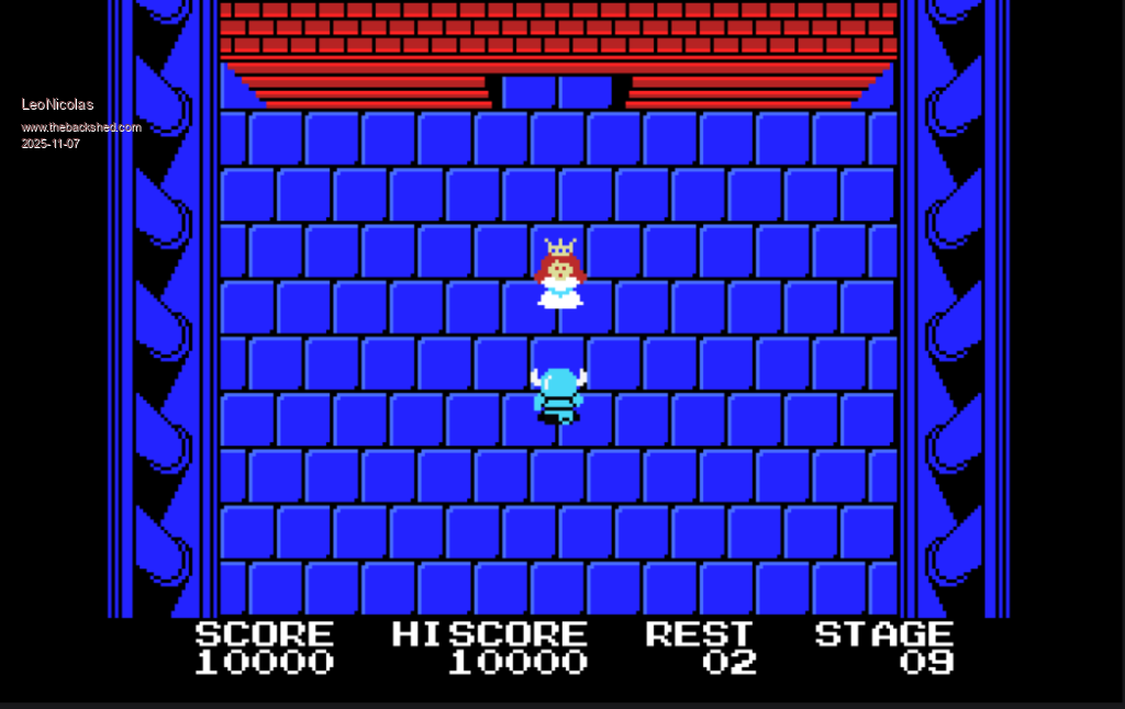

Hello everyone
I have finished the stage 8, the final cut scene, and I fixed a ton of bugs.
Now the game has beautiful high quality songs written by H0ffman (Thank you man!).
There are some minor fixes I need to work on, but I think the game is playable until the end. The easy mode decreases the enemies fire rate and the bosses life in 50%.
Please report any bugs to me.
I'm preparing myself for a new game port in MMBasic
Some tips:
- There are weapons more powerful than others, and if you pick up the same weapon twice, it will be stronger
- Try to get the Speed up power up multiple times. Each one will increase a little your speed
- The shield is an essential power up
- There are lives inside some ? boxes and there are invisible boxes. You need to shoot them to reveal
- There are some variables you can play with on the km.bas file, line 43
