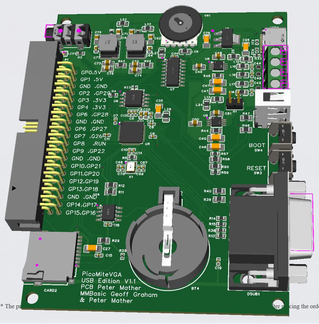

I flashed all 5 PCBs. All come up with the flashing red led, but one of them says "USB malfunctioned" (or words to that effect. The other 4 all worked through setting of options and CLS RGB(red).
I've reflashed the non-working one 5 times, including with the erase.uf2 file. No errors are reported, the red LED flashes as per normal, but no USB COMM port is available.
Anything else I should try on that one?

I would guess that it would have to be something associated with the USB-C connector or the CH340C and components nearby.
Check for solder shorts or missed solder connections.

Agreed, it can only be 4 components or the wiring between them: USB-C connector, CH340, R31 or R32

They are but it is irrelevant. If I understand your issue correctly the board isn't registering the USB port with your computer? The CH340 should do this even with no firmware in the RP2040. Of course it wouldn't respond but you could short pins 2 and 3 on the ch340 with a screwdriver then should should get an echo on teraterm for anything you type.
Until this works the Pico is irrelevant.
If you have a USB-C to USB-A adapter then you can buzz out the middle two pins to pins 5 and 6 on the ch340. You should see 2 or 3 ohms on the correct pairs

The board isn't registering the USB port with the USB_C port connected to the PC (as it successfully did with the other 4 boards). When connecting USB_A to USB_A, I could copy the uf2 firmware as with the others--apparently successfully, since the red LED is flashing once a second.

Ok, with the board powered through the USB_A to USB_A connector, with GP8 & GP9 and GND going to a USB-TTL module, I have console.

OK so you have narrowed it down completely to the CH340 circuit and you know that GP8 and GP9 aren't compromised. You should see the uart signals from your USB-TTL module on pins 2 and 3 of the CH340?
Check the power to the CH340  - Gnd on pin 1, 3.3 on pins 4 and 16.
If that is OK the personally what I would do is swap a ch340 from a known good board but only if you are confident in soldering the SOP chip

It is possible that incorrect values have been soldered onto the board.
Check R36 & R37 are both 27R.
And check R31, R32 are 5k1 and R33 is 1M.
On the CH340 check you have 3v3 across Pins 1 and 16.
Looking into the USB-C connector do the pins look OK (compare to the others).

Hmmm, R31, R32, and R33 have the values you say on a working PCB, but on the non-working one, R32 and F33 are correct, but R31 is 2k8. I'm not sure I have the skill to replace that.
  matherp said  Check the power to the CH340  - Gnd on pin 1, 3.3 on pins 4 and 16.
Power seems good from the USB_C socket--the board boots up and console is available on GP8 and GP9. I don't have the ability to swap the CH340--I'd probably end up with 2 bad boards.

That ‘could’ be your problem as the different resistor value would report an incorrect device to the PC (or charge capability).
Removing  the resistor isn’t that difficult, add more solder to both sides and hit both ends with a HOT soldering iron and it will move easilly.
To solder a new SMD clean the pads with solder wick so they are as clean as possible,
put a small blob (not too much) of solder on ONE pad
Use tweezers and place the new resistor over the pads and hit the end with the blob, it should hold
Then properly solder the other end, then redo the first end.
If you are really unsure about soldering the SMD use a standard 5k1 resistor and identify the pad that is going to the connector (the non GND one) and solder one leg of the standard resistor to it and the other end to a suitable GND point. It may be best to solder the GND leg first to not put too much stress on the tiny SMD pad.

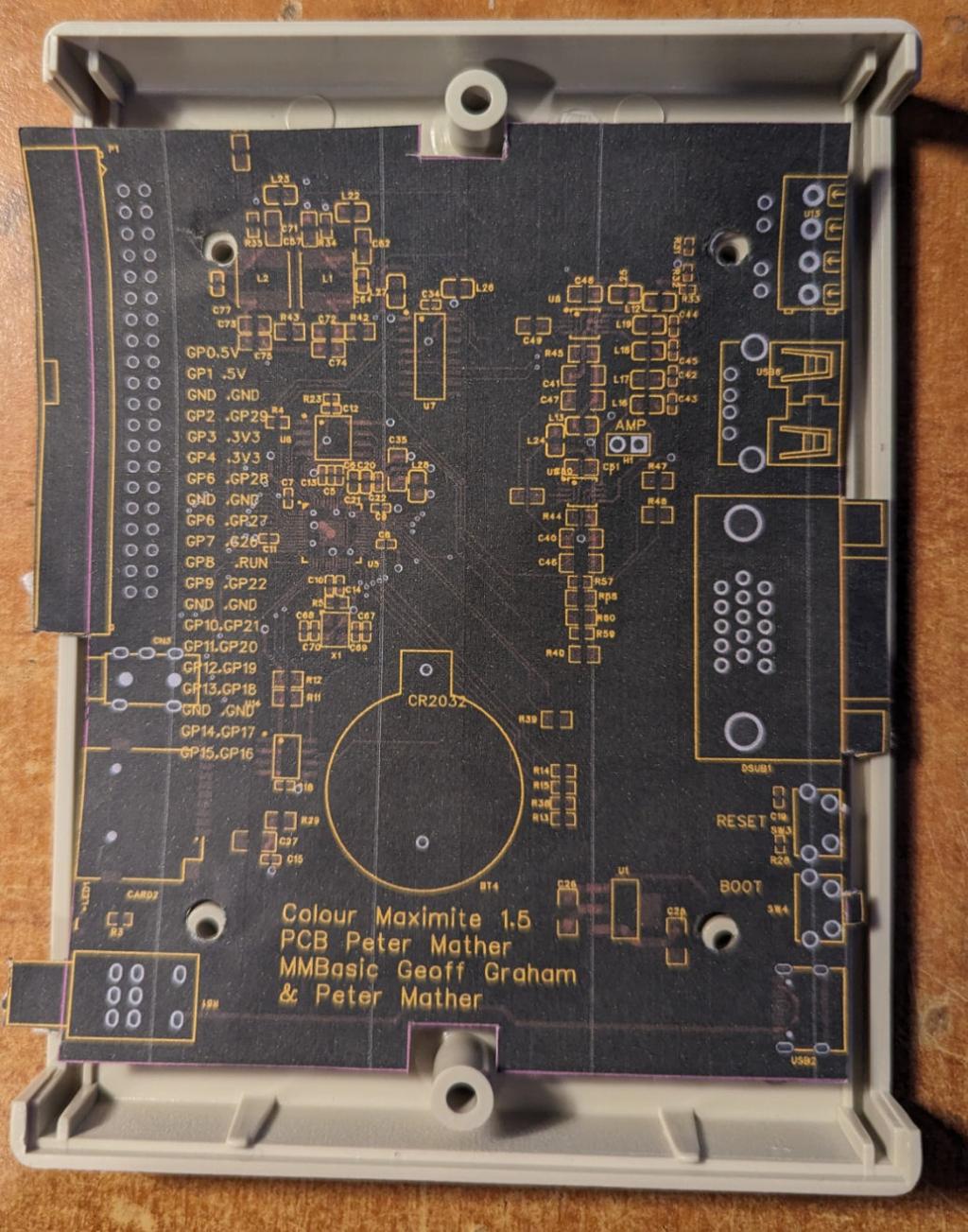

I've found a nice box for the Colour Maximite 1.5.
MULTICOMP MCRM2015S CASE, DESKTOP, ABS, 30X130X100MM
Just need to spread out the components on the PCB a bit to reach the edges. Unfortunately to get everything along the two edges the length is 110mm and the width to fit the box is 90mm

Move the audio volume potmeter to the other side of the 40pin header.
