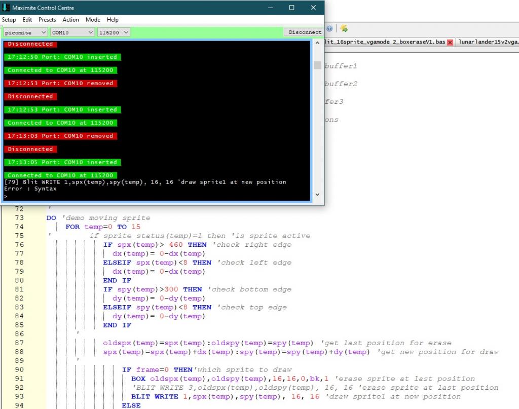

Can I ask here or new thread?
I tried an existing prog for ili9488... it's 480x320 so must be and blit write now gives syntax error using picomite usb. There was mention of sprite instead of blit working in betas but all too dynamic to keep up to date.
The ili9488 did work with this on a final release.
it's picomite rc3 usb
Edited 2024-04-14 02:54 by stanleyella
Posts: 11830
Posted: 05:05pm 13 Apr 2024
blit write no longer takes a width and height parameter. This change was made ages ago.
The command spec in the 5.08 manual is correct but the description needs updating by removing the italicized sentences.

Posts: 2807
Posted: 05:22pm 13 Apr 2024
Thank you Peter sir, it compiled without height,width but just white squares not the sprites

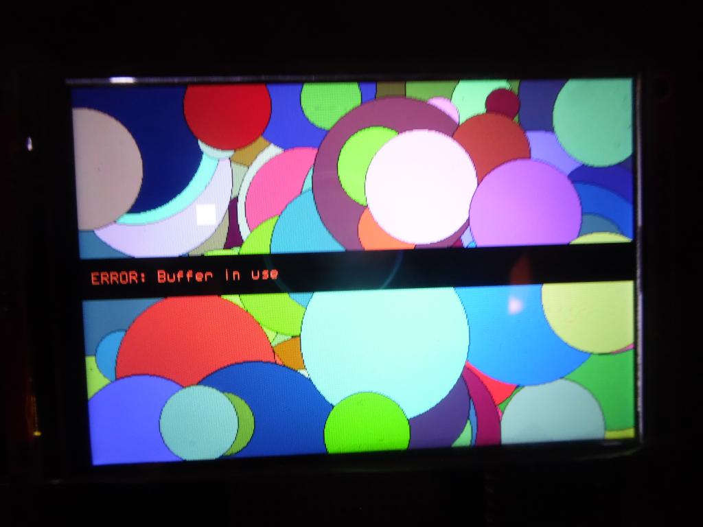

Posts: 11830
Posted: 06:08pm 13 Apr 2024
You need to get the 64 64 64 test working. It does work on RC3 if your H/W is correct. Are you using the IPS ILI9488?
Here is a simple way to test
GUI TEST LCDPANEL
let it run for a few seconds then Ctrl-C. You should now have a colourful screen
BLIT READ 1,0,0,100,100
BLIT WRITE 1,100,100
The data from 0,0 to 100,100 should now be replicated at 100,100 to 200,200
Until this works you have a H/W problem

Posts: 2807
Posted: 07:28pm 13 Apr 2024
gui test lcdpanel
Error : Buffer in use

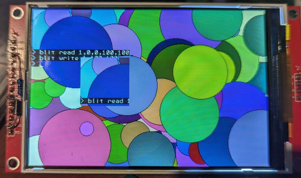

Posts: 2807
Posted: 08:40pm 13 Apr 2024
> blit close 1
> blit read 1,0,0,100,100
> blit write 1,100,100
a white box :(

Posts: 11830
Posted: 09:19pm 13 Apr 2024
White box means the code is reading zeroes. Because the IPS version has the colours inverted this will display as white. I guarantee this works fine on RC3 with a correctly wired ILI9488 IPS display
Posts: 3376
Posted: 09:32pm 13 Apr 2024
As Peter said it is a hardware issue with the 4" IPS panel. If the SD pins are connected to System SPI you must remove R8 (near the SD socket). Also make sure the panel voltage is 3.3V. Either by powering it from 3.3V or adding the 3.3V regulator and removing R0.
This is fully described in the previous few pages.
Footnote added 2024-04-17 09:17 by phil99
  Quote  A possible alternative to removing R8 may be to reduce the 10kΩ to 1kΩ - 1.5kΩ to override it. Untested, may be too low for some SD cards.
Now tested. All the SD cards I have are happy with this so I suggest leaving R8 in place and using 1.5kΩ or 1.8kΩ for the LCD_CS to MISO resistor and using any diode with a junction capacitance of more than 22pF. Eg 1N400x or 1N581x series.
Posts: 3376
Posted: 09:47pm 13 Apr 2024
  Quote   capacitance is what matters most.
Revived the original 680Ω idea, but changed to 10kΩ in parallel with 100pF from LCD_DO to MISO.
> for a=0to 2:b=0:for c=0to 255:d=c<<a*8:pixel 9,9,d:if d=pixel(9,9)then:inc b:endif:next:?b:next
64
64
64
Stan's Blit test works too.
(no diode or resistor to LCD_CS)
Edited 2024-04-14 07:58 by phil99
