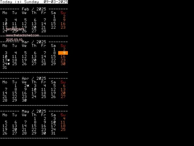

Posted: 05:29pm 09 Mar 2025
Hi Vadim,
this is version 0.20 of the test version.
fm02000.zip
New: the option to sort selected files together at the beginning of the file list with "<". I have set the maximum number of files that can be displayed in a directory back to 200 (previously 300). However, everyone can adjust this themselves (RMax=).
A calendar (cldr.bas) is included in the package. The program displays 4 months and has an integrated appointment display.
Another note on the selection with wildcards. For example, selections such as "*[0-3]*.bas" are also possible to select all ".bas" files that have a 0, 1, 2 or 3 in the name. RegEx makes it happen.
Kind regards

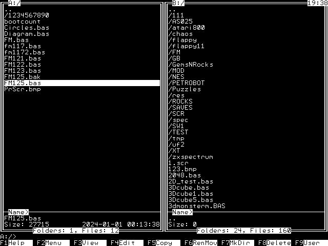

javavi
Joined: 01/10/2023
Location: Ukraine
Posts: 603
Posted: 05:55pm 09 Mar 2025
FM v1.3 for PicoMiteVGA/HDMI
The original code has been refactored. I brought some order to it.
- File sorting for panels has been added.
- The file renaming function has been moved to F6
- Now F2 calls up a menu of built-in subroutines that can be developed (I made a couple of examples).
- The F9 button now has a user menu of commands that the user can add to the program at the beginning.
(commands executed in the program and commands executed in the command line, including options).
- The user can also type any command while in the File Manager and it will be executed.
FM13.zip
I haven't gotten around to copying and moving entire directories, multiple file selections yet, I think I'll do that next.
I'll take a look at how @twofingers does it, Thanks to him.
I propose to develop this version of the file manager.
Suggest ideas for the built-in routines menu.
Write your own examples of such routines.
Thank you all for your attention!
I'm still alive, the fight continues!
Glory to the heroes!
Edited 2025-03-10 04:33 by javavi

This is a screen shot of the calendar program (cldr.bas):
And this is a small update (v081):
cldr.zip
Edited 2025-03-10 08:22 by twofingers

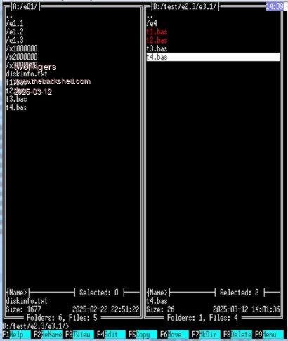

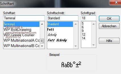

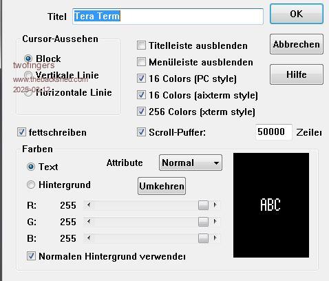

twofingers
Joined: 02/06/2014
Posts: 1769
Posted: 01:53pm 12 Mar 2025
Hi Vadim,
I've created a VT100 demo version of my trial version. The fundamental functions are working. But there is still a lot to do!
I wanted to check if there were any fundamental issues with the implementation.
That doesn't seem to be the case.
fm-VT100 (V0.2011).zip
The important thing to remember is the settings in the Terminal program: the screen display must be white on a black background, and the font should be "Terminal."
Best wishes to Ukraine!
Michael

twofingers
Joined: 02/06/2014
Posts: 1769
Posted: 03:16pm 12 Mar 2025
Hi Harm,
I'm surprised you're getting error messages; I don't (Pico 2 on Peter's reference design). You can certainly delete "Mode 1" yourself. I don't get the error message. But what you're saying is interesting.
I've also left all the HDMI/VGA-specific commands (Color, Tiles, etc.) in this test version because they might help with further processing. Of course, they make as little sense as "Load image" and "save image."
I can't say if and when I'll continue working on this version.
But I think it can be useful — as long as you don't get any error messages!
