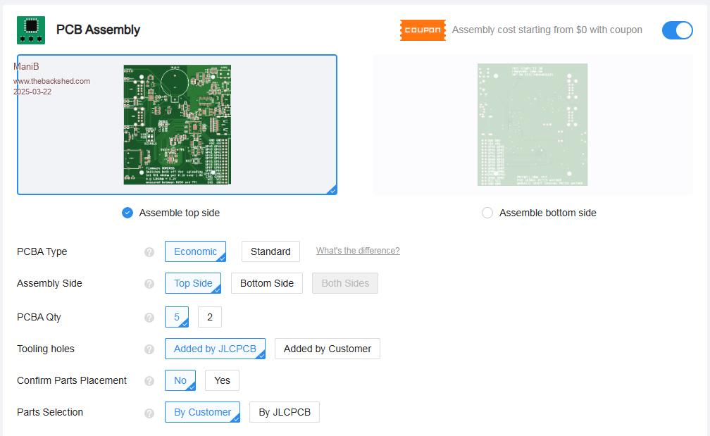

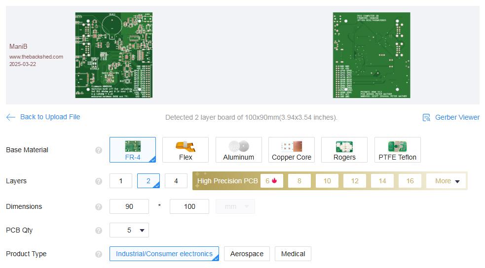

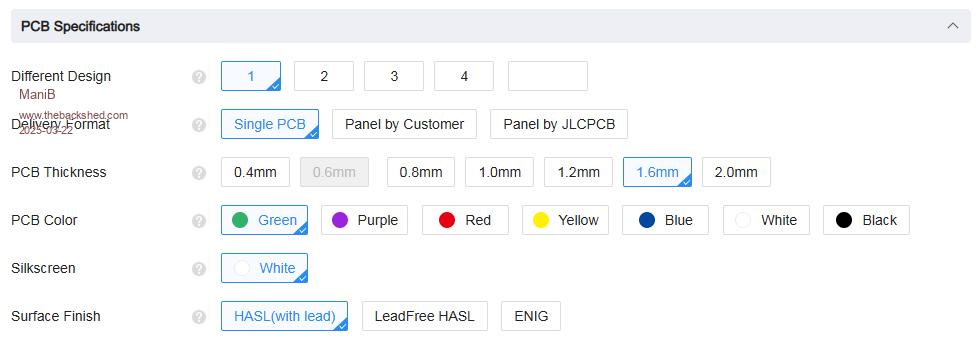

Hello Peter, many thanks for your great work.
As already announced, I would now place my first order at https://jlcpcb.com/. I have uploaded the zip file of the Gerber files and adopted these settings.
Is that OK so far?
Posts: 11826
Posted: 07:56pm 21 Mar 2025
I just accept all the defaults so if you have done the same you will be fine. Of course you can change colour if you want - just slows delivery by a couple of days

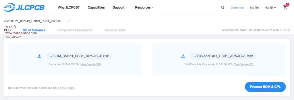

OK, then it's actually very simple. Do I also have to upload the BOM and P&P files?
And what about the DXF files for end-plates for the box? Should I order them at the same time? Or is that not important at first?

Posted: 08:24pm 21 Mar 2025
  ManiB said
  matherp said  I just accept all the defaults so if you have done the same you will be fine. Of course you can change colour if you want - just slows delivery by a couple of days
In the order process you will be asked for those files. The frontpanels are another order you have to place.

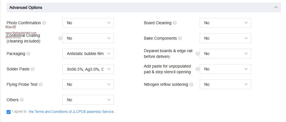

Ok, the question about the BOM and P&P has been answered.

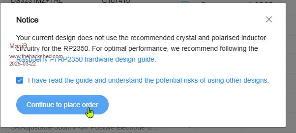

This warning came up, which I ignored:
I now have that in my shopping basket. Do I have everything I need to order?

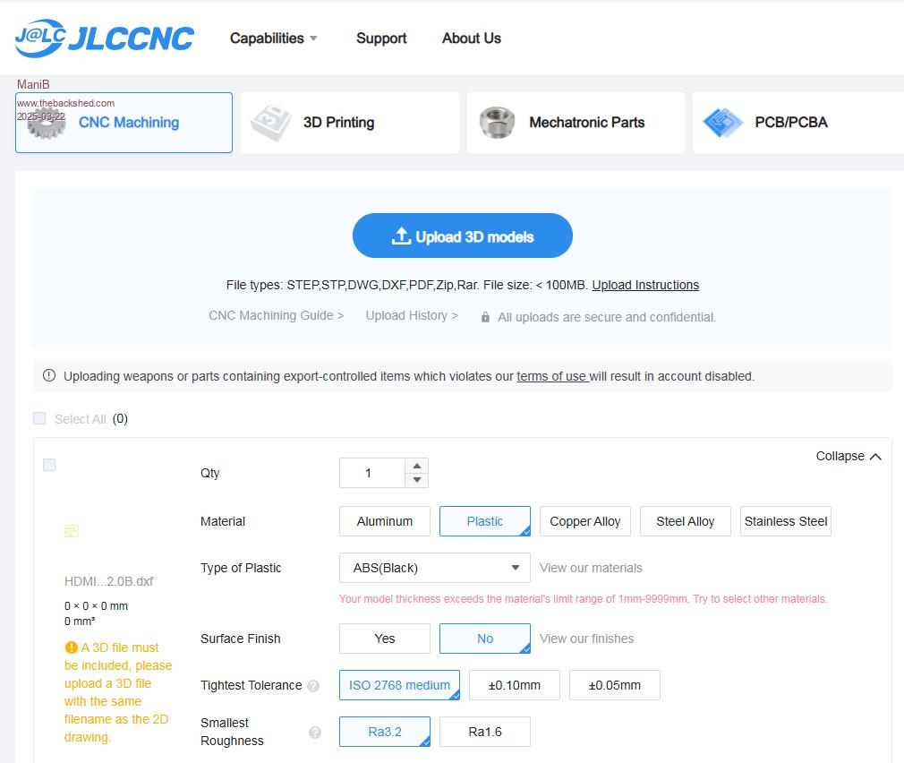

How do I order the DXF files for end panels for the box?
Is this done via ‘CNC Machining’ or ‘3D Printing’?

Posted: 09:21pm 21 Mar 2025
I have tried this with CNC Machining, but after uploading the .dxf file I get this message:

ManiB
The dxf files are only the bare outlines of the panels. CNC Machining is the wrong thing to do...
Personally I would import them into EasyEDA and add some markings like text and so on... After that you can save it as an PCB and order it like a normal PCB.
German Translation:
Hallo ManiB, du kannst das schon theoretisch als CNC machen, würde ich aber lassen. Das sind einfach nur die normalen Formen ohne jedwede Beschriftung! Sie sind dafür gedacht z. B. in EasyEDA importiert zu werden, dann kannst du sie als Platine abspeichern und ganz normal ordern via JLC. Ich vermute mal du hast EasyEDA noch nie benutzt, lass mich wissen, wenn ich dir das fertig machen soll als Datei... Aber so ist die dxf-Datei nur eine reine "Form-Datei" ohne irgendwas.. Keine Beschriftung und nix.. Das sieht nicht gerade gut aus.

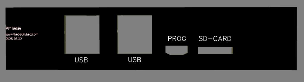

Amnesie
Joined: 30/06/2020
Posts: 763

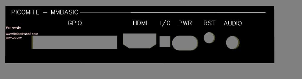

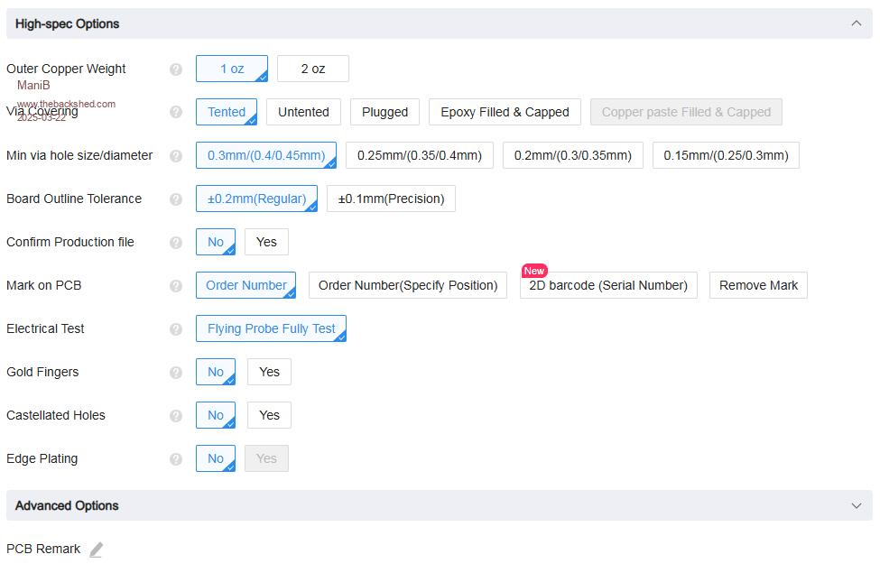

Posted: 11:09pm 21 Mar 2025
I created some panels as PCB from peters DXF...
Gerbers: (just order as normal PCB and IMPORTANT!! write in JLCPCB additional notes, that it is OK that there are no tracks, it is intended as panel only)... Without this additional note they often ask, if this is right... And you must select:
Mark on PCB Order Number(Specify Position) This way the JLC order number is on the backside silkscreen.
Gerbers:
Gerber_panels_frontpanel_2025-03-22.zip
Gerber_panels_backpanel_2025-03-22.zip
Greetings
Daniel

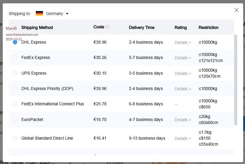

Posted: 11:58pm 21 Mar 2025

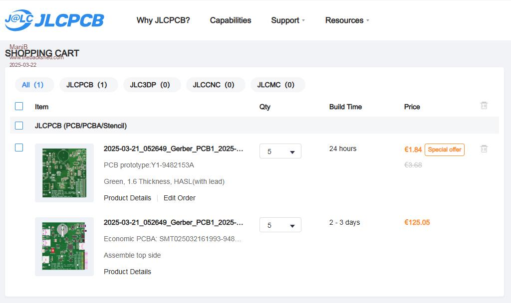

I have added front and back panels pcbs. Thanks Daniel.
Which shipping option should I choose?
