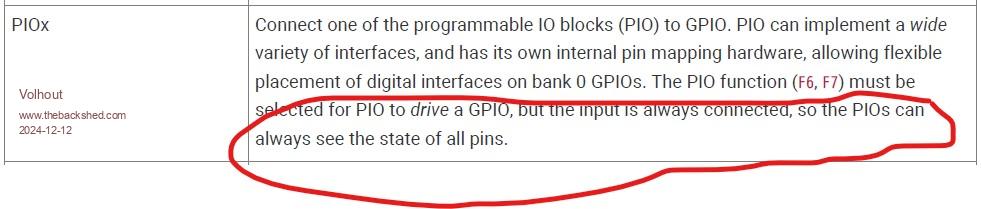

Posts: 6101
Posted: 08:55am 12 Dec 2024
@Peter,
In the last (2040 VGA RC6) version the logic analyzer DEMO mode does not work anymore.
Demo mode uses the PIO to sample input pins GP0..GP5 and uses PWM output at the same time on these pins.
For this purpose the pins are configured as PWM pins and NOT as PIO pins. PIO only reads the pins in the background.
That used to work, but not anymore.
I have confirmed that the PWM works on GPx pins. But PIO does not see these anymore.
In fact, the PIO cannot read any input signals anymore.
Not even when SETPIN GPx,PIO1 is performed.
This seriously invalidates PIO.

I'm confused. Are you physically wiring the PWM pins to the PIO inputs or are you assuming they can be read without wires?
Posts: 6101
Posted: 09:52am 12 Dec 2024
Hi Peter,
The logic analyzer (DEMO mode) outputs PWM signals at GP0,1,2,3,4,5 (3 PWM's,6channels) as demo signals.
In the background the PIO reads the pins GP0...GP5 and displays the signals on the logic analyzer screen.
That did work (just confirmed my Pico is not dead by running 5.09.00RC5).
But the essential problem now (RC6) is that even if I stop the PWM's, and configure the pins GP0..GP5 as PIO, or DIN, I cannot read anything in the PIO. PIO is disconnected from the input pins. Regardless SETPIN.
I remember that in 5.07.xx you made a fix that allows PIO to read pin status regardless  the SETPIN command. Maybe that feature got lost somewhere in the 6.00.01 series ? I remeber that I succesfully ran the logic analyzer in 6.00.00 series. MAy even be a toolchain issue ? Maybe in the pin direction/function register there is a bit that connects PIO directly to the pin, that got changed.
I use this function (PIO can read, MMBasic can control) a lot to start and stop PIO state machines. I.e. in the frequency counter on GP22. MMBasic is set for DOUT, where the state machine uses this as gate signal.
Edited 2024-12-12 19:56 by Volhout
Posts: 11830
Posted: 09:59am 12 Dec 2024
When pins are set as outputs (e.g. PWM) the input capability is turned off. Therefore PIO can't read them (logically except for your demo purposes there is no real reason why you should be able to).
If you set your PIO to read pin A and PWM on pin B and connect a wire between A and B it should work if A is set as an input (not PIO). I will make a change so that A can be set as an input OR PIO.
Posts: 6101
Posted: 10:09am 12 Dec 2024
Peter,
If I connect GPx to a 3.3V power supply, regardless of what I do, PIO does not see a high level in 6.00.01b6. It is always 0.
Regardless if I set pin to PIO1,DIN or whatever. PIO is deaf.
About the capability of PIO to read pins when MMBasic drives them...
- this functionality existed in 5.09.00
- it does not exist anymore
- this feature is also used in the PIO chapter in the user manual (EXAMPLE PROGRAM 3). In case this functionality is lost, I need to carefully check and adapt that section before it is published.
Edited 2024-12-12 20:15 by Volhout

Posts: 11830
Posted: 11:17am 12 Dec 2024
The example gives the same issue. GP2 is an output so it isn't an input and can't be read. The PIN function gets round this by reading the state of the output latch but the PIO is trying to read the input itself.
Again, if GP2 was being externally controlled in a real application the example would work.
You can demo this by setting GP2 as an input and then connecting it to GND or VCC in which case the code works
'disconnect ARM from GP0. - 1000Hz / 1500Hz Square Wave
SetPin gp0,pio1
'configure pio1
p=Pio(pinctrl 0,1,,,,gp0,)
e=Pio(execctrl gp2,0,31)
f=1000 * 6 'Hz
'line code comment
' 0   E081 SET GP0 output
' 1   E001      SET gp0 high
' 2   00C5      JMP (GP2=1) to 5, (skip instructions 3 & 4)
' 3   E001      SET gp0 high
' 4   E000      SET gp0 low
' 5   E000      SET gp0 low
' 6   0001      JMP to 1
'program pio1
PIO program line 1,0,&hE081
PIO program line 1,1,&hE001
PIO program line 1,2,&h00C5
PIO program line 1,3,&hE001
PIO program line 1,4,&hE000
PIO program line 1,5,&hE000
PIO program line 1,6,&h0001
'write the configuration (note we added "e")
PIO init machine 1,0,f,p,e,,0
'start the pio1 code
PIO start 1,0
'toggle GP2 in MMBasic
SetPin gp2,din
SetPin gp8,fin
' Pin(gp2) = Not Pin(gp2) 'toggle pin GP2
Print Pin(gp8)
Pause 2000
End
Posts: 6101
Posted: 11:32am 12 Dec 2024
  matherp said  The example gives the same issue. GP2 is an output so it isn't an input and can't be read.
This worked in 5.07,xx 5.08.00, 5.09.00, and not anymore. The RP2040 is capable. Something disables this function.
Maybe this is disabled in the new toolchain for compatibility to 2350.
I will ask Geoff remove the applicable section in the user manual for 6.00.01.
I will revert back to 5.09.00 since I need this function.
Thank you for your support. Sorry to be such a problem maker...
